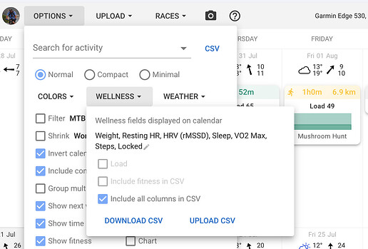

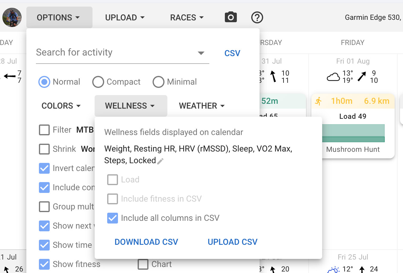

When downloading the CSV of the wellness data, does the exported CSV only include the fields you’ve selected to be visible in the calendar view?
Yes, that is correct.
If you want to download all data, but not display everything on the calendar, you can use Excel to get the data using the API. There’s an overview here.
We have added an option to include all possible columns in the downloaded CSV. This will be deployed Tuesday AM (GMT+2).
