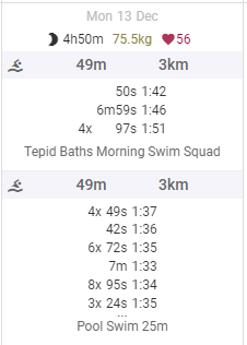

Still I have a little problem when it comes to synching my activites: I enabled uploads from Garmin and Strava (because Zwift workouts are not uploaded by Garmin) and it should delete any double sessions coming from Strava (in theory, right?), however that’s not the case, only for swims though. It’s even more confusing that some swims are only uploaded once, even though you can find them on both strava and garmin.

Please drop me a mail next time it happens but leave the duplicate swims as is. Tx.

I think I have fixed this. Tx for the info.
