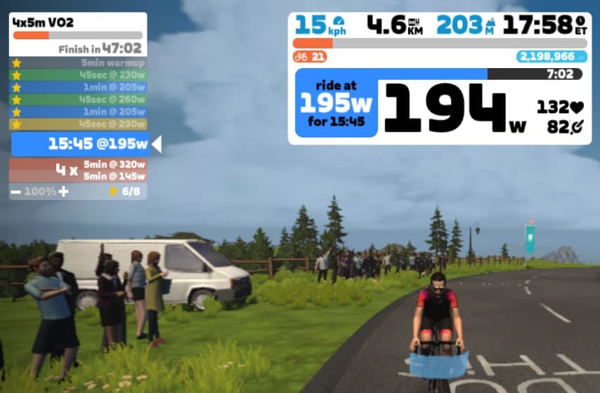

I would like to be able to have my intervals really as Zwift intervals
Actual
on Intervals.icu I set :
8x
  • 45s 360w
  • 45s 200w
but in Zwift, this is not converted as 8x the same intervals, it is converted as 16 periods of 45s, which is harder to follow and harder to update if we wnt to slightly change the values on Zwift.
Expected
8x
  • 45s 360w
  • 45s 200w
Should give real 8x intervals on Zwift, not 16 periods of 45’

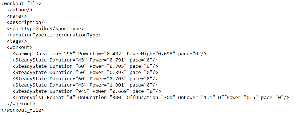

@david
The text for the ZWO file, to nest the micro intervals, that is generated in Zwift Workout editor is as follows:
edit: it doesn’t show the text when I paste as is.
This might help solve the nesting of intervals, at least for Zwift workouts.
I notice it doesn’t allow using a range of power, and is stuck on a fixed percentage. It’s fine if the workout is done in resistance/slope mode, as the user would have the target power as guide.

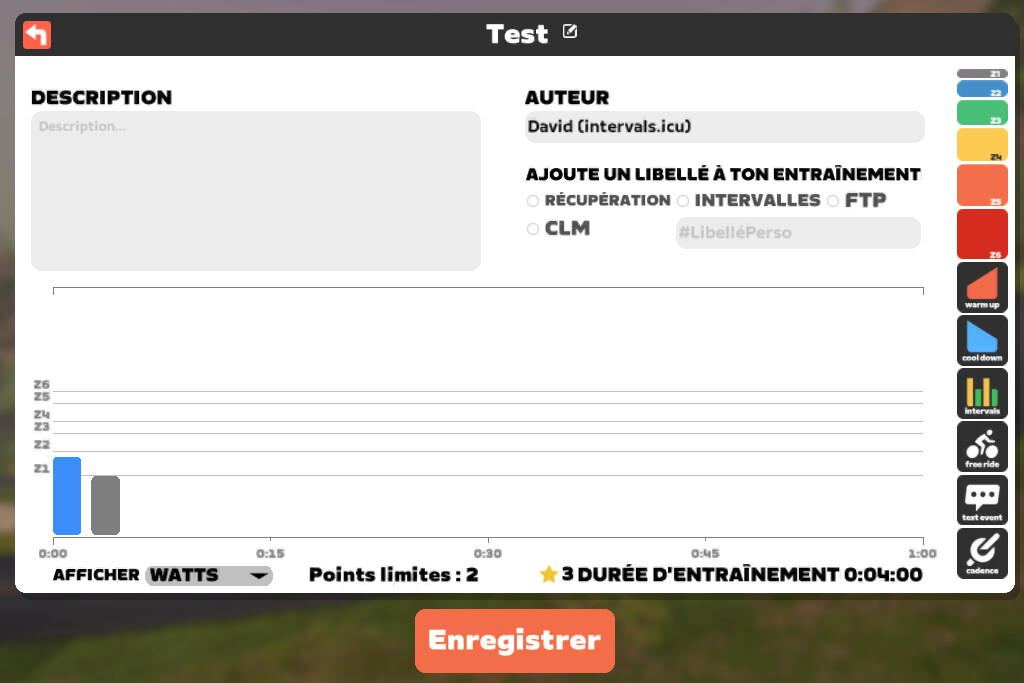

Hi @david you don’t need to have Zwift to test it, with the Zwift editor you can visualise your file : Zwift Workout Editor
Thank you @Gerald ,
The point is that Intervals.icu doesn’t generate intervals when you export the file
No <IntervalsT>.
That’s my feature request :wink:
(this works ! ^^)

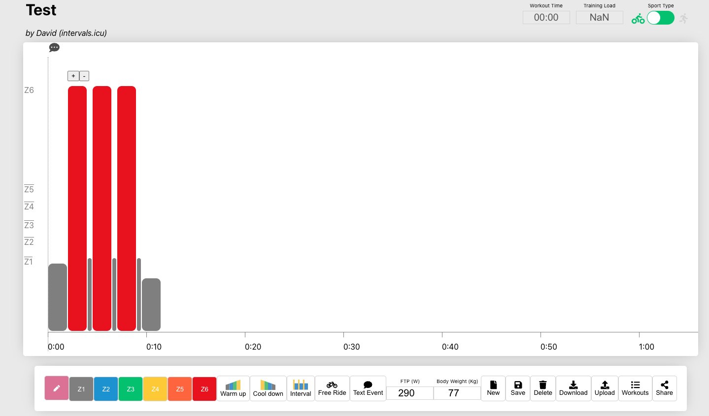

I just fixed an issue with that test file (forgot the “Repeat”) and have updated the post. I tried uploading it to the editor but that doesn’t work. It seems the editor doesn’t support “PowerOnHigh” etc…
Intervals.icu:
<IntervalsT PowerOnHigh="0.948" PowerOnLow="0.927" OffPower="0.6" Repeat="4" OffDuration="30" OnDuration="120">
    <textevent message="Go"/>
</IntervalsT>
Download from the editor after upload:
<IntervalsT Repeat="4" OnDuration="120" OffDuration="30" OnPower="NaN" OffPower="0.6" pace="0" CadenceResting="NaN"/>
So I am not sure this will work on Zwift.

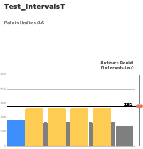

Ok i’ll test it on Zwift directly.
Not yet …
I will generate in Zwift your example and give you the file
test_intervals.icu.zwo (457 Bytes)
It seems that the file looks like the one you dowloaded from the Zwift Editor. Only
<IntervalsT Repeat="4" OnDuration="120" OffDuration="30" OnPower="0.94449997" OffPower="0.6045" pace="0"/>
and ranges are not available on Zwift : PowerOnHigh="0.948" PowerOnLow="0.927"
(Personally I prefer to use the watts directly than the % of FTP.)

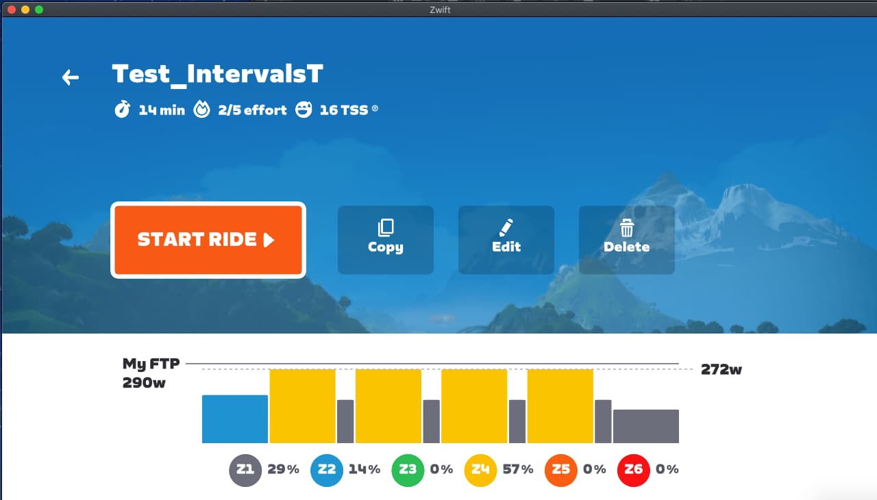

The code will now use IntervalsT if there are 2 steps in the repeat and the both specify exact power (i.e. not a range).
Yes, that’s correct !
Treated as intervals by Zwift !
Great work, Thanks !
Both workouts (1 and 3) worked fine for me when downloading from here and uploading to the Zwift workout folder.
