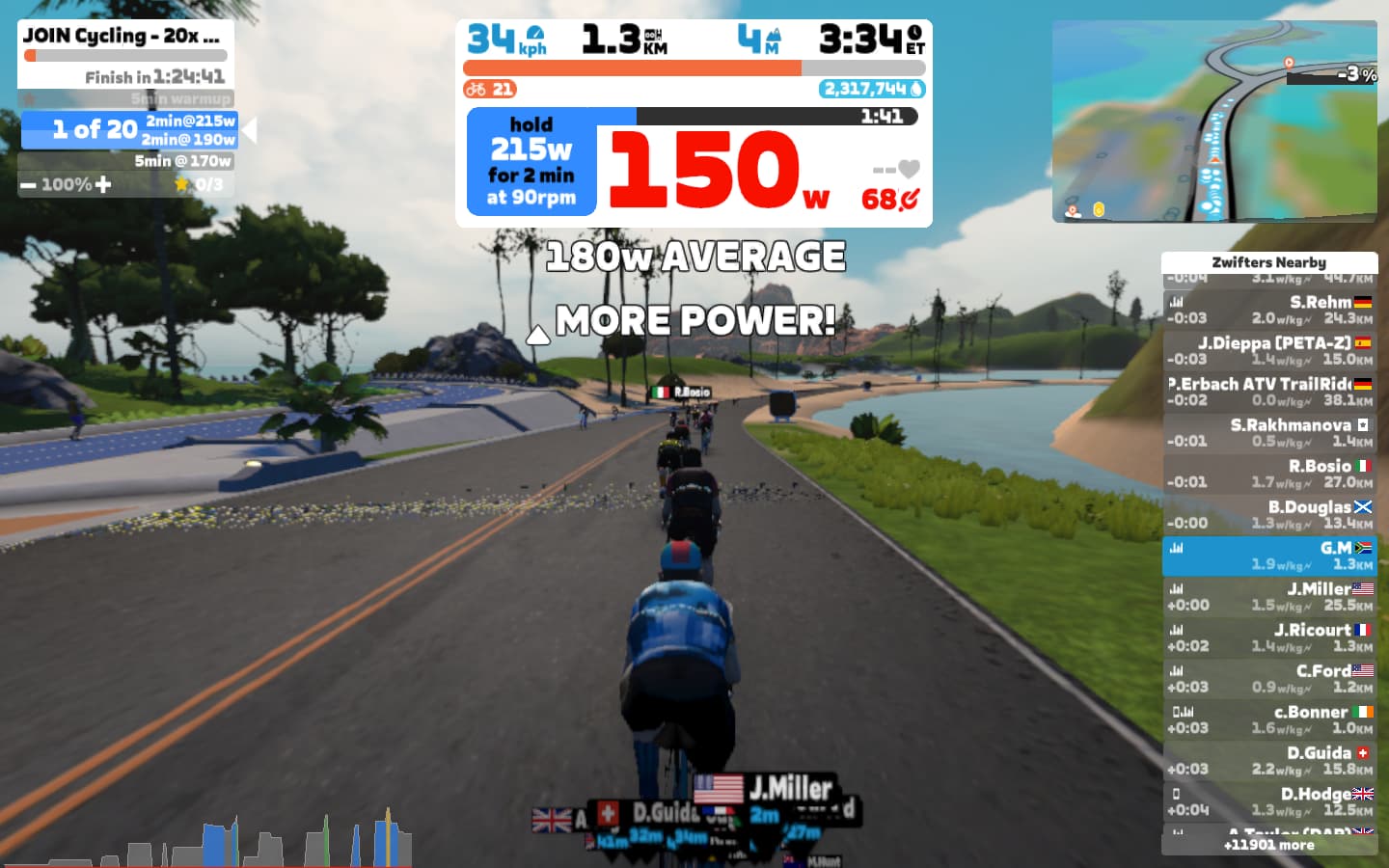

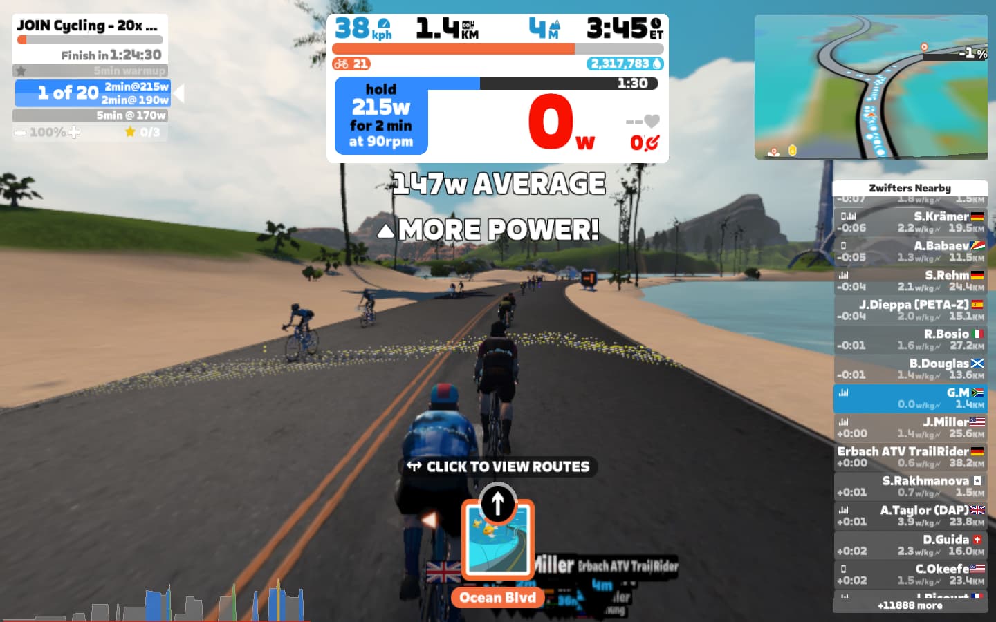

The text to use for average power is show_avg=“1” , and needs to be added after each line where there’s a lap/interval, as shown in the bug report above from @SkayKand
Hmm .. according to this site show_avg is not supported for IntervalsT: zwift-workout-file-reference/zwift_workout_file_tag_reference.md at master · h4l/zwift-workout-file-reference · GitHub
Would you or @Momiar mind testing this file? I have manually added show_avg.
JOIN_Cycling_20x_2_min_intensive_endurance_intervals.zwo (835 Bytes)
It works for me.
Warmup doesn’t show it, but the average power shows on the intervals.
Thanks for testing. IntervalsT elements now get show_avg=1. If you don’t want this add the “hidepower” flag to the first step in the set:

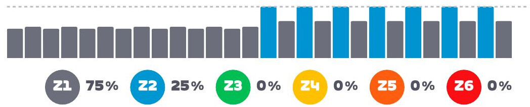

Warmup
-5m 50%
2x
-10m 40%
-10m 40%
2x
-10m 45%
-10m 40%
2x
-10m 50%
-10m 40%
2x
-10m 55%
-10m 40%
2x
-10m 60%
-10m 40%
5x
-5m 80%
-2m 40%
IntervalsT seems to only be triggered once the interval target is at > 45% (i only did try 5% increments) and I noted yours shows 43%

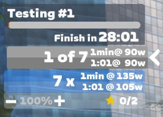

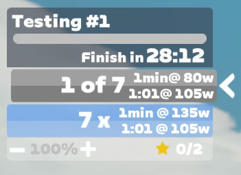

I tested the specific sample you provided first:
It works fine - however there is a well-known issue with custom workouts in Zwift - they have their power rounded to nearest value, divisible by 5 - so your sample with 43% and 45% ended up the same W:
I changed this to be 39% and 51% so you can see that it is still fine:
But good thing is - when Zwift integrated TrainerRoad, they were “forced” to fix this issue, but only for workouts passed via API - so here is a sample of actual recovery workout I used today which was pushed from Intervals calendar:
So - if you can remove this restriction and allow for IntervalsT to be generated from any pair - that would be great!

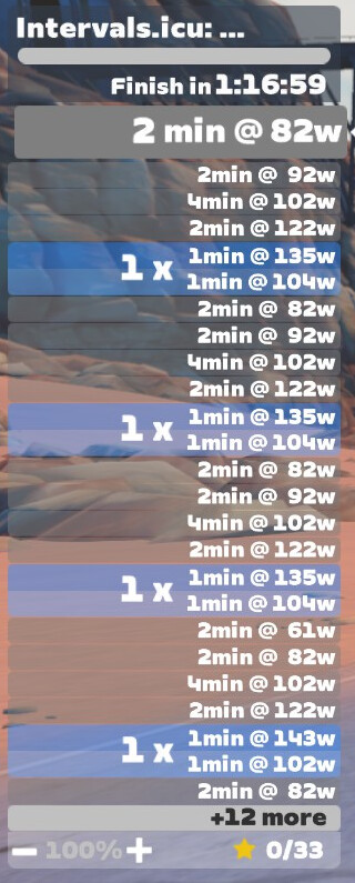

Intervals.icu workouts in zwift no longer show average power @david?
Will it only work if you export it as a zwo file and then copy it in? I use the automatic upload.
