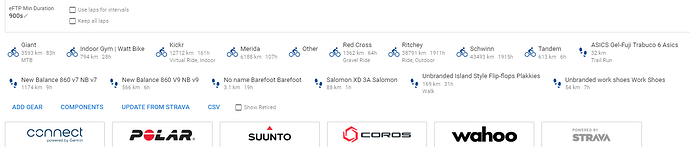

Look at your bikes (in gear, on settings page, just below power and HR settings).
Look to see what your moving/elapsed duration is and the distance covered for the default gear used for indoor/outdoor.
I don’t use distance in my workouts, so it’s a guess.
Thanks for the tip but it seems that is not the reference used to get the cycling speed.
Did some searching in the forums and it seems it is hard coded to 30 km/hr as the reference speed with David’s recommentation to not use distance for cycling.
