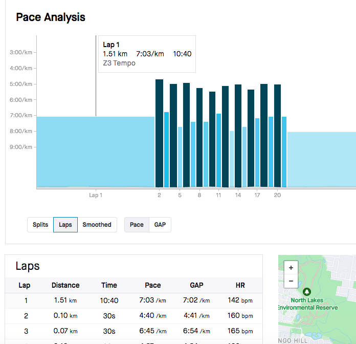

Here are a couple of screenshots from my little run today. I had a warmup for about 10:40 followed by 10 x 30s intervals and recoveries. On Strava itself this shows correctly:

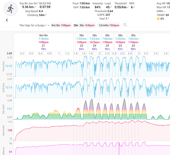

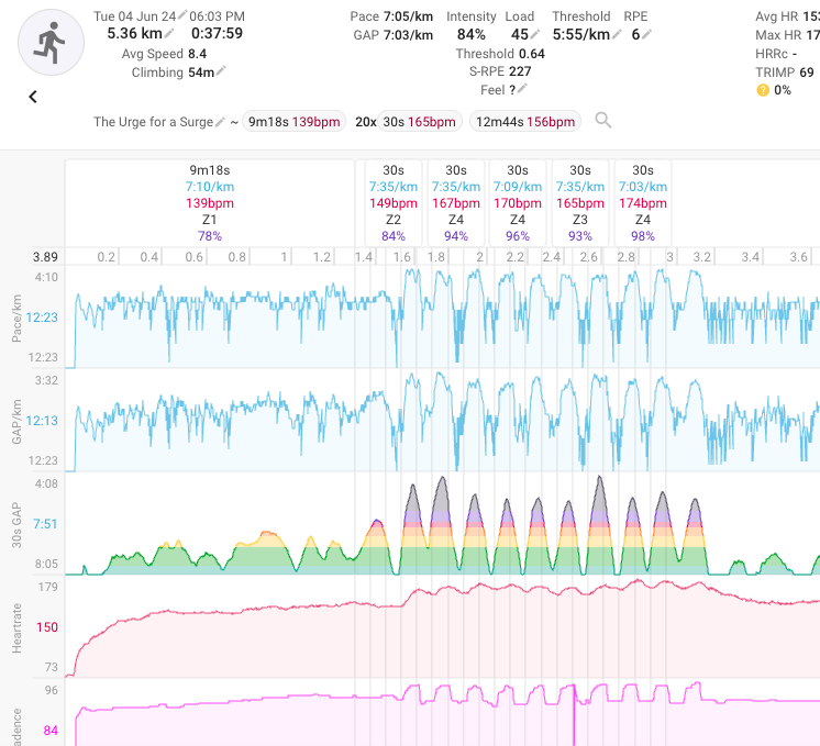

The same workout imported from the Suunto all the interval splits look correct:

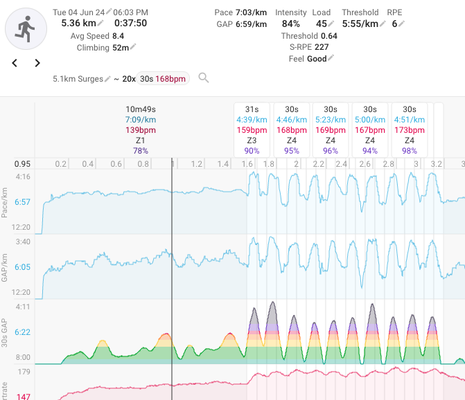

But the Strava workout looks like this after un-deleting, with the interval splits all offset by about -1.5 minutes:

likely this
Ah thank you, yes that would make sense that the privacy circle could mess with the start time. I’ll check that out
