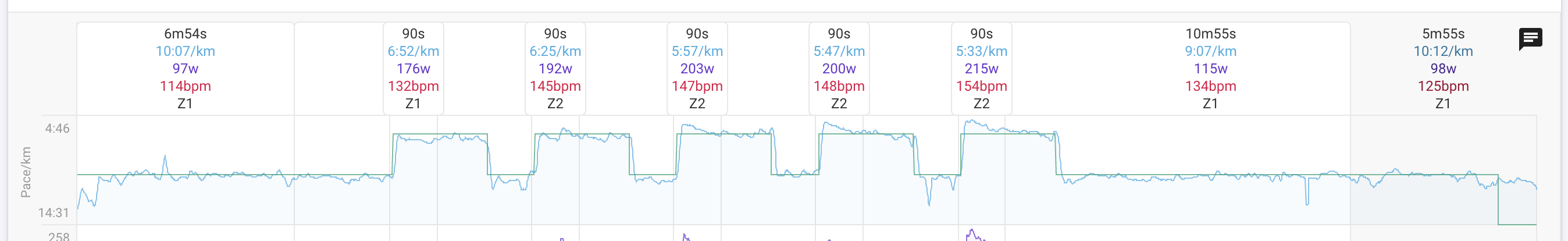

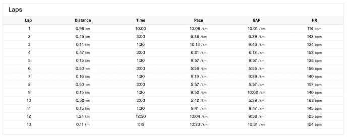

I see the intervals out-of-sync with the laps and would like to understand why. Take a look below at a screenshot from Strava, which shows the correct duration for each lap:

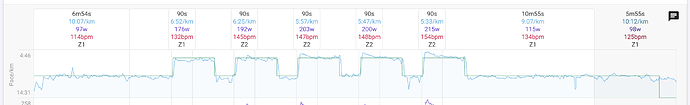

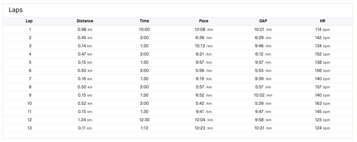

And here is how it looks on Intervals.icu when using the “Use Laps” action, which detects intervals based on the laps:
Is it a bug or am I missing something? Link for the activity: Intervals.icu
Thanks in advance!
Juan
That usually happens when you have Strava privacy circles enabled. Strava sends bad lap data to Intervals.icu. Those intervals are quite square so the (non lap) auto detection will probably pick them up. Otherwise you need to manually add them or turn of Strava privacy circles. You can also log a ticket with Strava though this bug has been around for at least 3 years so I am not sure it will ever get fixed.
