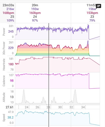

On my todays FTP test it seems to be wrong again.
My 20 minute effort had such a stable HR - 180 for 3 minutes straight. No way this is correct. Especially when compared to the movement of the HR before that 20 minutes.
20 minute ftp interval:

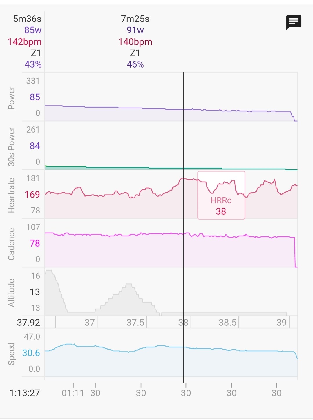

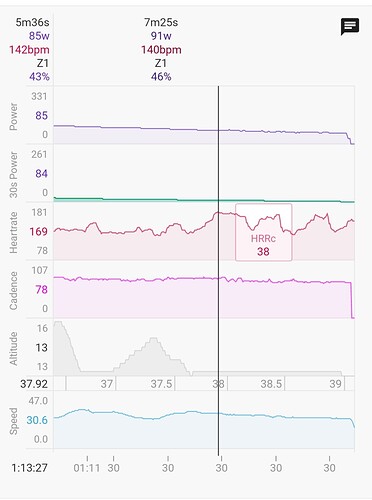

Also the last 5 minutes my HR jumped and fell from 130 to 160, back down and up again even tho I had layed on the floor for a few minutes after the effort and was just noodling at 100-70 Watts for recovery.
So does this look like defect strap or incorrect strap usage or something wrong with my heart rate? What can I do to verify either?
I had exactly the same symptoms with my H10. Polars tend to ´stick´ to the last measured value. The strap was faulty.
Now using the strap from Garmin dual with the H10 on it.
I had a similar issue recently with Polar H10. In August 2021 I had a minor heart attack - so I’m sensitive to anomalous heart rate behaviour. The H10 worked fine for a year, then it started playing up (after 30-45 mins in a Zwift race, the indicated HR would slowly decline, despite me climbing a hill or sprinting to the finish). Replacing the battery did not fix it. The definitive test was when I wore a Halter Monitor for 24 hours (a 5-wire portable ECG recorder), and compared the output… my heart was behaving normally. It was the Polar H10 that was faulty. (Thanks cardiologist.) I was reimbursed for the HRM and went back to buying Garmin.
