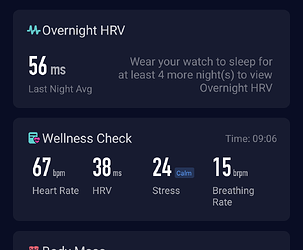

I have one problem though: I own Coros Pace 2, and after recent update they are monitoring HRV just like their more recent models. I can do wellness check to get rMSSD and stress values, also overnight HRV is shown, but unfortunately neither ot these are syncing with Intervals, I’m only getting sleep and RHR values. Can you please look into Coros API for this values?
int-hrv
There are two posts regarding this a bit higher. There’s also steps and calories available from the API now. I’m sure it is on David’s list.
