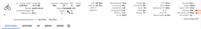

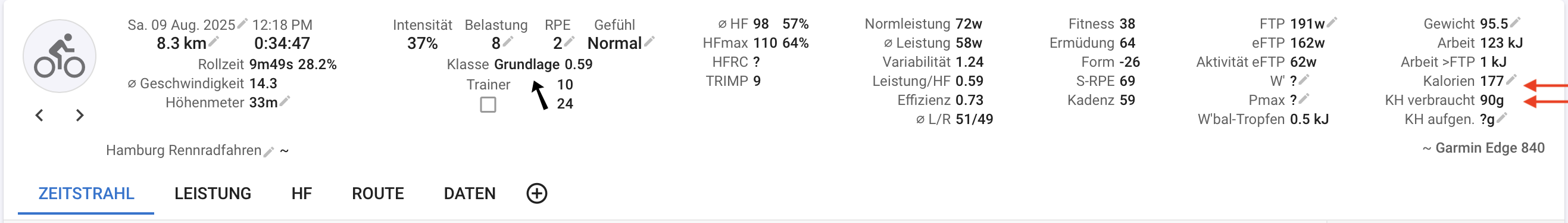

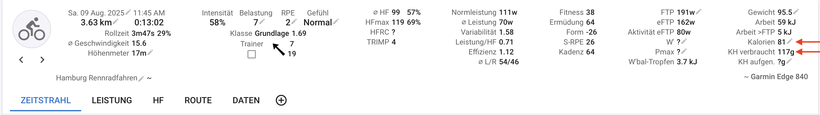

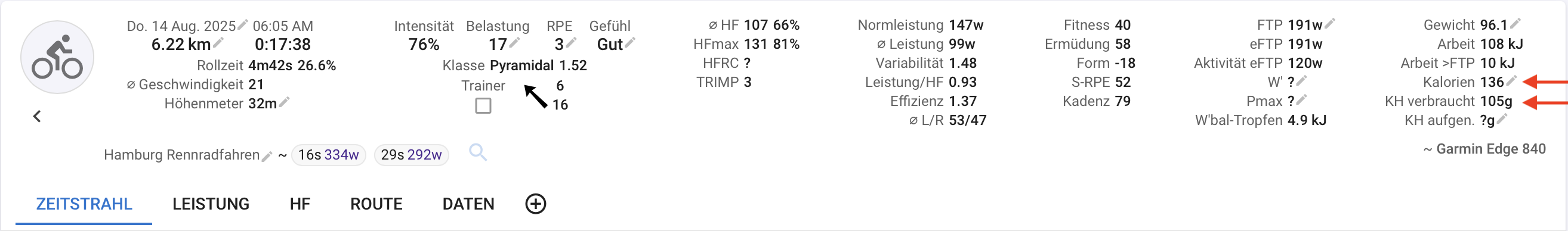

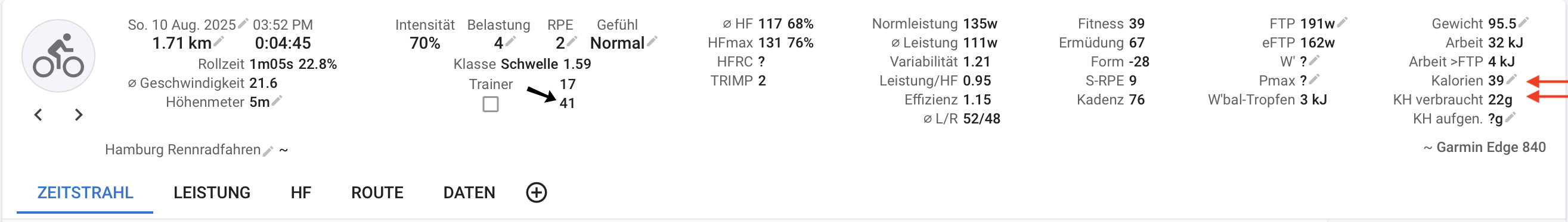

@david I have some weird values concerning Carbs used in some of my sessions.
Especially when the sessions are very short, the Carbs used (in german: KH verbraucht) shows values that can’t be right.
I marked them in red in the screenshots. As I said, what all sessions have in common is that they are very short and have a very low calorie usage.

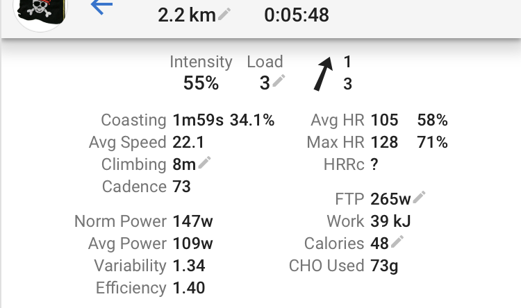

An extreme example is this where I stopped 2km before finish, and accidentally saved the activity, so this was the remaining part:
73g of carbs for a 5 minute ride with 2 minutes of coasting is a huge estimation. I understand that this is an extreme example with only 5 minutes, but also have examples with 15 or 20 minutes rides (commutes in hilly area)
So this implementation makes it difficult to build summarised values for weeks or a month if single activities, especially recovery rides or commutes estimate too much used carbs.
Yeah that is obviously an invalid estimate. Similar to rides much longer than 90 mins not being reliably estimated, there is also a lower limit (due to the use of the squared training load terms in the models). So 30-90 mins would be the range these models were made for. I know that’s a huge limitation for this group but it’s a known limitation. I can work with Mark to offer a workaround estimator for very short or very long sessions.
