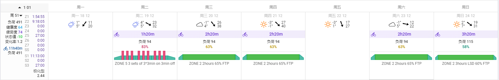

Can't feel FTP increase after 5 weeks of Polarized training
Background:I am 30 years old, 60kg and start cycling from july, I got a smart trainer at novermber to train seriously.
First of all, I made a ramp test lite, got my FTP was 158w, I thought it was a little bit
overestimated. I used 150w to start indoor training.
I have been cycling like this plan for 5 weeks, but I dont feel any big differences from from beginning to end.
I have no idea if this plan is not good, or I need more weeks to focus on it.

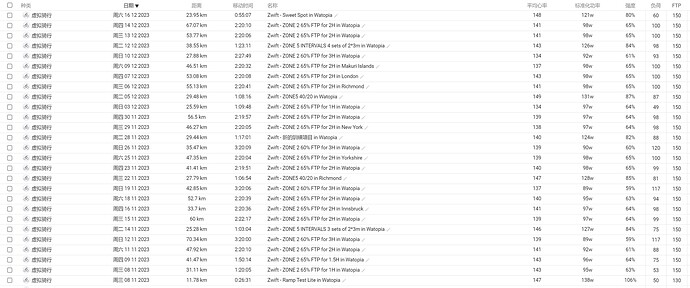

I’m 167cm, 62kg in July, max HR is 188. I rode casually at first, but in September I started aerobic riding with a heart rate of 140-150. Generally speaking I do four to five rides a week.I don’t do any other exercise either
This is the problem. I feel that maintaining low intensity has not become easier. From the picture, it seems that the same power only slightly reduces the heart rate, and sometimes even increases. I am not sure whether this is a problem with my condition that day or the change of the indoor temperature.

I read on social media and forums that a rookie like me could do four days a week of aerobic cycling and one day of high-intensity cycling.
