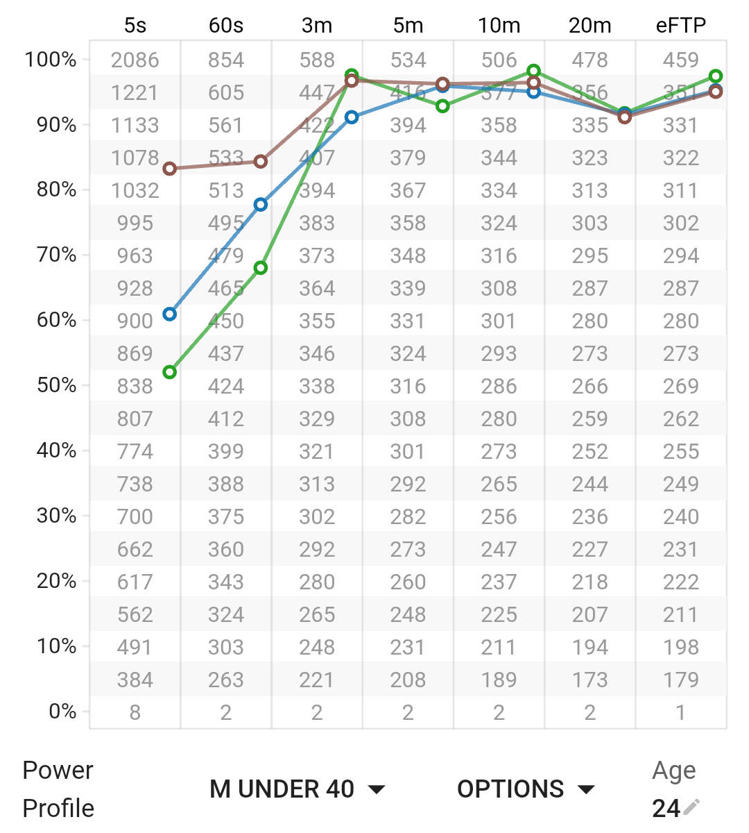

Looking at my power curve, I found that I have a large VLamax and threshold training is probably the best to lower VLAmax. I was always blocked by pain in my legs during greater efforts, recently I haven’t had it !!! It is possible that type IIx muscles evolved into type IIa.
There is one more option, my “assioma favero” are going crazy :slight_smile:
How did assess that you had a large VLamax?
This drop in rank between 1 minute and 5 minutes :slight_smile:
And it matched what I felt in my legs with what I read about high VLAmax. More intuition than research.

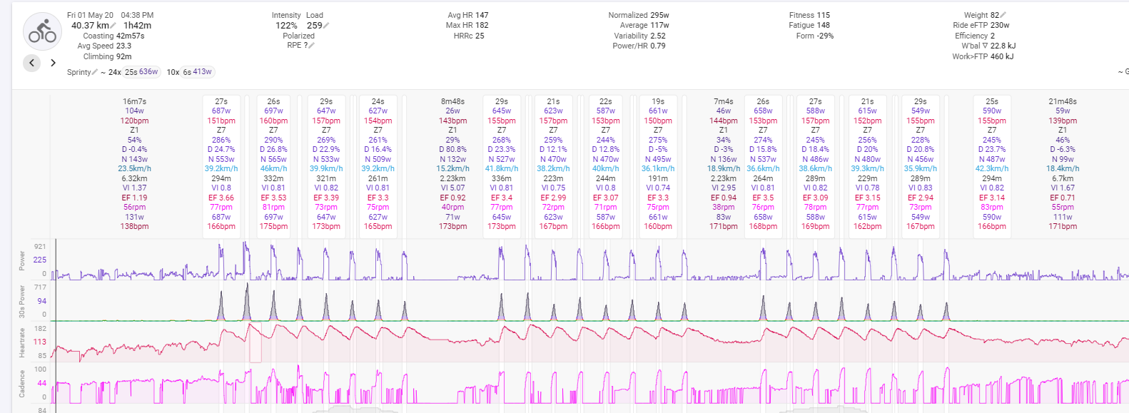

Screenshot_4
Or that I can do 259 TSS in 1h42m during sprint training :slight_smile:

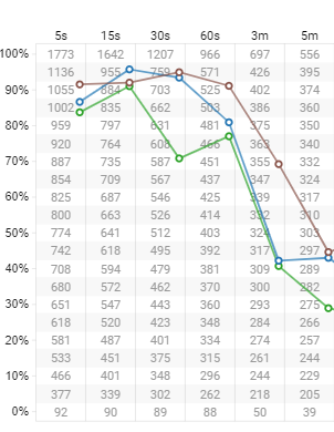

If a large drop between 60 seconds and 5 minutes is an indication of large VLamax would the opposite hold true? If so how would you suggest training for that?
For reference this is the position I am in so am interested in how this could benefit my training.
I am not a trainer as I wrote more in this intuition than research. How seriously you are interested in VLamax, you should get a fitness test. There they will detect at what level of Vo2Max your lactate increases drastically.
