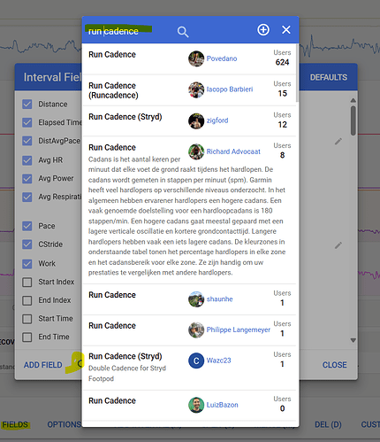

Where do I set the Activity Field and Interval Field?
Use one of the user created fields for both. There’s enough choice:
Thank you! Thanks for taking the time to high light where to find it… :slight_smile: was looking for this field in Wellness.

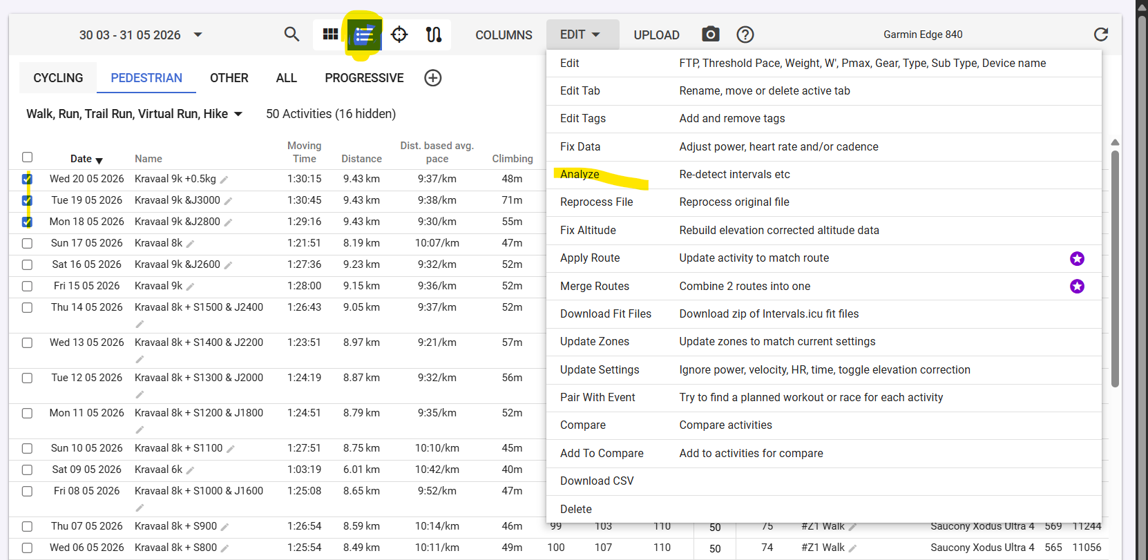

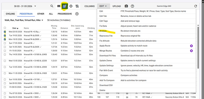

The field is added now. How do I update previous runs to have the correct cadence?
Re-analyse from the Actions menu at the bottom of the Timeline tab or do it in bulk from the Activity List View.

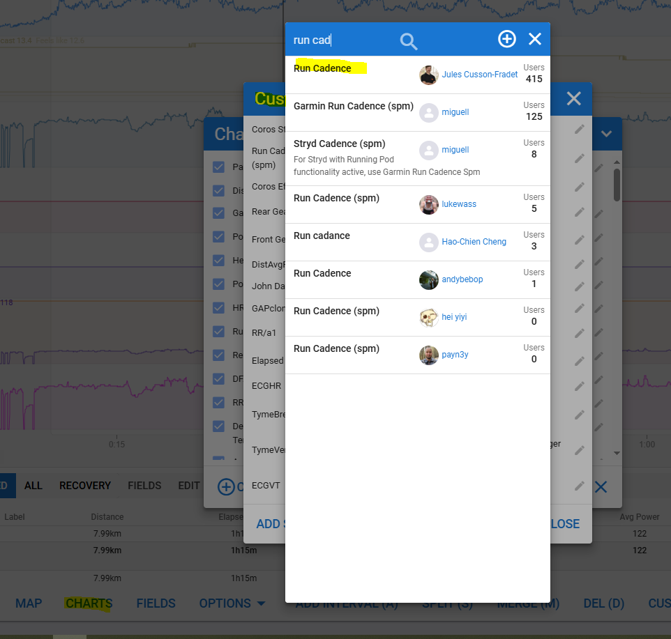

The chart will remain at 50% value?
I think you should find a chart under Charts > Custom Streams > Search
First add a custom stream for Run cadence (which will double the cadence from the activity file), then add a chart with that custom stream and drop the default cadence chart.

I can’t get the new stream working and displaying. I give up. I’ll just use the original 1-leg’ed cadence.
What doesn’t work? Did you find and add it?
If you done this it says you have to reprocess files to calculate those streams. For existing activities do Action > Reprocess File
For new ones it will do that automatically

Did you do
Oh, yes. Nothing happens.
