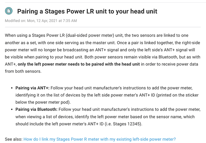

So, I think this fixed it, thanks. Note that the pairing such that one power meter reports for both works over Ant+. I don’t think it works over Bluetooth: you have to connect the two power meters separately with BT. Getting the connection to work over ANT+, so the Garmin saw the pair, was the trick for me.
According to Stages help pages, this shouldn’t be the case. It should present as 1 single BT id to your head unit etc. (same thing with my assioma Duo, only 1 bt is present. Although the app does provide an option to broadcast as left and right depending on head unit supports)
OK, thanks. In any case, I have it working right now :slight_smile:
