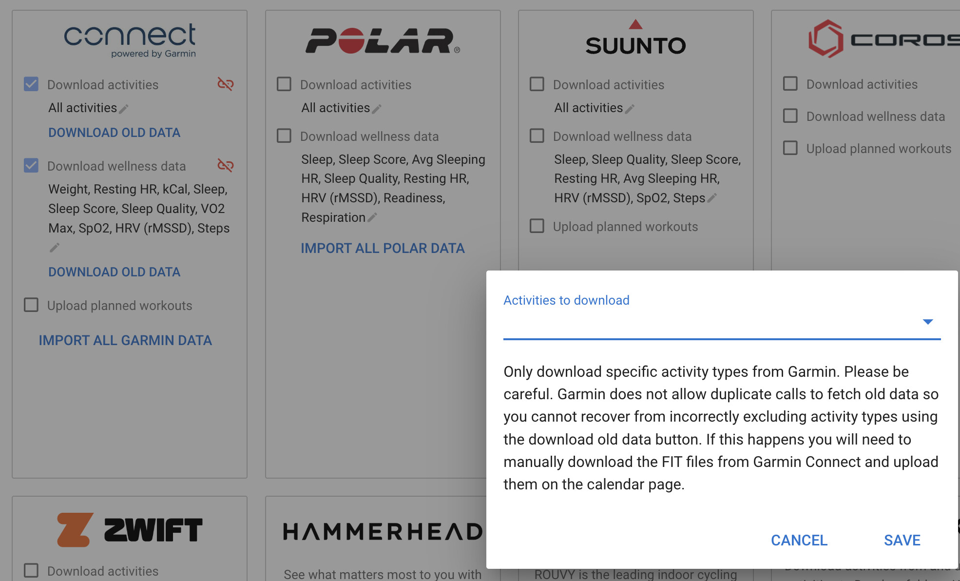

I don’t have a Wahoo, but on Garmin, there is this option to filter the activities to download. If there is one, you can use that.

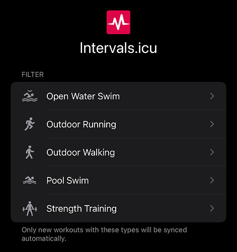

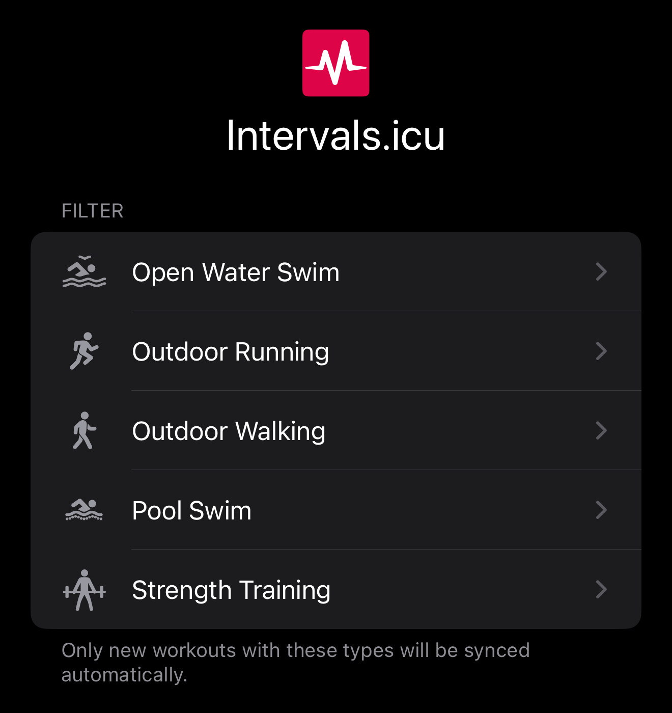

In HealthFit, you can chose what kinds of training you automatically want to upload to intervals.
So you could leave out cycling in HealthFit, and sync wahoo to intervals. And only choose running/rowing/hiking in Heathfit, or whatever fits your needs. :slight_smile:

I record my cycling workouts using Wahoo. Running workouts using AWU. Swimming pool using AWU. Gym using AWU.
Wahoo: I directly upload to Intervals and have all my bike workout data there. Likewise from Wahoo it uploads directly to Strava and also to HealthFit, where I then have that workout listed in the Health app.
AWU: syncs all workouts to HealthFit, from there it syncs automatically to Intervals and to Strava for me.
I only use these two connections and nothing else. Everything is organized as a whole. I recommend because it’s very simple and practical.

You excluded cycling within HealthFit to not be exported to Intervals I suppose.
