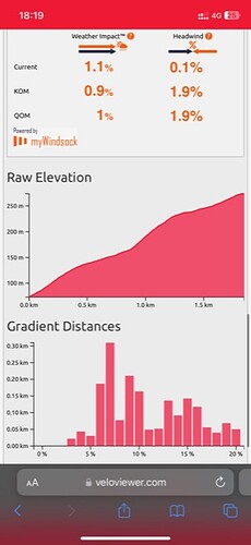

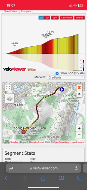

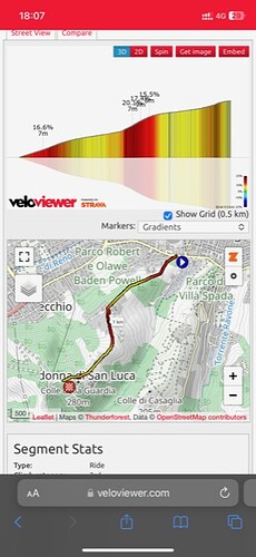

Looking at the Veloviewer view of the climb, it’s a climb of 4 parts: hard start, less harder, then a hard ramp and then the final grind to the top. Being fully warmed up is important and also knowing you average climbing speed (VAM).
From http://bikecalculator.com/ you can enter your weight (including kit, shoes, helmet, etc.), bike weight and all the parameters of the climb. 12:00 would require about 270W for a 89kg (total weight) at 10.8% without any headwind, and about 25°C.
