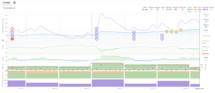

Here is my fitness graph and some stats: weight 70Kg - FTP on hometrainer 20 minutes test: 206W - that would be 2.9W/Kg ? Can I expect to see some more improvements ?

Yes, you can improve your fitness with limited hours.
Time is a limitation, so the progression will have to come from (1) intensity and (2) shortening the recovery between intervals (more time in zone). With 3 sessions per week, you would have to do more sweet spot than try polarise your training.
I had one athlete who could only do 3x 1h workouts per week, for 6 months, while training for a 98Km (1300m) event. He bettered his previous time by 26 minutes, as the training was geared around being able to hold sweet spot power for almost an hour (5m warm up only, no cool down).

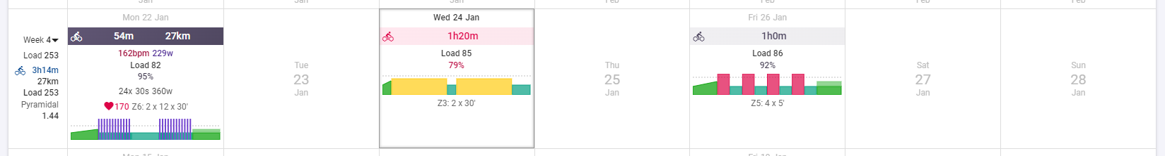

My current training plan currently consists of 3 sessions:
  • Monday: Z6 2 x 12 x 30"
  • Wednesday: Z3 2 x 30’
  • Friday: Z5 4 x 5’
If that is your limit of time availability, yes, do a lot more intensity. Your gauge on how intense, should be what you can recover from before the next training. If you have 2 back2back days, one of them will need to be less intense. If the training moments are more or less equally spread, all workouts will be very similar and hard.
Just be aware that you may hit a plateau in the near future. Some long rides will allow you to brake through that plateau.
You can make these workouts progressive too
  • Sweetspot can be 2x15, 3x12, 2x20, 2x25, 2x30, 1x40, 1x45, 1x50, 1x60
  • VO2 can be 3x4, 4x4, 5x4, then 3x5, 4x5, 5x5
All limited by duration, but progressive in time in zone.
Edit: re-reading this after a notification of a like, this can apply for sweet spot progression as well as threshold power.
