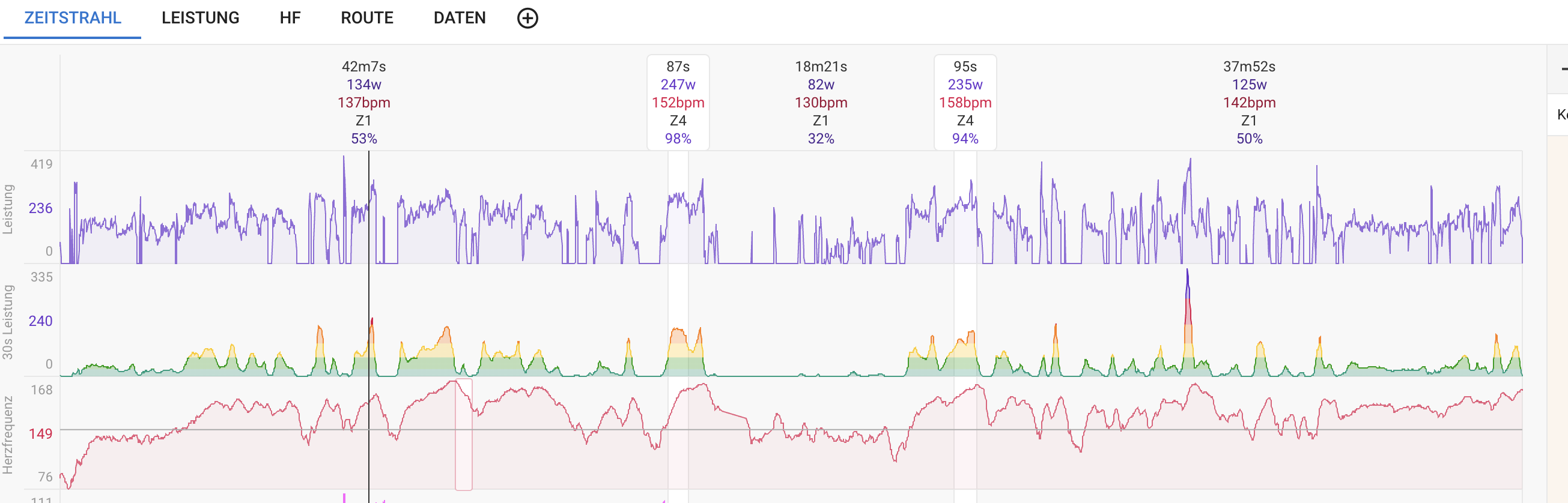

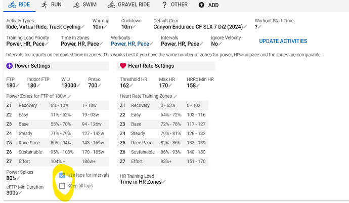

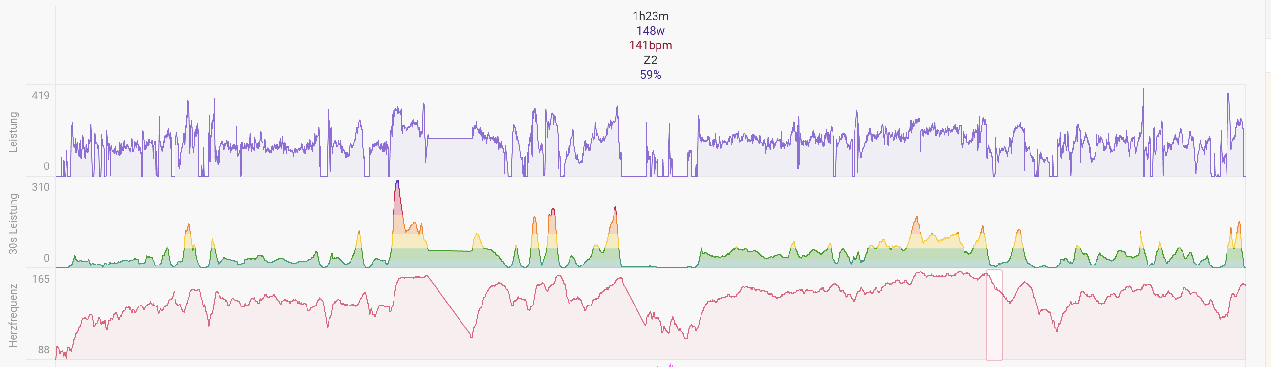

Hallo, früher wurden bei mir Intervalle immer sehr gut erkannt. Aktuell sind keine zu sehen. Siehe auch die beiden Vergleichsbilder. Warum ist das so? Nach welchen Kriterien legt das Intervals.icu fest?

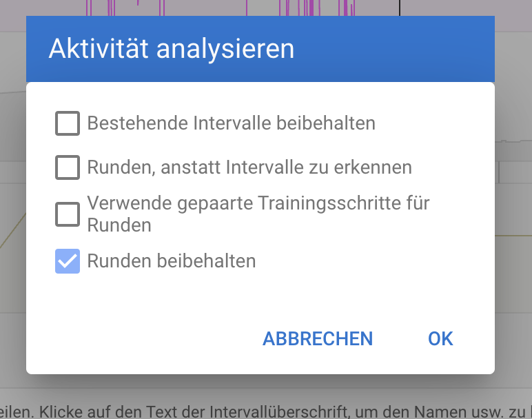

Did you inadvertently activate ‘Use Laps’? If so, Intervals will not search for intervals but simply use the lap events.

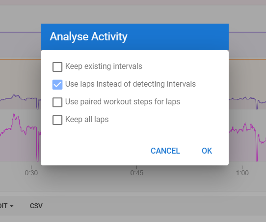

Open the Actions menu and choose Analyze. The box opens with the selections that were used on import.
Unselect all and click OK, then Intervals will auto-detect intervals.

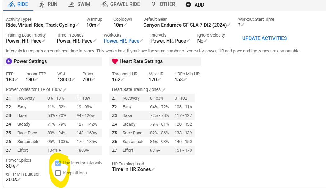

On the Settings page, you can set the default behaviour for the different categories.

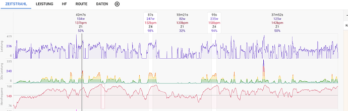

Thank you but it doesnt work:
Always the same result

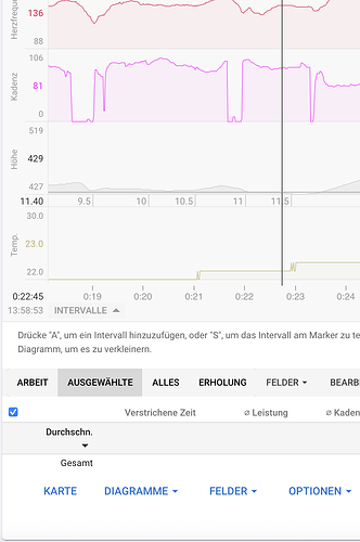

Another Problem. When i zoom in and mark an interval it shows nothing in the under section. See picture
From your screenshot, it appears that there are no intervals in that activity? Nothing marked yet?

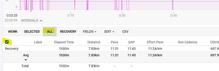

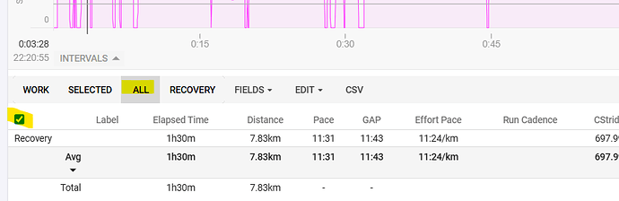

You may try to view ‘All’ which would show all active and recovery intervals. On an activity without any interval it would show like this
That’s because an activity without intervals is considered ‘Recovery’ for the entire activity.
