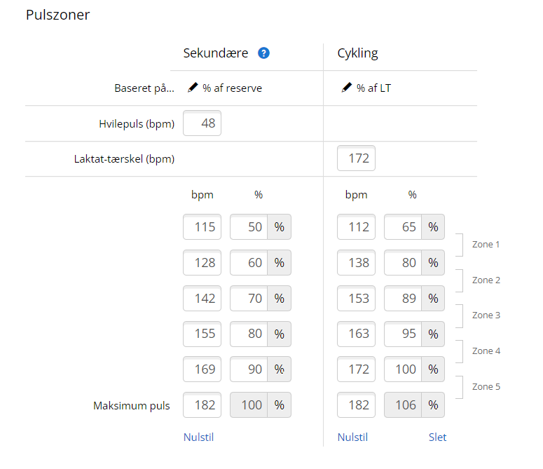

Just did a 20 min FTP test today and saw a wopping / surprising increase of my Threshold HR with +2. I had an avg heartrate 6bpm higher than my last FTP test I did a month ago. This brings me to question my HR zones and what algorithm to use for this? especially my Zone 2 ?
In garmin I’ve been using my max HR and resting HR (from my watch):
Just tried to change this to “based on threshold” and I get 153bpm for Zone 2 insted of 142bpm with my “old” model.
I know I know… typically LT1 is not Zone 2 limit but again… when I train endurance rides I would like them to count as “endurance rides” :slight_smile:
Any recommendations here on what to do?

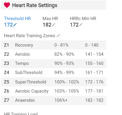

Intervals has Friel HR zones selected by default.

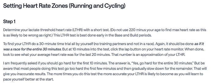

Friel threshold HR is estimated doing the following:
  • solo 30 minute time trial
  • do this as if it was a time trial, an all-out 30 minute effort that is evenly paced or as a negative split
  • don’t start too hard, and yes, it takes practice to do this correctly (just like 20-min test)
  • after 10 minutes, click the lap button
  • use average HR of final 20 minutes as your estimate for Threshold HR

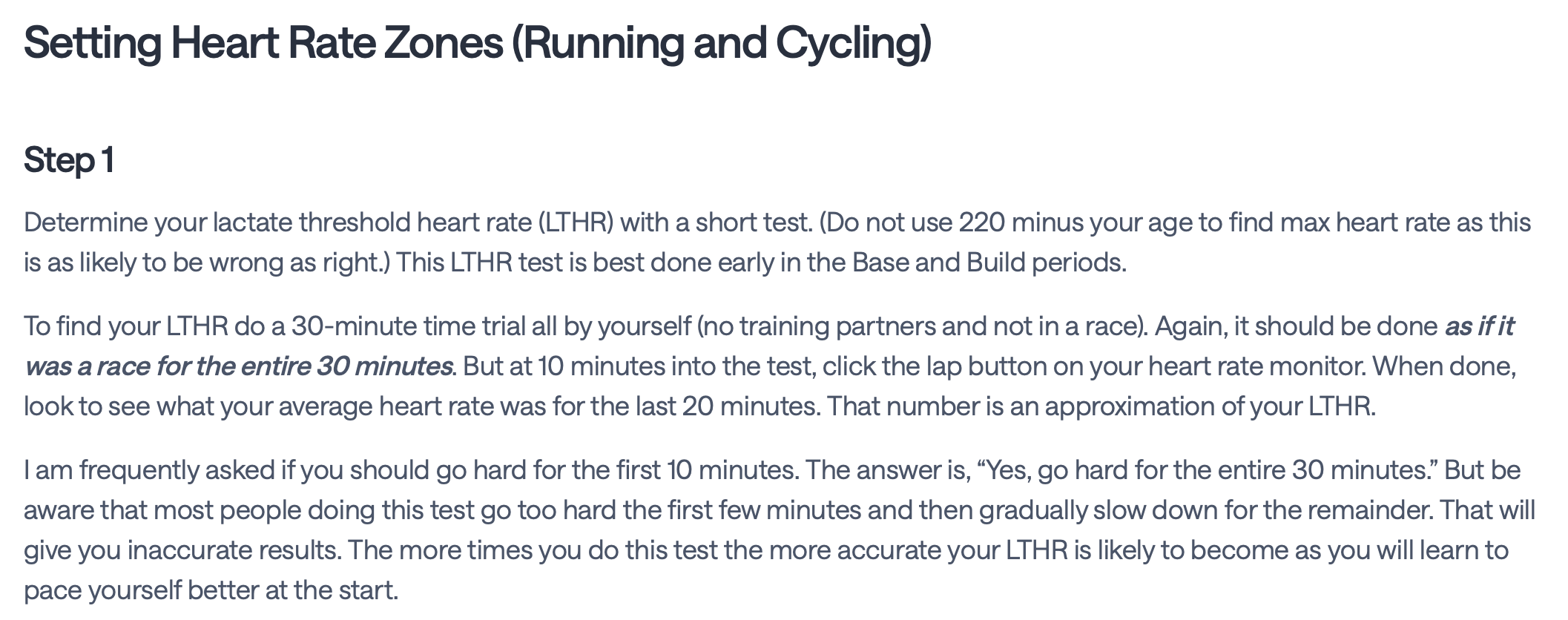

Here it is on TrainingPeaks website:
Thanks for this. I think THR will be a bit lower then :sweat_smile:
