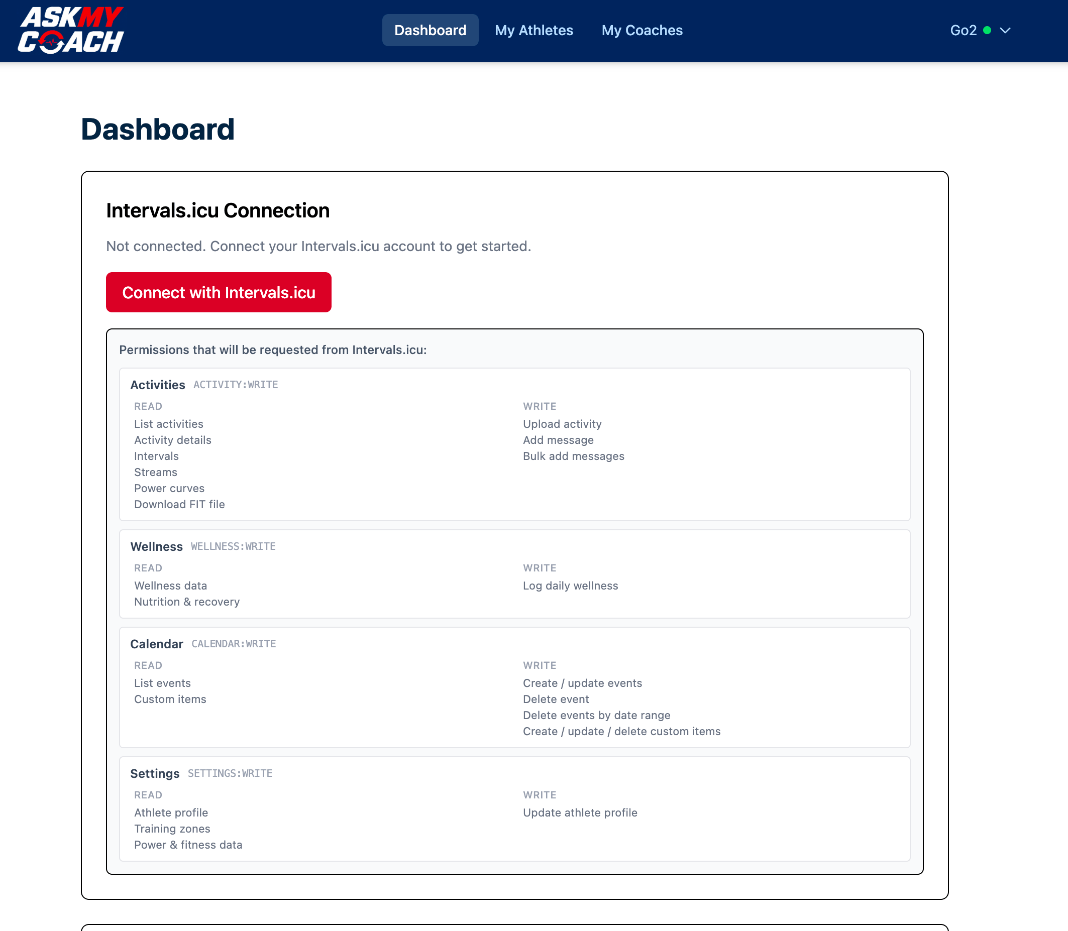

Hello everyone,
My name is Iaroslav, and I’m an athlete from South Carolina. I originally built AskMyCoach.app tool for myself and my school track & field team because using a local MCP server wasn’t very practical - especially since I do most of my training analysis on my phone.
The app currently includes 38 different tools to help athletes analyze their training and help coaches review athlete performance and progress (no accounts needed). You can read data from intervals.icu, write data back to intervals.icu, create weekly plans, analyze races, and more.
The MCP can be used with any AI platform that supports MCP, including examples like Claude and ChatGPT.
What it does

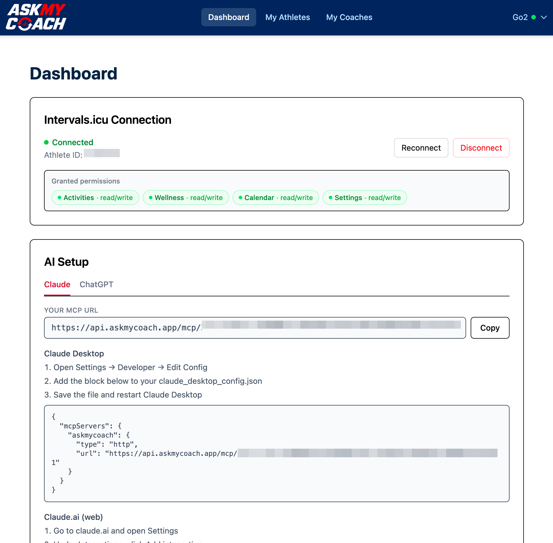

AskMyCoach.app does one simple job - it translates AI requests into calls to the intervals.icu API. Nothing overly complicated. Just a simple and useful UI designed to make everyday workflows easier for both athletes and coaches.
The real value is in the tools themselves and how everything was optimized. My goal was to create a system that provides enough information to AI models while minimizing token usage and reducing operational costs.

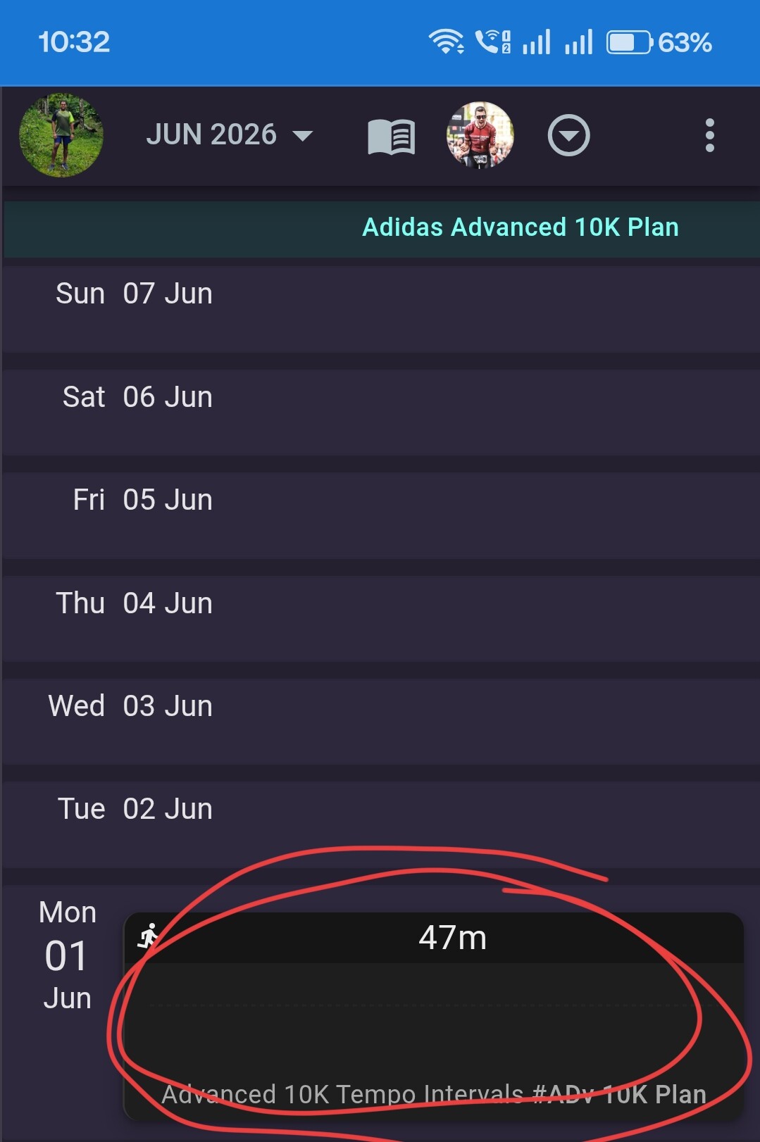

Hi @Iaroslav — first, thanks for building the AskMyCoach Intervals.icu integration. I was able to do a ChatGPT setup, thank you. I got a workout report generated that worked nicely but when I got a workout plan created and pushed to intervalsicu, the graphical representation was missing on intervalsicu. I asked chatgpt to explain the issue for you to understand (I’m not a tech guy so needed help here​:blush:). Here is the note from ChatGPT for you to understand the issue:
While creating structured running workouts:
The `add_or_update_event` endpoint appears to strip nested pace target metadata from `workout_doc.steps[]` during creation/update. As a result:
* interval durations/reps are preserved
* but pace targets (`secs/km`, `%pace`, etc.) are removed
* Intervals.icu then renders the workout without graphical interval bars, color coding, or structured targets
Example: Existing workouts created through other platforms retain structures like:
* `pace.units = “secs/km”`
* `pace.start`
* `pace.end`
* nested repeat blocks
But workouts created via AskMyCoach MCP get simplified to duration-only steps. This affects:
* visual interval rendering
* watch sync quality
* structured execution cues
Would it be possible to expose/preserve the full `workout_doc` schema when creating/updating events instead of flattening the structure? This seems mainly like a serialization/parsing limitation in the helper layer. Hope this helps.

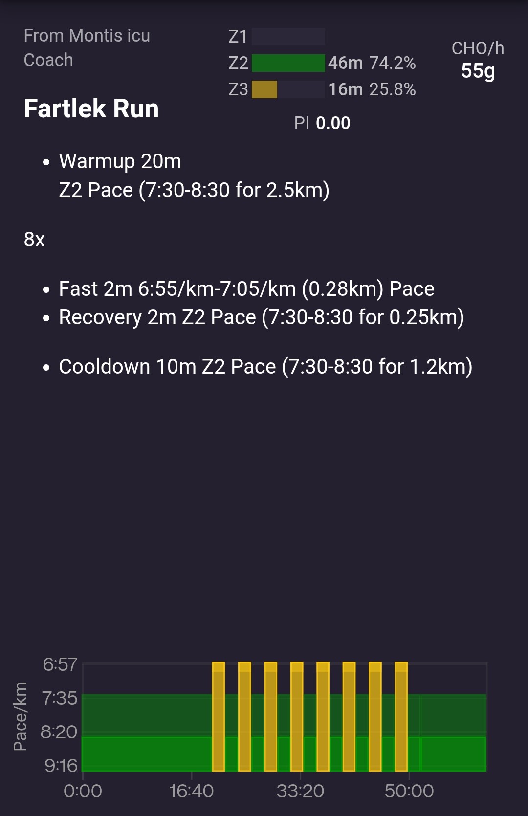

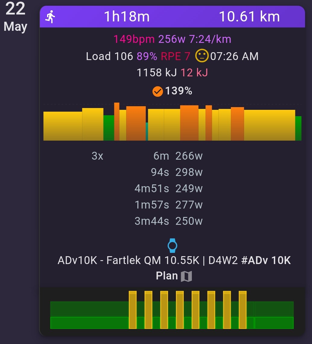

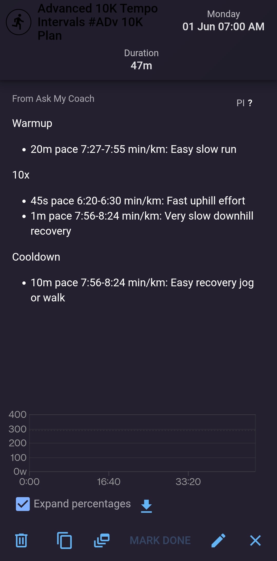

Thanks for the example. I was able to update it following the native way of entering data, but there is still no visual interval rendering. At the same time, there is no visual interval rendering even for the same training session that I built using the internal intervals.icu builder. With HR works just fine btw.
I’ll look for more examples with pace ranges, but do you have any workouts where visual interval rendering is actually showing up?
Yes, the below one in the picture is the workout plan that I created through montis icu ChatGPT and the the one above is actual workout. Not sure if this is what you were looking for…

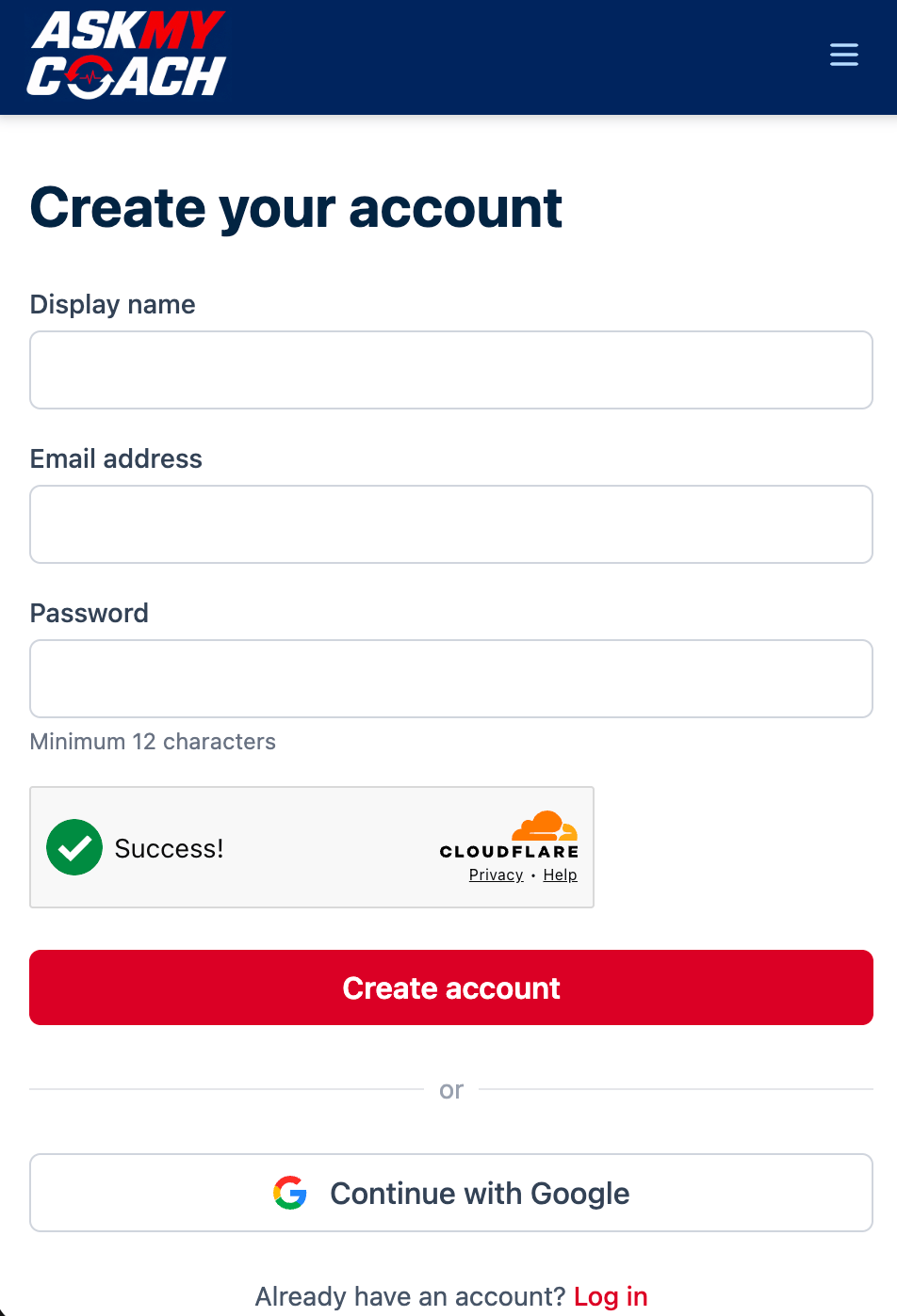

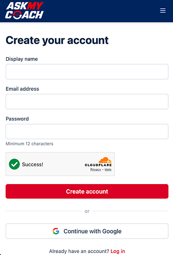

Registration is avalible w/o invites :slight_smile:
Today I created about 60 test events for running and 60 for swimming. All of them were created successfully, as expected. I’m currently working on optimizations to reduce token consumption. I somehow overlooked bulk event upload, but it has now been fixed, and a new tool is now available. :slight_smile:
Important: If some data is not visualized correctly, make sure you have set up all necessary basic information on intervals.icu/settings — check your pace, power, and training zones for each sport you use. You can ask an AI assistant to help you calculate these values.

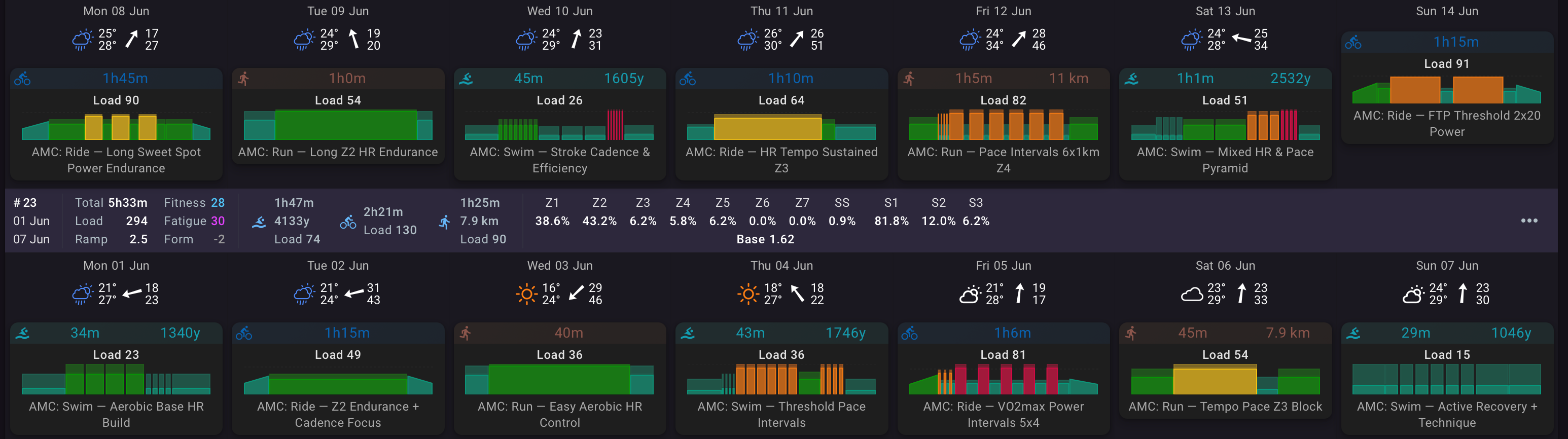

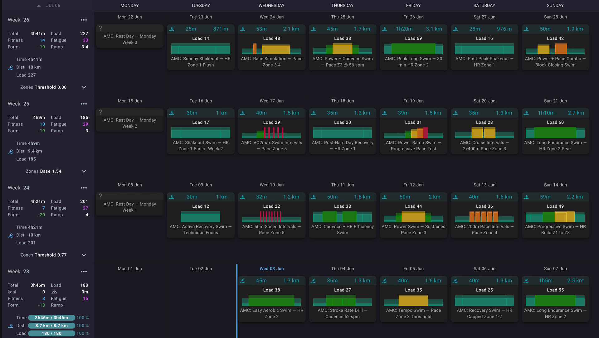

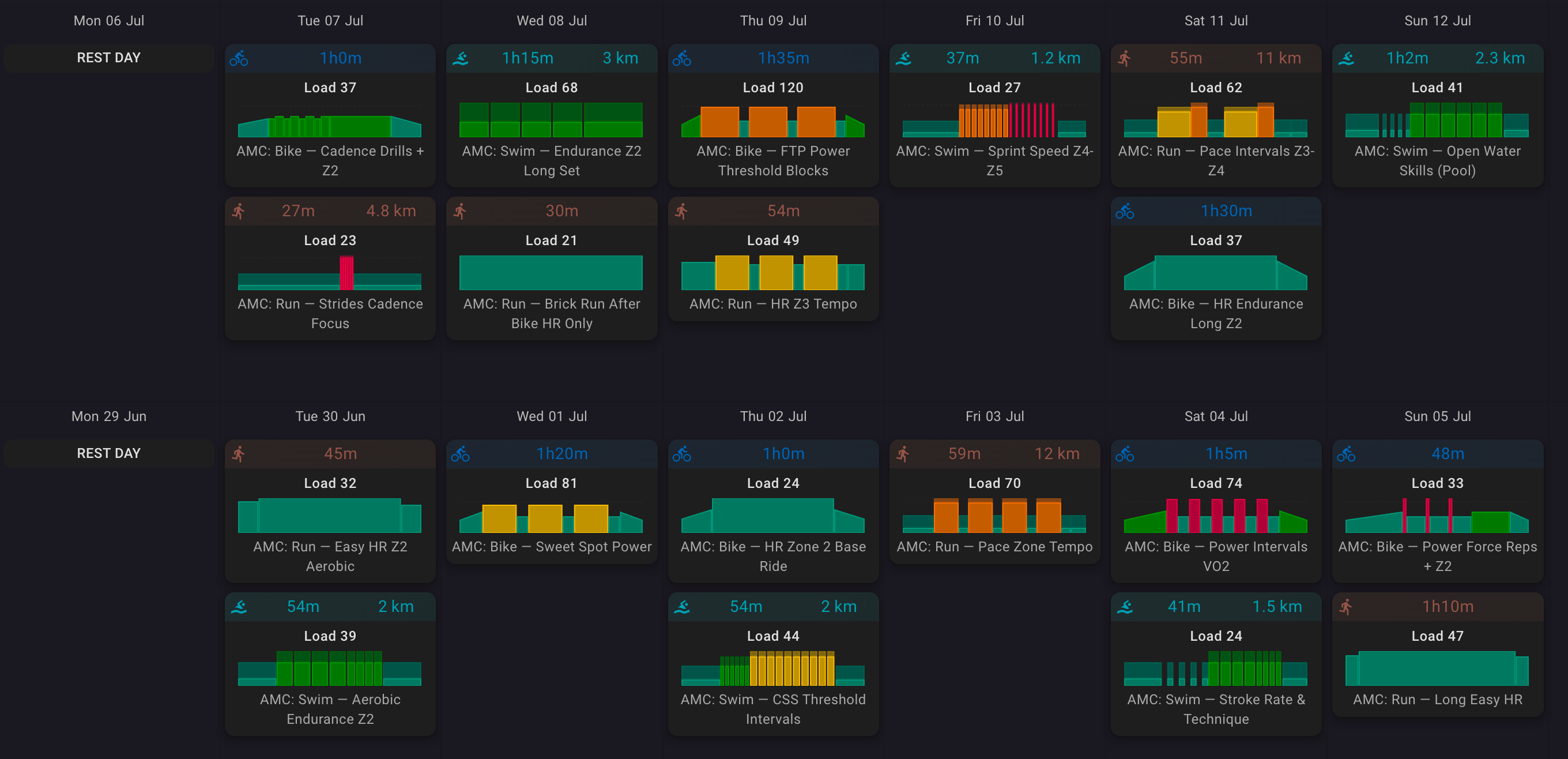

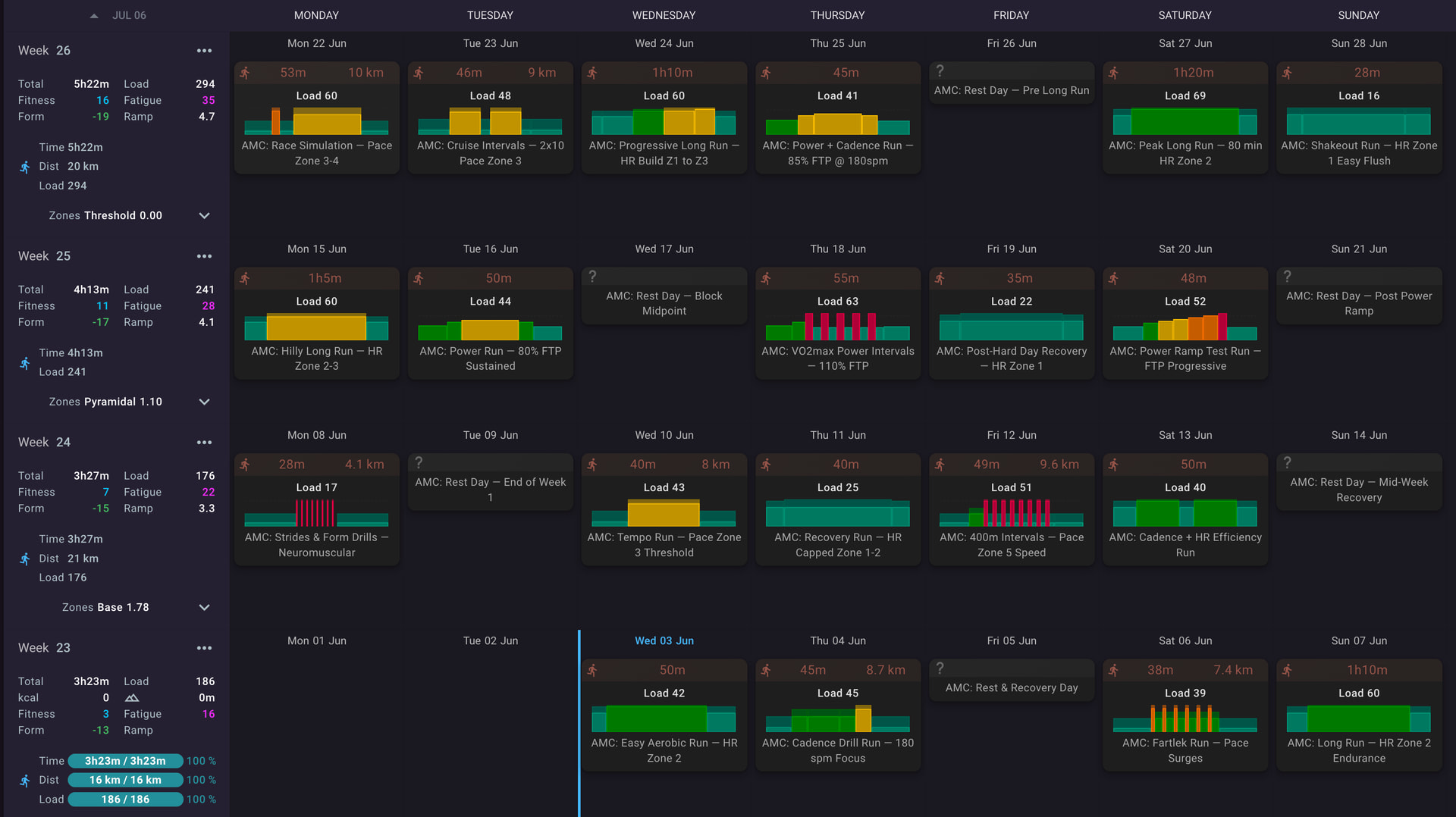

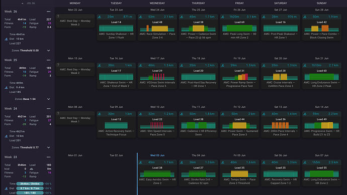

Another test - two weeks of triathlon exercises using Claude + AskMyCoach.app

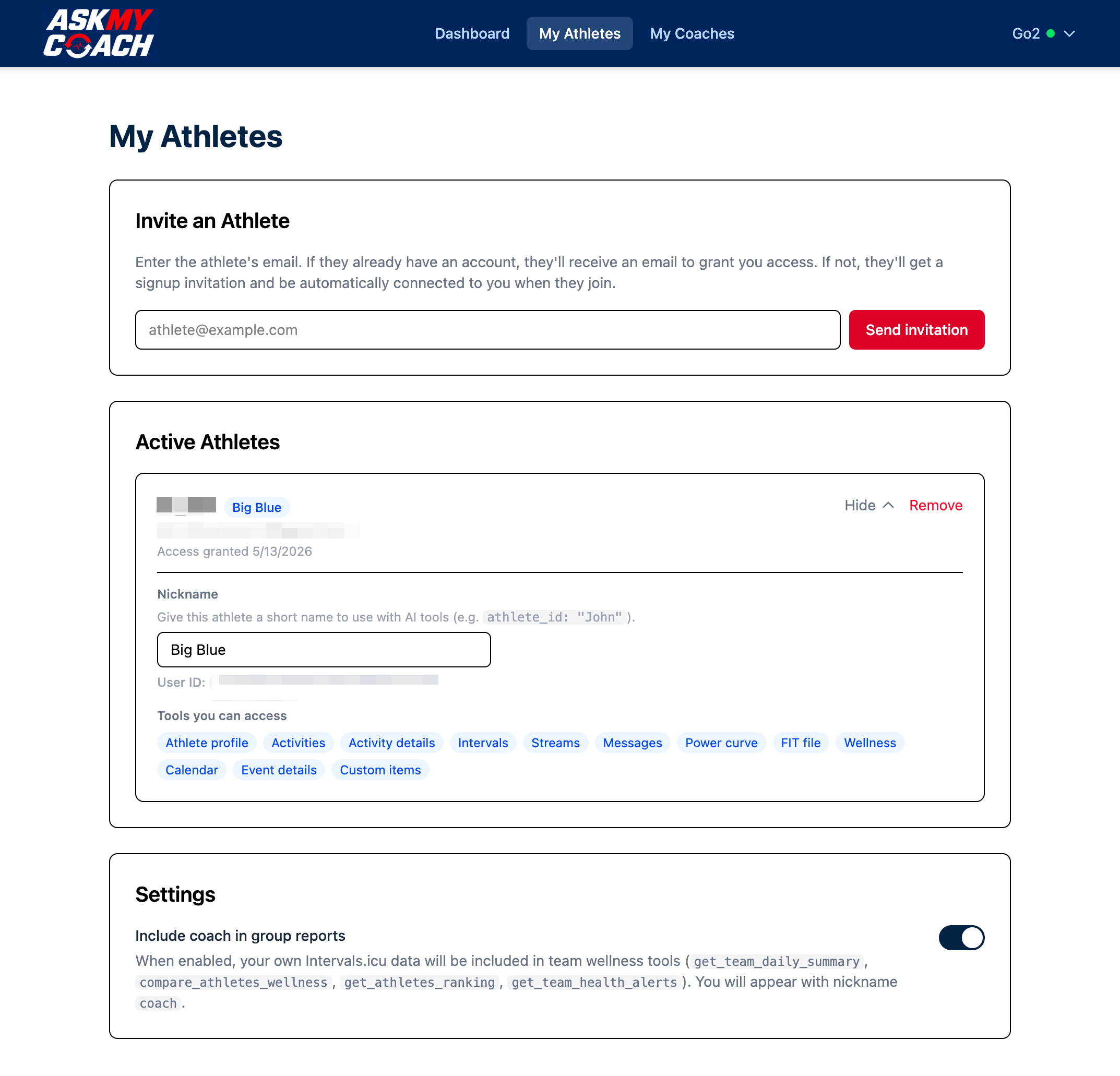

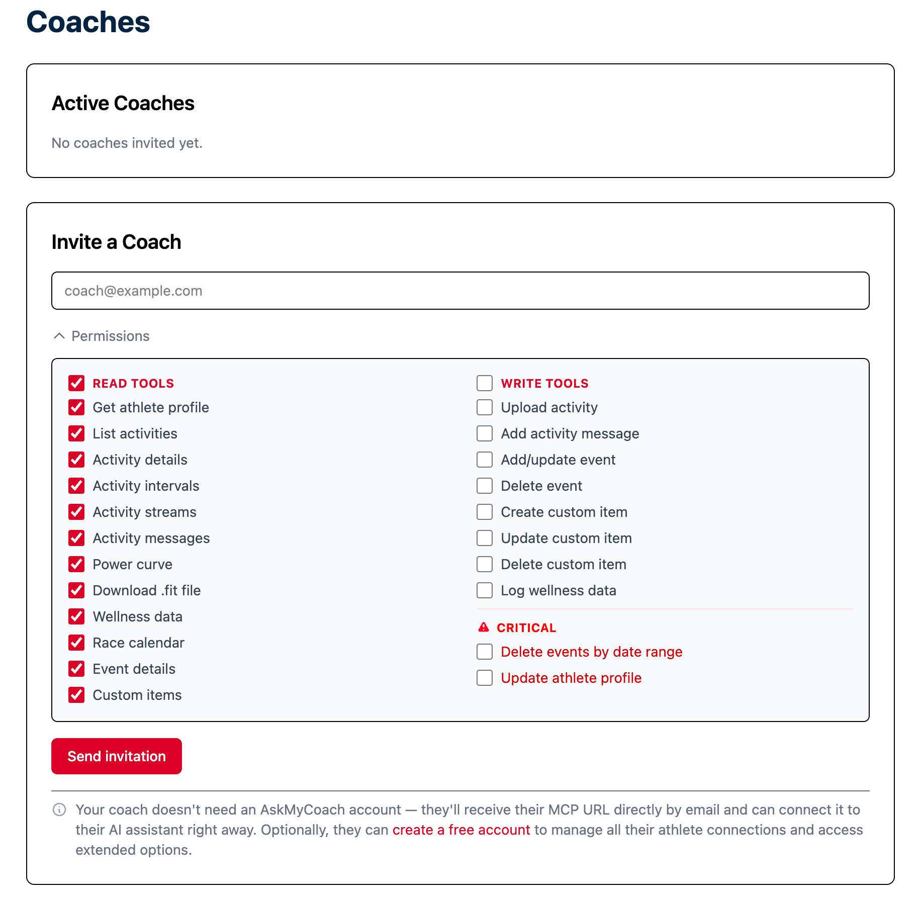

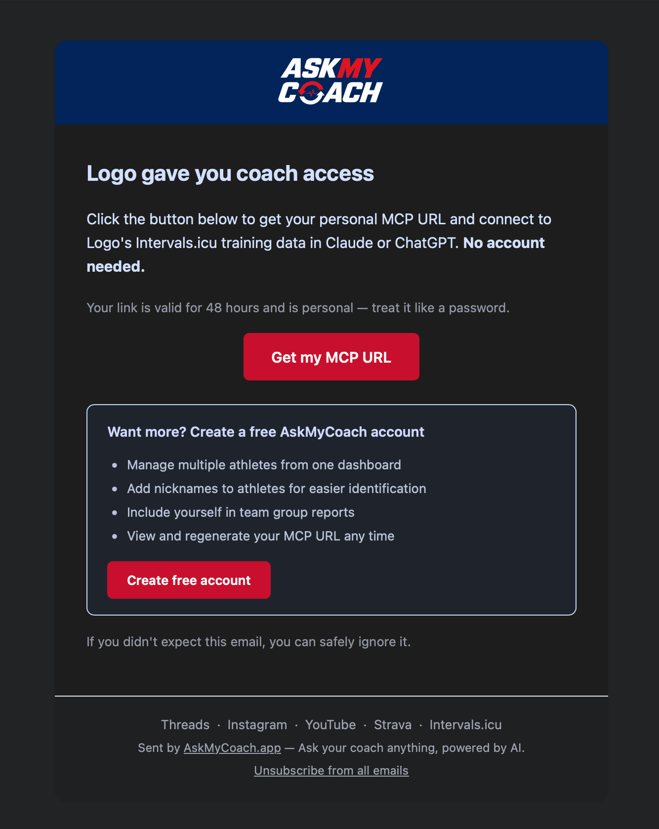

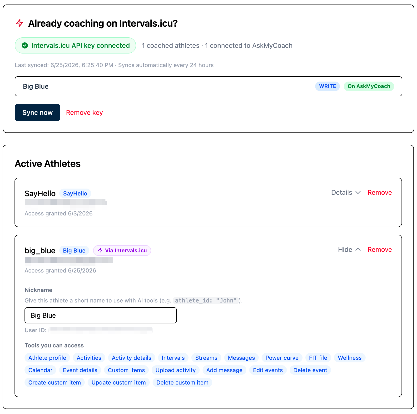

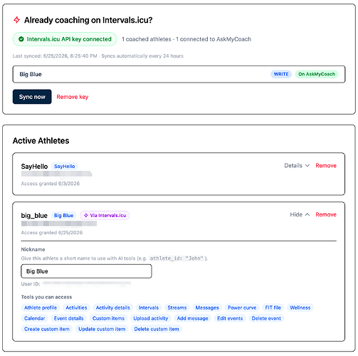

New Feature for Coaches - you can now import your athletes directly, with no need to invite them to AskMyCoach.app. Just keep in mind that they’ll receive a notification letting them know you plan to use AI to analyze their data.
