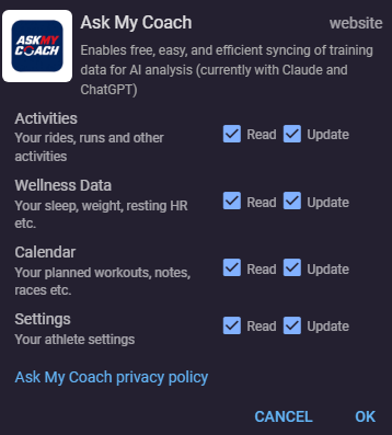

Hi, thanks for making such a great connector! I have a question regarding usage. I think I’m doing something wrong since I have enabled the connection between Intervals.icu and AskMyCoach:
And I can access AskMyCoach via ChatGPT:

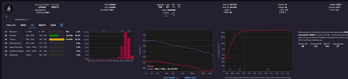

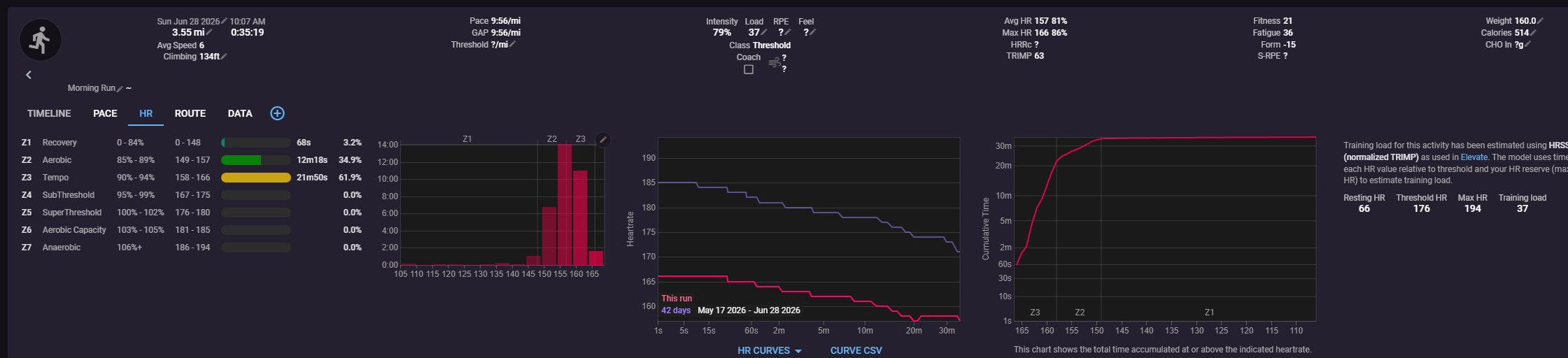

Yes, for instance this is the heart rate tab of a recent Strava exported activity on Intervals.

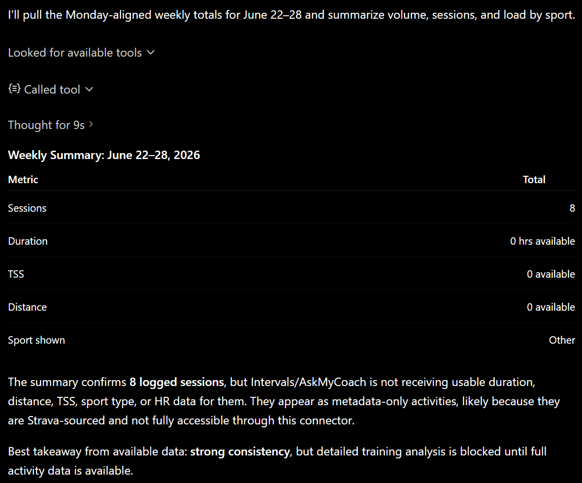

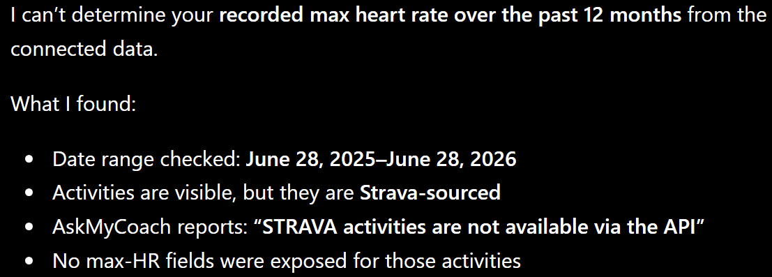

I’m able to get my CTL/ATL for each activity, however when I asked it to find my max heart rate over the past 12 months, I received the following output:
So, the first issue was mine - I didn’t include cases where you don’t have Threshold Pace and Intervals.icu is showing activities with TRIMP-based load. I fixed it - now if there is no TSS data, the API returns TRIMP data. I need more test cases :innocent: .
Regarding your second issue, it is more complicated - as far as I was able to find, it is a Strava limitation, unfortunately. The data is coming into Intervals.icu, but it can’t be shared via the API - [SOLVED] Data misssing through API (Strava Restrictions)

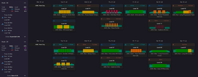

Made a couple of updates to the Workout Builder MCP. I’m hoping they’ll help the AI use it more effectively. I caught a couple of issues this week while preparing my training plans. I’m hoping we’ll soon reach the point where it won’t require any further tuning. :joy:

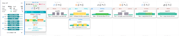

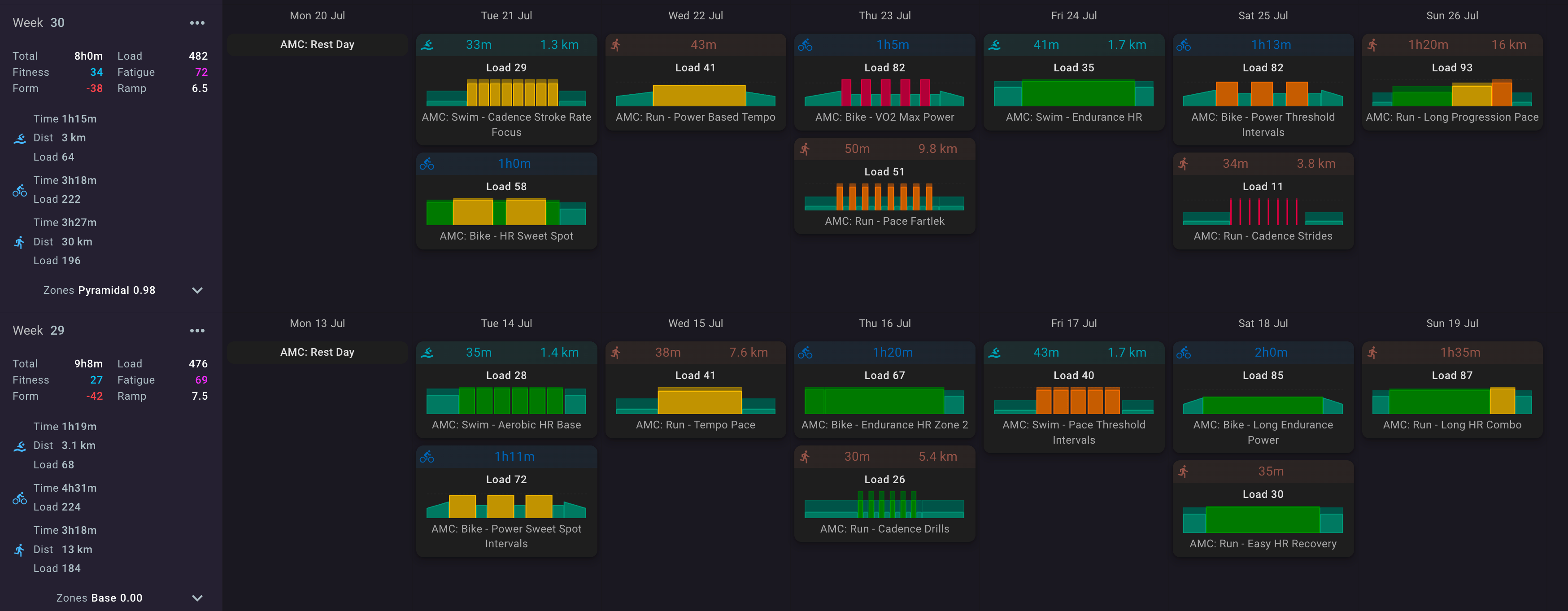

This is my week.

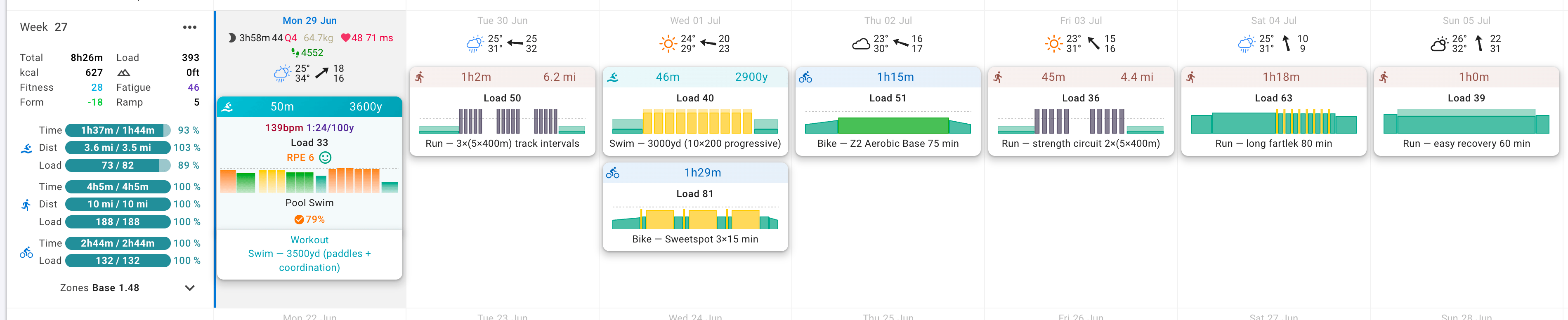

And this is the traditional random 2-week triathlon test.

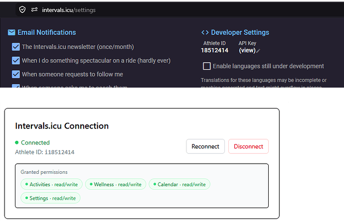

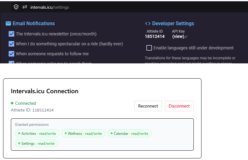

When I connect my Intervals.icu account through the askmycoach.app integration, it stores my Athlete ID with an “i” prefix added to the front (i18512414) instead of the actual ID shown in my Developer Settings (18512414, no prefix).
I believe this is because I’m a long-time user and my account predates whatever ID format change added the “i” prefix for newer accounts. My actual Athlete ID has never had that prefix.
The mismatch causes a problem on the AI/MCP side: when an AI agent tries to connect using the prefixed ID (i18512414) returned by the integration, it gets an error saying it belongs to a different user because that ID doesn’t actually match my account in Intervals.icu’s system.
Screenshot attached showing both: Developer Settings with the correct ID (18512414, no prefix) and the askmycoach.app connection screen showing the prefixed version (i18512414).
Is this a known issue with how legacy accounts are handled in this integration? Happy to provide more details if needed.
Hello @MCetin !
I got your email, and the fix is already in production :partying_face: . Could you please test it?
Confirmed :heart_eyes: , really appreciated the fast response :folded_hands: Now digging in…
