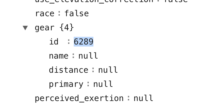

hi @david i think there is a bug in https://{{server}}/api/v1/athlete/{{id}}/activities?oldest=2024-11-03&newest=2024-11-10
The gear object is not populated correctly - it always lists the same gear.id and the other fields including name is null
You’re right, there is only the ID field being populated there. The rest are in the “gears” endpoint.
If you set a default gear, this will default to that gear.id each time.
If I do want to list the gears, I would match it. What I do is get the gears from the gear endpoint and match it with the gears ID on the activity.
Screenshot 2024-12-06 at 8.21.15 AM
edit: Read some of your earlier post - What you’re wanting to do, i don’t believe the current endpoints supports it. There is a # of activities, but AFAIK there is no linkages to the actual activities that are using those gears.
I suggest using the list view for your purpose. And then using the Filter for the gear that you want
if you notice on the bottom, there’s already a helpful total for dist and time.
It’s not so much a bug but undocumented behaviour :slight_smile: Only the gear id is filled in for performance reasons. If you need the full gear object you can make a new call to the list gear endpoint.
