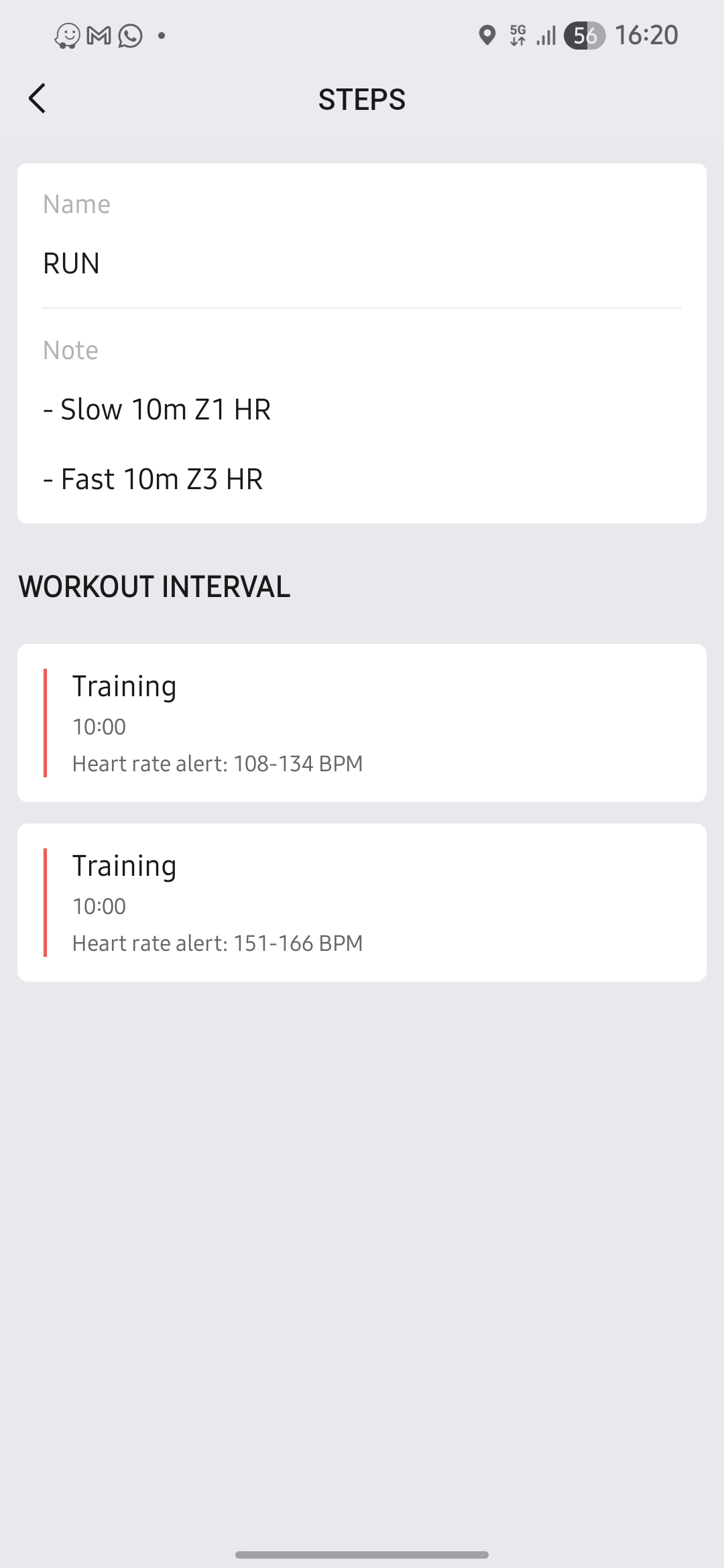

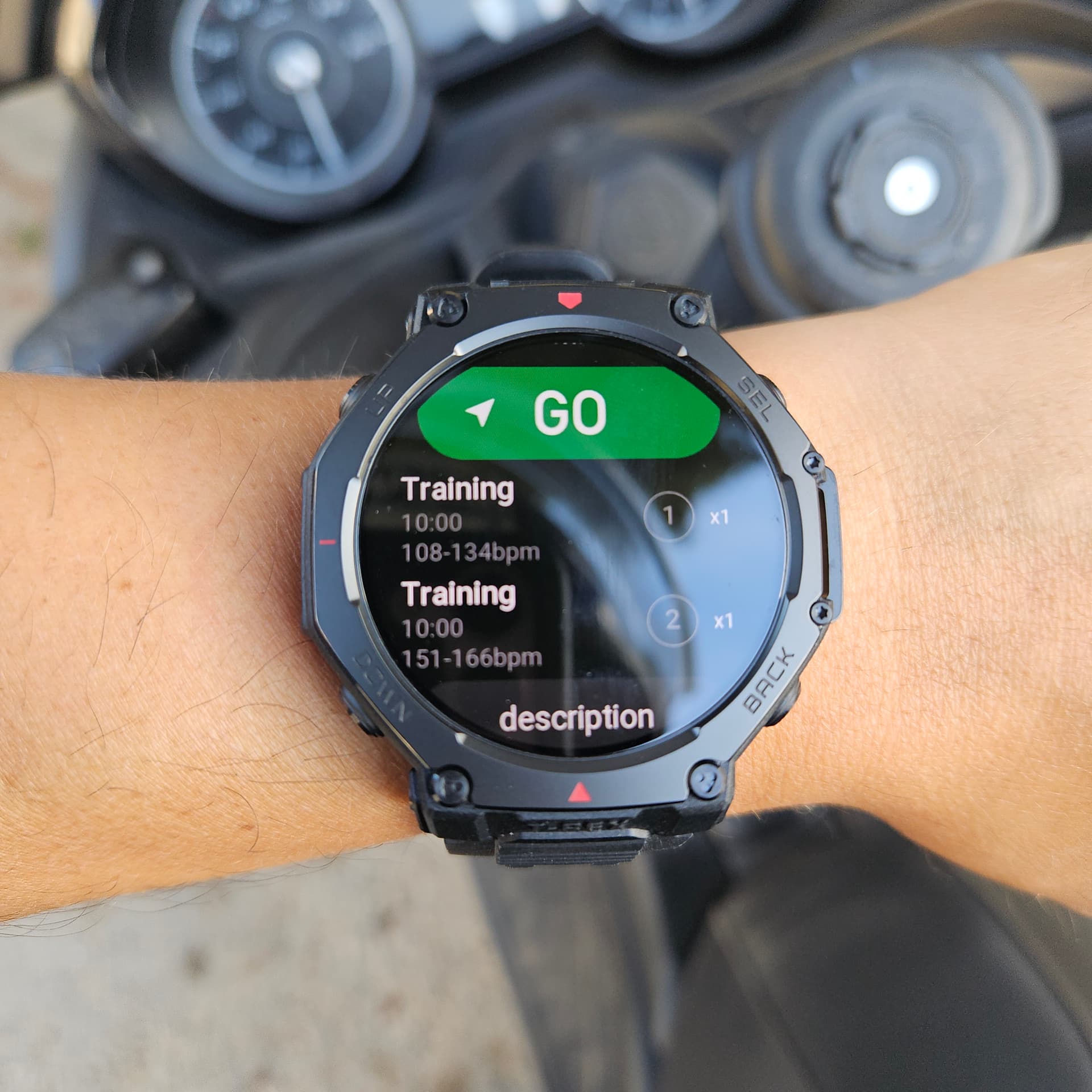

Good afternoon @david,
I am not sure whether it is from intervals side or amazfit but all the intervals are displayed as training irrispective of what text I write to be displayed in each section. Shall I email Amazfit?
I am not quite sure what you mean? Could you please post some screenshots or other info and link to an activity with issues. Tx.
Yes sure. If you see I created a session with two intervals. The text to display in interval one should be slow, and the 2nd interval fast, but instead it just shows training on the watch
Yes it looks like this is a Zepp issue. I have verified that Intervals.icu is sending through the name of the step:

I will send this in, but you should also report it.
I will. Thank you for confirming.
Zepp have just told me that they have fixed this issue.
