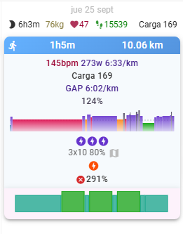

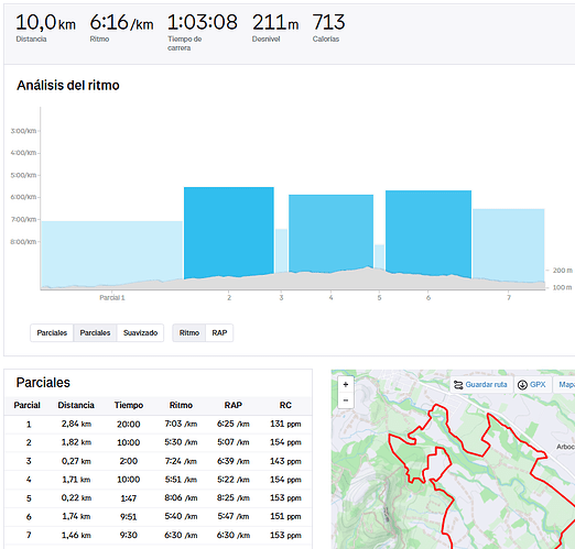

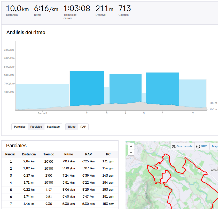

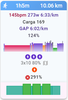

Hi, I see that Intervals.icu isn’t detecting the training intervals on my device (Balance 2). I created the workout with Zepp (currently, it’s not possible to sync planned workouts from ICU to Zepp).
However, I’ve been checking and Strava does show up and correctly detect the intervals.
I’m showing screenshots to improve my explanation.
*Here we can see how it does not match and does not auto-detect the activity intervals with the planned training.
*Activity result on Strava
In case you need to consult the activity, I leave the ID: i98918025
There is another post mention this. It seems that Zepp doesn‘t provide laps for intervals, but does it for strava.

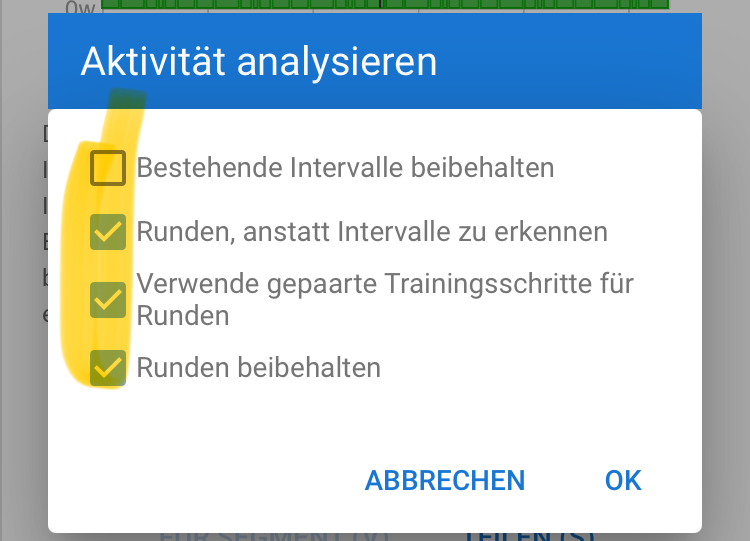

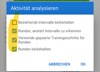

2 If there are no laps, use your workout as laps: Action → Analyze → Check the “Use workout steps for laps” and uncheck all other checkboxes.

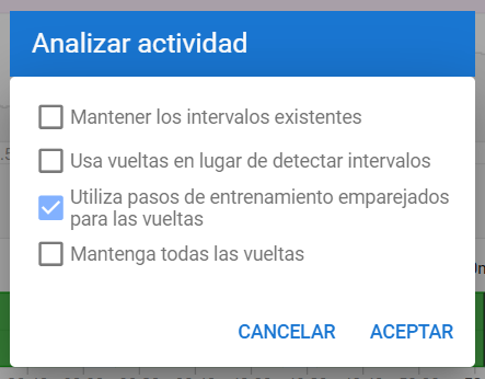

  2. Action → Analyze → Check the “Use workout steps for laps”
Result:
I try diferents options from ‘Analyze’ and no one works fine for me.
Ok, I had to use the bottom three options to create intervals from the workout

The above checked options require a planned workout to get you the result you’re after!

Again, if you have a workout, select the three bottom options, and they should create intervals your workout steps. If you have no workout, that won’t work obviously.
