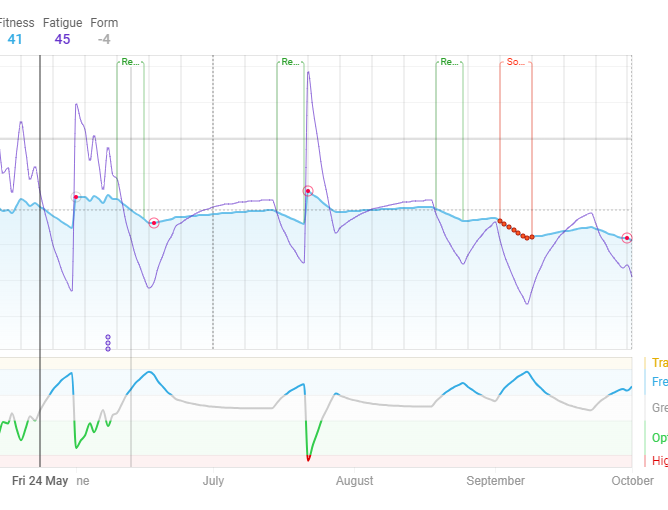

If you look at the screenshot of my fitness I had this big ride which i started fresh and put me deep into the green (my first metric century). I actually did not feel to bad after and continued training, One week later I felt really tired in the legs.
I put it down to accumulated stress of the big ride and then the training. Tried to push a bit because my form line was starting to go towards fresh, but my body told me to stop and rest,
My form is in fresh now, but I feel like I will need to rest a few more days.
Further into the future my planned training load of 400 does not even move me into the green anymore.
I understand the mathematics behind it, but practically I cannot use form as an indicator of when to take breaks and when to push anymore.

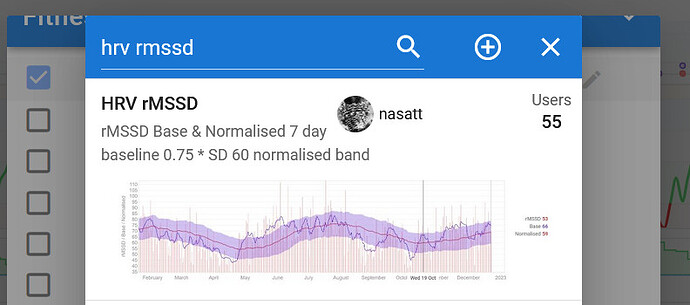

There are charts you can use available as shared charts on Intervals.icu such as the one shown below
