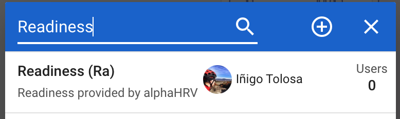

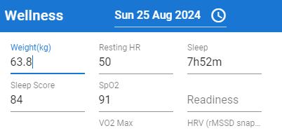

Is there a way to sync this to intervals? It appears as if the “readiness” field on the wellness tab is something different, at least it does not provide the score. I also sync some snapshot data from GC but this readiness score does not.
Anything I am doing wrong here or is it currently not possible to get the score automatically?
thanks
alfred
You can use the activity field Readiness (Ra)
couldn’t find it before, many thanks

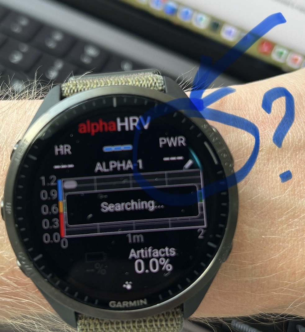

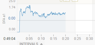

btw: during yesterday’s ride, the app crashed immediately after that 20min, no recording of data (alpha1) afterwards.
No idea what happened, have you, or anyone else, has experienced this as well?

I occasionally had a crash but not recently.
To quickly recover from those, create a dummy profile on your Garmin device with simply one datafield (not an IQ field). When an IQ field crashes, go to the home page, change to that dummy profile for a couple seconds and then go back to your activity profile. The datafield will restart and you loose only a couple of seconds data.
ok, thats interesting and good to know, will try it if it happens again.
thanks
Crash just at 20 min is an issue that I fixed some versions ago. Check if you are up to date. If not, update. Otherwise, let me know it so that I can investigate
had the update from 19.Aug and updated yesterday after the ride to the 31.Aug.
Ok, let me know if it happens again

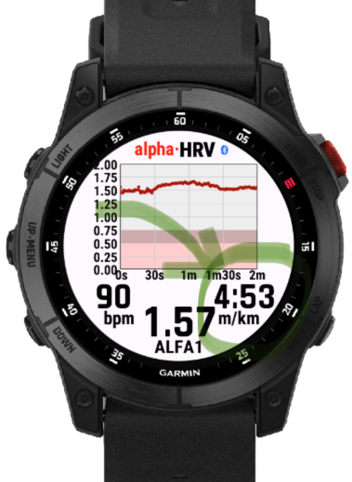

Hi Inigo, I have a question regarding the user interface: in the Garmin IQ store there are screenshots suggesting that on the head unit I would see Power metric, on Watches I would see Pace metric among others. I installed the App on my watch as a field in my Running AND Cycling and on both I have only Power metric.
Question: if it is possible to adjust the AlphaHRV App Fields according to activity type? Thanks in advance!
You can select power or pace (among others) to be displayed in the auxiliary field. To do that, use the data field settings.
Just to be on the safe side, I’m talking about the AlphaHRV app interface only.
Me too. Go to settings and select Pace for auxiliary field
Thank you! It is not on the watch, but in the the IQ Store App… took me time to understand :slight_smile:
On the previous post - Readiness (Ra) field - is it still there? Couldn’t find it…
Yes, it is as described above.
Be sure you are running an updated version
