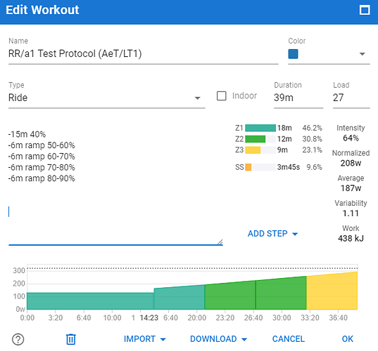

Do you have a specific protocol we should adopt for evaluating AeT with the new update and RR/a1?
A ramp with 10 % FTP increase per 6 min is what Luisma and Inigo are using per this post:
Start with a very low intensity steady step at 40% and if you only want to test AeT, you can stop at 90-95% FTP.
Thanks @MedTechCD - I might try this in the coming days. Would like to get a better estimation of my LT1 that I currently have
Just make sure to use a ramp and not steps!
From 50 to 90% would be a 24min ramp.

Now I’m confused. Inigo is saying steps and you are saying a ramp. Also I’m not sure what the =3s means. Is that 3sec average on the Garmin?
There´s a bit of confusion posibly caused by language barrier. But I´m quote sure.
This post confirms
New AlphaHRV version - #20 by Luisma_Gallego_Soy_P
Earlier in the thread this was shown:
I’d just like to be clear that we are on the same page re terminology. I’ve always thought that was a step test.
