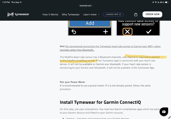

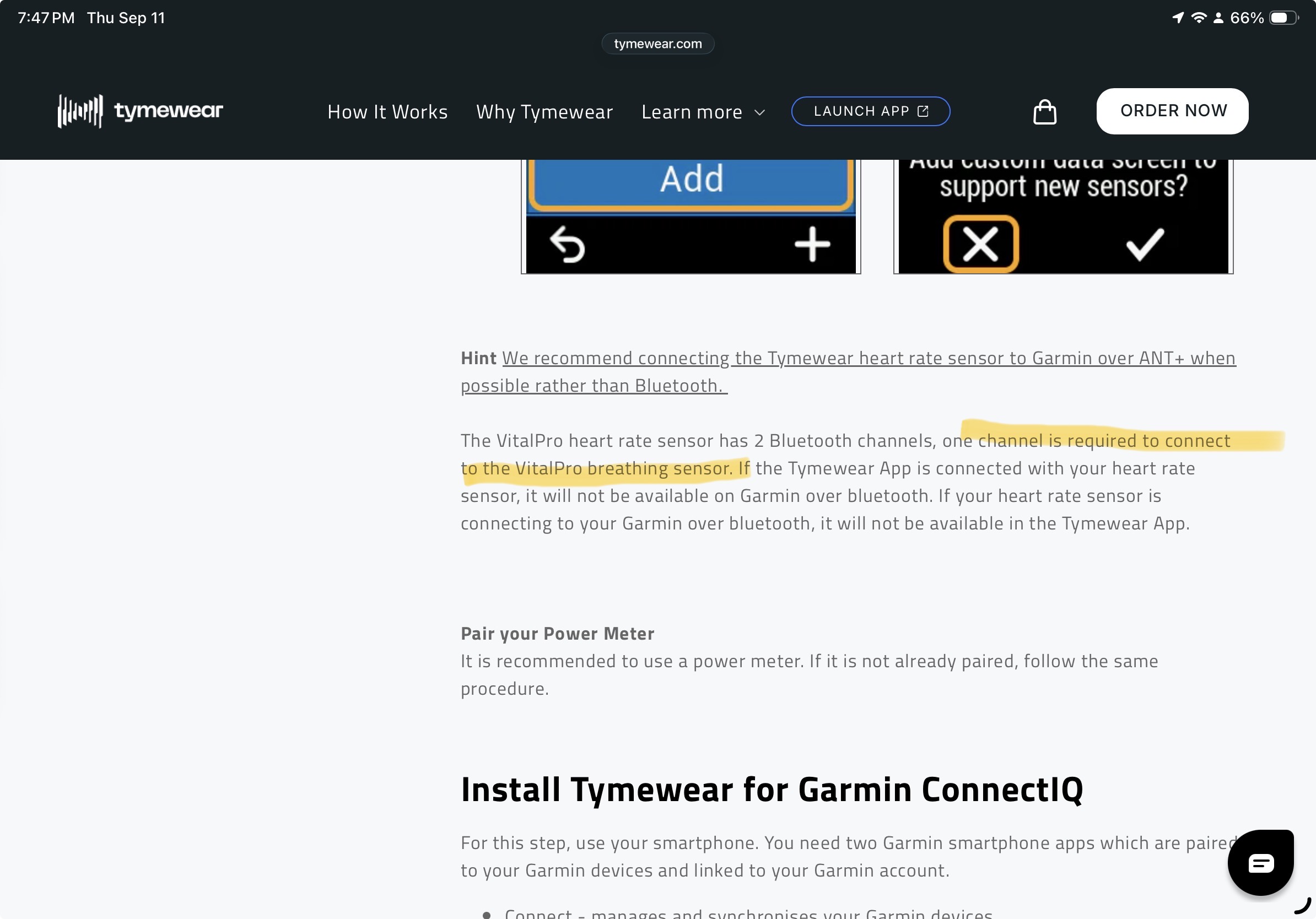

Ah OK! I’ll give it another shot. My Edge was only showing it once via BT/BLE, no ANT+ sensor seemed to be reporting. Also it does seem that it supports only one BLE connection at a time while the Polar can be configured to allow two which is useful sometimes.
Did that work well for your? Here, it says the HR monitor uses one BT channel to connect to the breathing monitor.

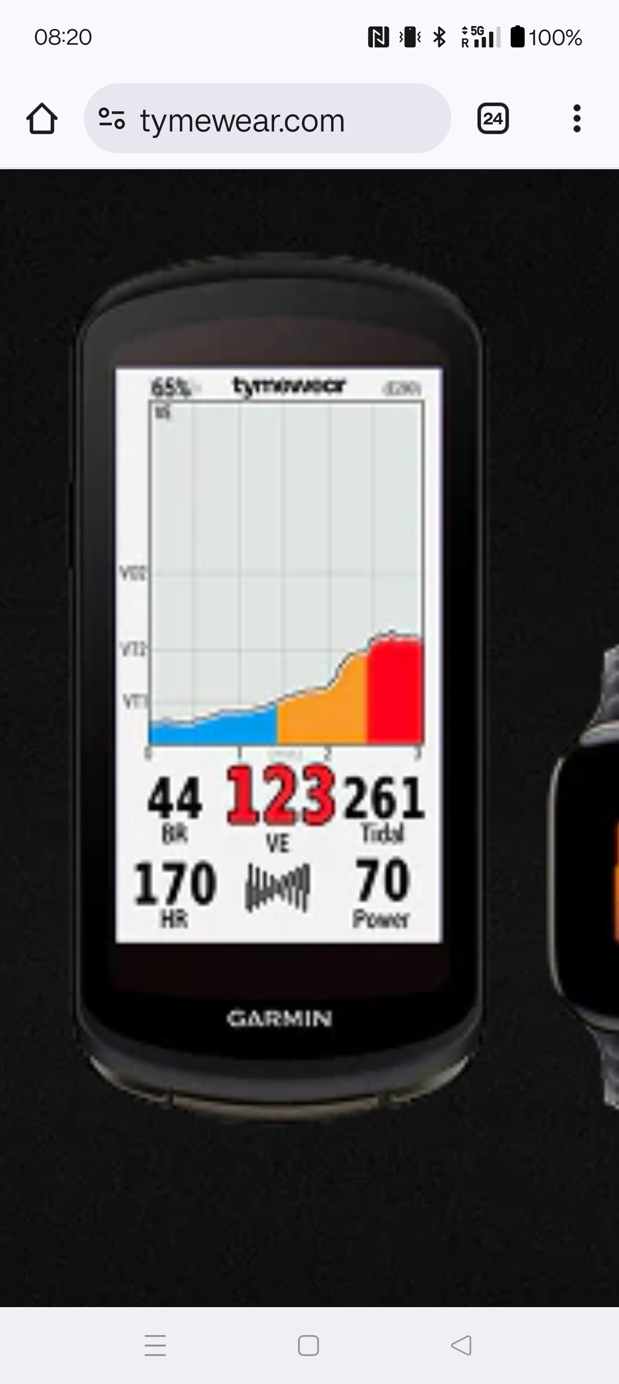

Slightly off-topic, but it would be very interesting to hear some feedback on Tymewear. How convenient is it to use in real-time with the intensity readings for the VT1-VT2 zones? Do the readings align with DFA (Alpha-1)? And overall impressions – is it worth it? I ordered one mostly out of curiosity for new gadgets.

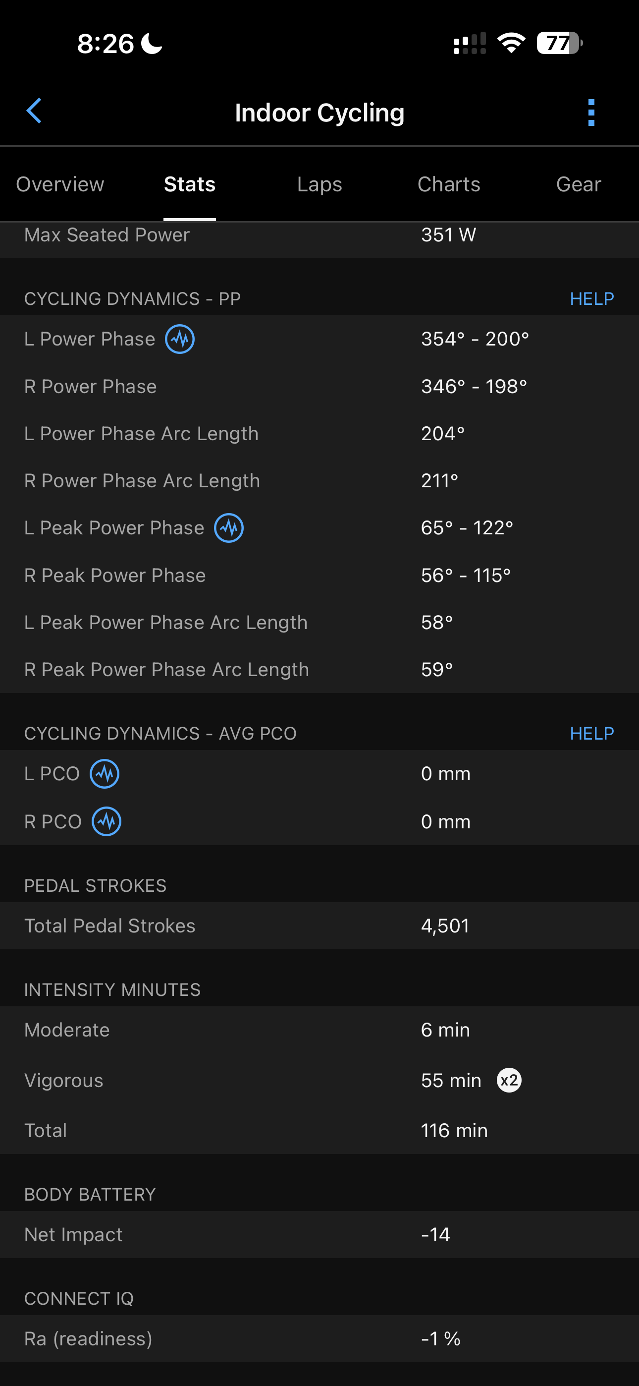

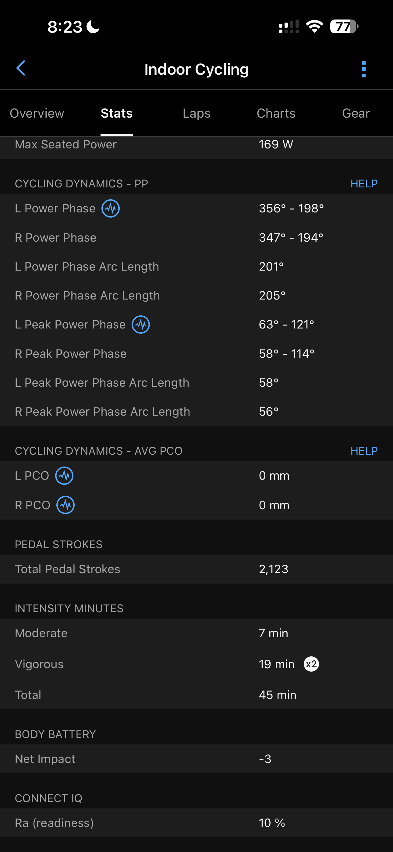

On Saturday I did a 100km ride (about 3 hours)
On Sunday I did a farly high intensity trail run (75 minutes, tempo run with lots of hill climbs)
After the above Garmin reported nearly 4 days recovery time - a bit high but 2 to 3 days was reasonable. I was tired.
On Monday I wanted to do 30 minutes Zwift recovery ride (Garmin advised a full rest day). I felt awful - heart rate shot up immediately and I struggled to keep up with the pack, while normally on that ride I’d be low Zone 2 heart rate wise. Alpha HRV reported a +10 Readiness!
Today (Tuesday), I had a good nights sleep and felt well recovered so did another Zwift ride. Heart rate was decent in relation to power output, Garmin was reporting + performance condition (meaning power / HR ratio was above my usual levels for my Vo2Max) and I got an FTP increase. AlphaHRV thought otherwise and went -1RA

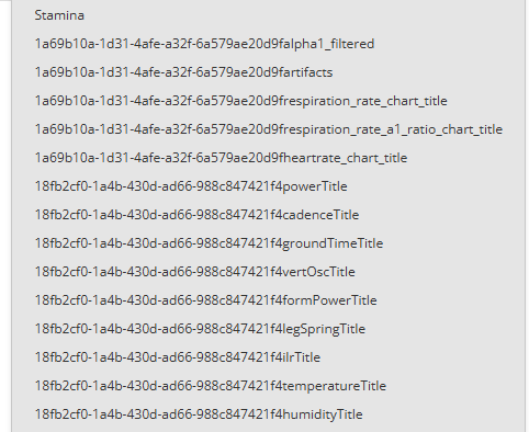

Hello, looks like in Garmin graphs the name of the AlphaHRV fields are all messed up how could this be? I checked few activities and they look the same.

The update shouldn’t have erased permanent data saved by alphaHRV in the device.
Anyway, maybe some of the activities are not usable and you need some more in order to accumulate the minimum required days.
Let me know if it is shown after a couple of activities more.
