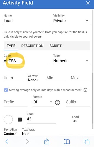

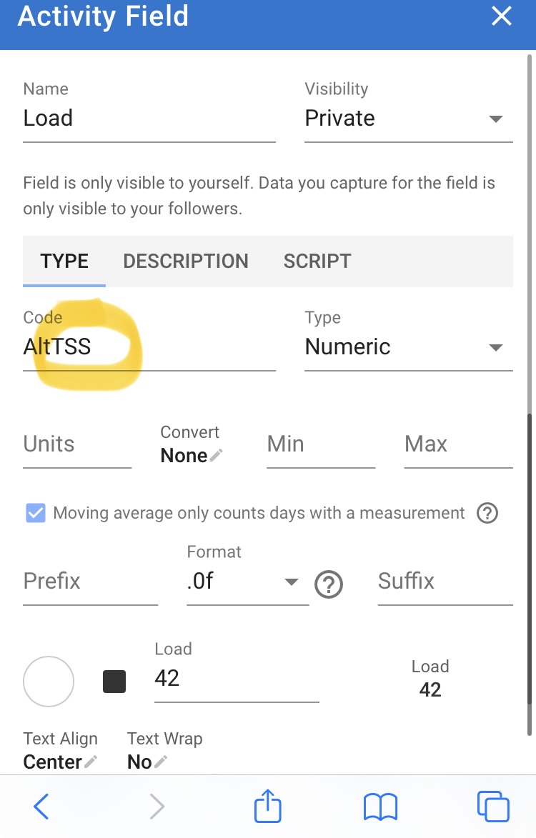

Thank you very much, @R2Tom . You are so helpful. I can certainly do this, Yippee.
So, imposing on your patience again: if I replace the line
activity.icu_training_load = tss/36
with
activity.icu_training_AltTSS = tss/36,
then I will have both the original load [TSS] and this new datum [AltTSS]?
Incidentally, where does the /36 come from?
And to get a new fitness graph based on AltTSS, then I just have to wait until I have enough new days for the graph to make sense and make a custom chart with the appropriate moving average functions?
If you don’t want to replace original load, just replace it with
data = tss/36
The division by 36 is conversion from seconds to hours multiplied by 100.
You have to create a Name and Code-Name in the ‘Type’ Tab and can use this in a custom fitness chart
You can re-analyze activities of the last 8 weeks and you will get appropriate numbers.
Hope this helps ![]()
