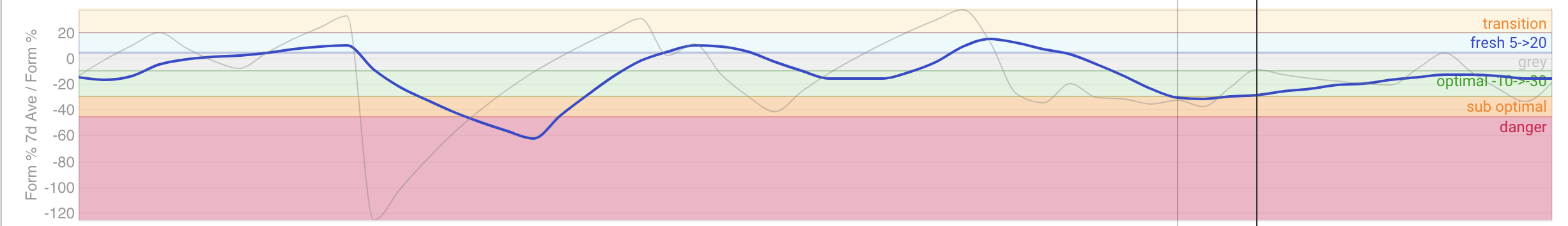

As @R2Tom has pointed out, you can show your form as a percentage or an absolute difference between fitness and fatigue. If you have a low CTL/fitness, and you’re feeling tired with it set to the absolute difference, then setting it to the percentage setting might be better. If say, your fitness is 30, then the absolute form setting will want you to keep your ATL/fatigue at 40 - 60, 50-100% more load than you’re used to, but if you have it set to percentage, the optimal zone will be in a more realistic, 33-39 range, 10 - 30% more than you’re used to.
If you have a fitness of >100, then the reverse is true.
Try swapping between the two settings and see if one shows you in the green to red, and the other in grey.
You could also just try making your own optimal zone for form which suits your age.
I have a custom chart that shows the %form in light grey and the smoothed/7day average %form and I aim to keep that line in the green zone. But the green zone could be set to whatever I choose. I find the default 10-30% is sustainable.
You can see I let the line get into the blue before a big walk a month ago then took a week off for the line to get back into the green and then, whoops!, didn’t quite get back into exercise as soon as I should have and then whoops! again, got sick, but in general keeping the line in the green is sustainable for 60yo me.
