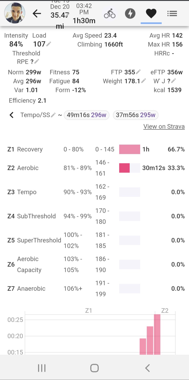

I’ve been really trying to make the most of structured training this year over the winter months.
I have been quite disciplined with my riding and getting a lot of endurance and tempo in where I can.

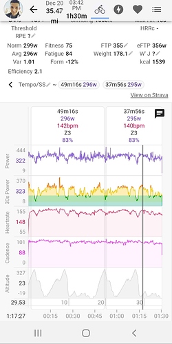

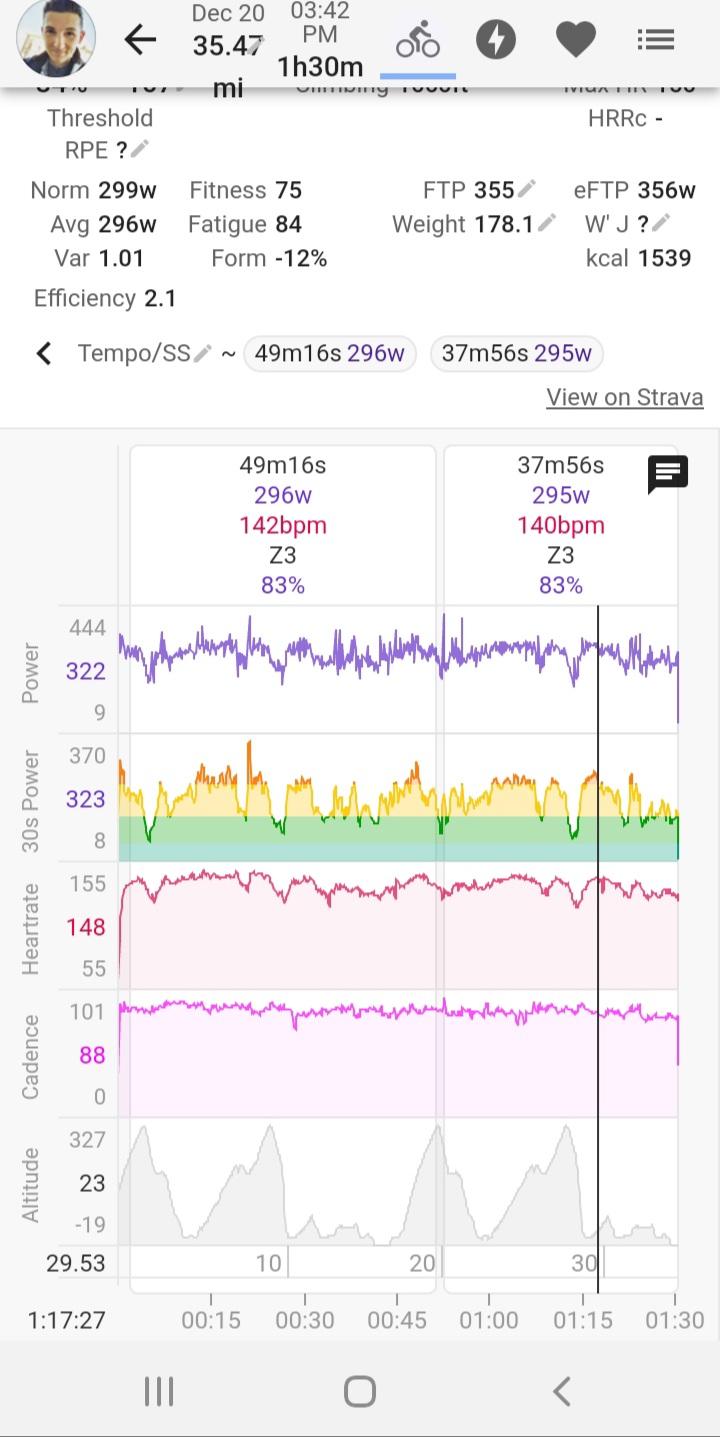

I’ve been doing some tempo/ss rides recently and only just looking into 'decoupling '. If I’ve done this right I have -1% decoupling over 90min ride.

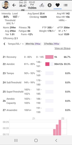

In order for me to keep building my aerobic fitness, is it sufficient to carry on in the same way (working z2/tempo/SS)? Note, that for this effort in particular 67% of time was spent at z1 HR, with the remainder in z2.
I’ve done a lot of reading, im wondering if now I would be better off riding my long endurance rides (3h+) by z2 HR rather than power?
How would you proceed in my position?
Thank you.
