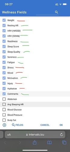

Is there a way of recording nor.ing resting HR on intervals?
Here is everything that comes through from HRV4Training (green is updated automatically, red requires me to select):
