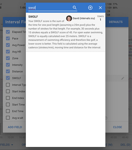

Added SWOLF activity and interval fields

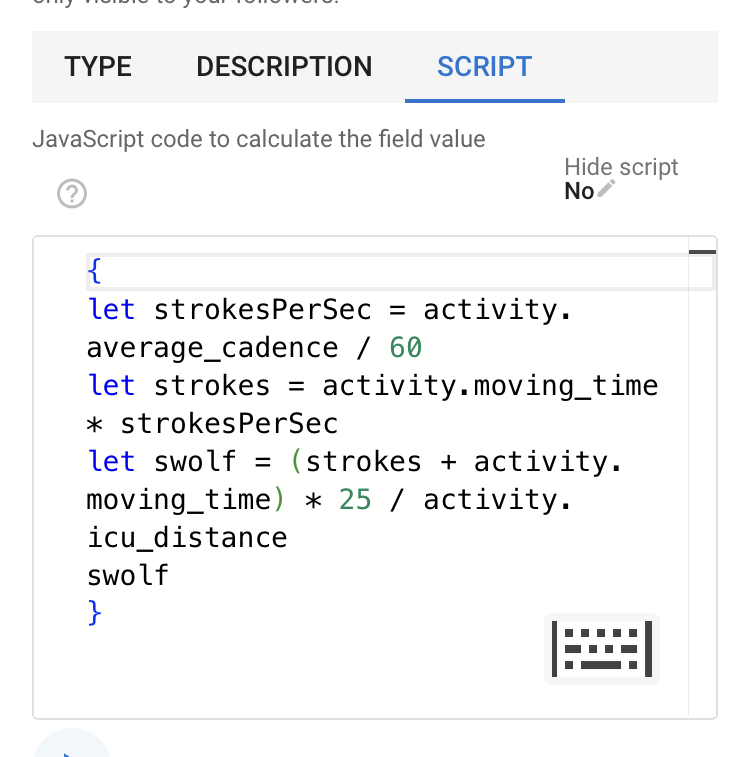

There was an enquiry about calculating SWOLF for swims. I did a bit of googling and it seems SWOLF is calculated per 25m (strokes + seconds). So for the whole activity the SWOLF calculation looks like this:
let strokesPerSec = activity.average_cadence / 60
let strokes = activity.moving_time * strokesPerSec
let swolf = (strokes + activity.moving_time) * 25 / activity.icu_distance
swolf
I have added public custom activity and interval SWOLF fields using this calculation. You can search for SWOLF:

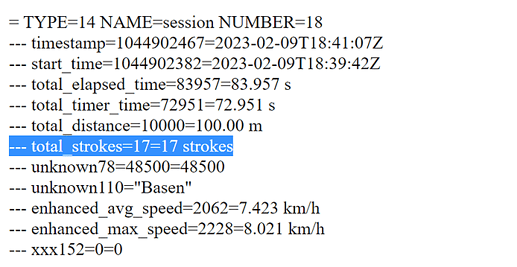

totals strokes can be find here:
Unfortunately total_strokes is on the length records in the file I looked at (your swim from 9th Feb). What I don’t understand is how swimming cadence is calculated. One of your lengths from that swim:
total_elapsed_time = 56.469
total_strokes = 47
avg_swimming_cadence = 56
How can avg_swimming_cadence be 56? Strokes per minute = (47 / 56.469) * 60 = 49.93.
I took other lengths and also there are differences in average swimming cadence. I’ll google it and will try to find out why there are differences.

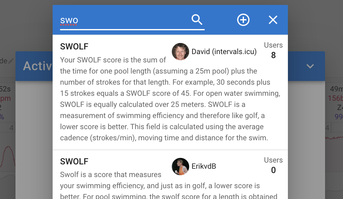

Hi, Can’t find SWOLF?
You need to click “Custom” under the activity timeline chart and then the search button:
It’s a field that is calculated for each activity. You can also click “Fields” and the search button to add it as an interval field.

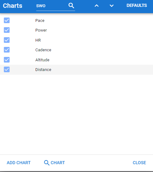

Hi David,
i want to see the total_strokes in my diagrams.
I used this code:
let strokes = activity.total_strokes
strokes
But nothing showing. What’s wrong here?
Marc

Hi David, since SWOLF is calculated using 25m, when I swim in the long-course 50m pool, the SWOLF on intervals is shown as half of what it should be. Is there a way to adjust SWOLF for the pool size (50m vs 25m). Additionally, sometimes the SWOLF is shown as a “?”. Why is this?
You can change the „25“ with „50“ in the script tab (or with the pool length „icu.activity.pool_length“ variable if available)
If any of these variables are not available, then the result is „?“
