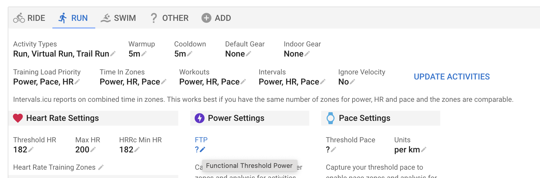

is there a way to add eftp automatic calculation for running.
i cycle and i have been recently running as well .
i want my cycling eftp/ftp unaffected and have a value for running.
If you capture an FTP value and power training zones for running that will enable power analysis including eFTP.

You need to capture an FTP here (just guess to start):
That will enable power analysis for runs, including eFTP.

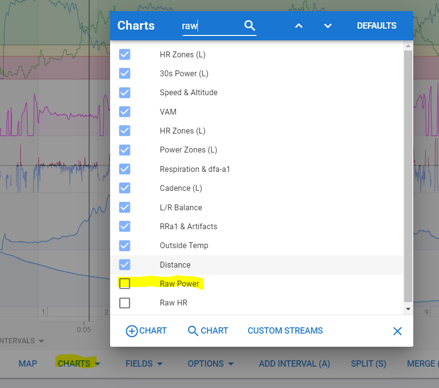

On the activity page add the chart ‘RAW Power’ which will show unmodified power from your device.
The screenshot shows a steady state effort. If this was an all out effort, use the average from the RAW power as FTP. If it was a tempo effort, FTP should be even higher. You can also set the Power Spikes adjustment way higher. Like 80% for example. This will cause no problems if your power device works perfectly.
