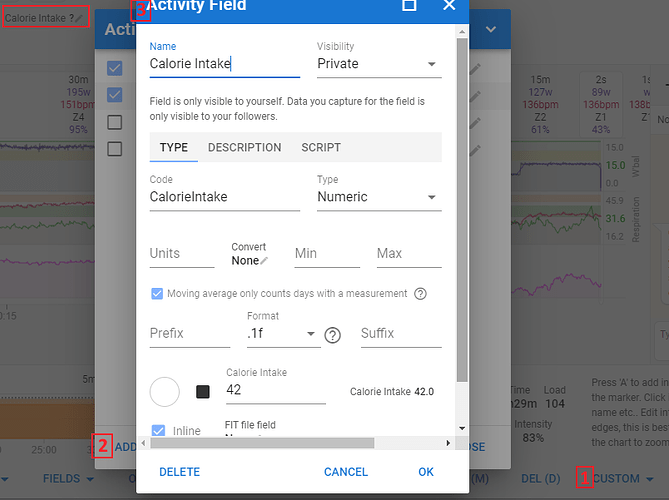

Make sure youâre adding the correct type. There are a few different spots you can add fields.
The workout one is under âCustomâ - âAdd Fieldâ
