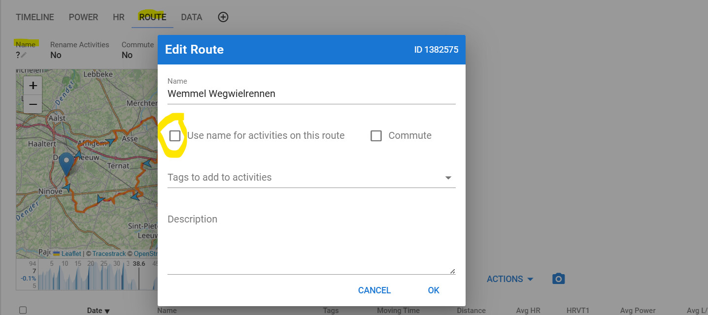

Did you define the route from the first ride?

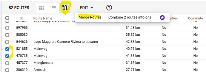

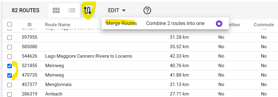

If they are only slightly different, you can also ‘Merge’ the routes to make them detectable as the same route.
No I haven’t. Do I need to do that for it to automatically detect them?
This would defy the purpose of the feature, no? They’re not different at all. Did the same route twice.
Yes, once you have defined the route, the next one will get the same name, tags and eventually the commute flag as per your settings.
Go do that for the first one and your second one should reflect that if you re-analyse.
If you happen to do the same route often with only minor differences, then you can merge those that are not detected equal and the differences will be ignored, making it auto-detected the next time.
The start and finish points of those routes are far enough apart for them to be considered separate. As MedTechCD says you can merge them so they are considered the same in future. Route matching was always going to be too fuzzy for some people and not fuzzy enough for others. So I went with “not very fuzzy” matching and manual merge.
You do not have to edit the route and give it a name etc. for matching.

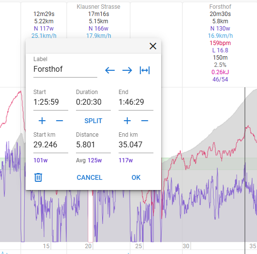

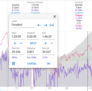

when you say you create your own segments on Intervals, are you doing this by labelling a section of the ride?
And this section is recognised every time you ride it? Or is it recognised only when you travel the same route?
I am curious as I have a number of labelled sections and these are not automatically recognised in Intervals. Do I miss something here or how did you do this?
thanks
Ciao,
as you say you can give a label to your segment as you showed. Unfortunately it is not recognized for other activities, you have to rename it for each workout, it is not automatic. It is a request that I made to the developer, but to date it has not been implemented, because it seems to be under Strava patent
