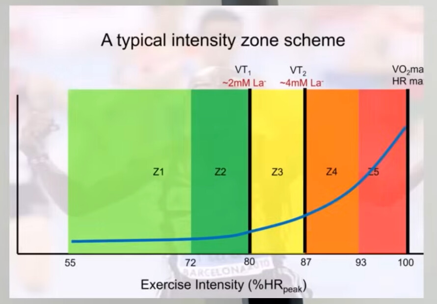

But that guy also posted an incorrect chart, more specifically a chart where the lactate threshold is below zone 4. It is not, at least not if you define zone 4 to be below threshold. Well, that’s kind of circular logic, but the point is that the lactate threashold/VT2/RCP is what draws a line between aerobic and anaerobic work.

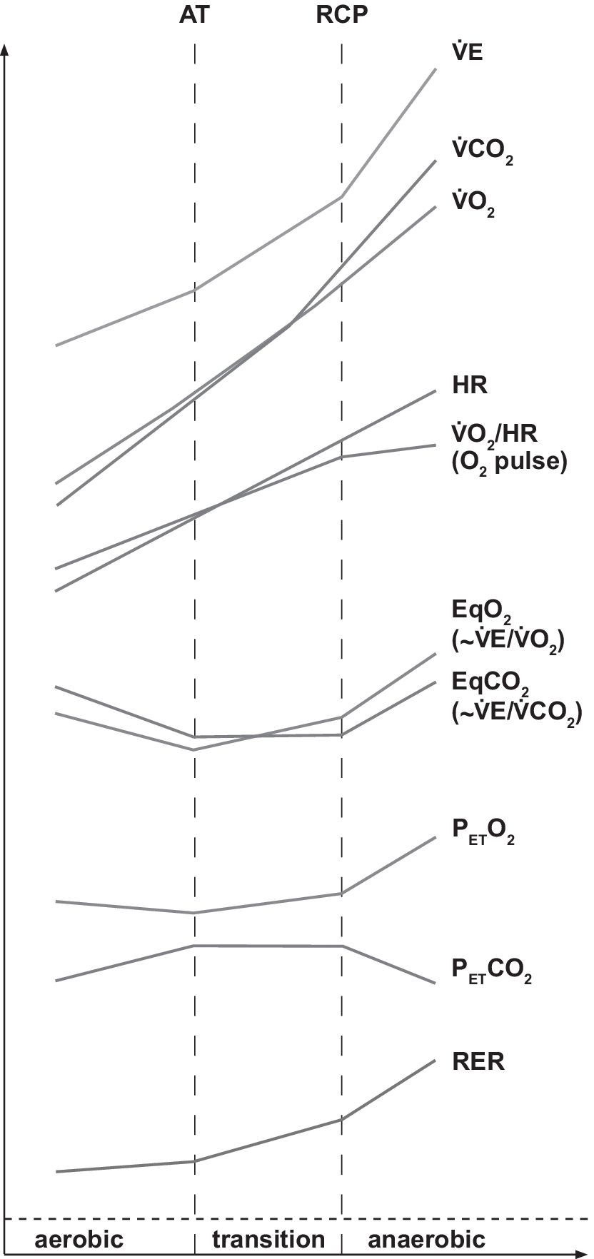

It’s not only lactate which defines this point, there are also other ventilatory parameters, e.g. the end-tidal carbon dioxide pressure (PETCO2) drops here, see for example
Of course you can label each zone whatever you wish, I mean zone5 can be z5-z7 or z5a-z5c, but you cannot post things like this chart:
This chart would be correct if VT2 would be above Z4, and not above Z3.
