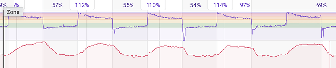

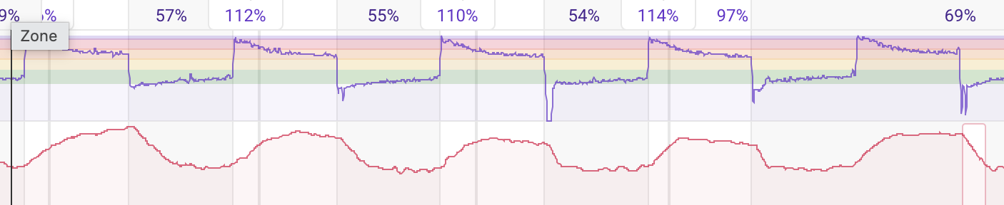

When I was fitter than I am at the moment I found hard starts really useful. Xert has several, and because of the metrics they use it starts high and reduces smoothly. May be possible to make something close to that with enough segments, rather than a simple ramp. Part of a completed workout here: (5 min intervals)
