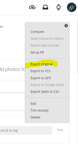

For manual workaround, download the original FIT file from Garmin Connect or Strava.
For Garmin, you can find it behind the gear icon on an activity:
Strava also provide the original but can’t post screenshot because I don’t use Strava.
