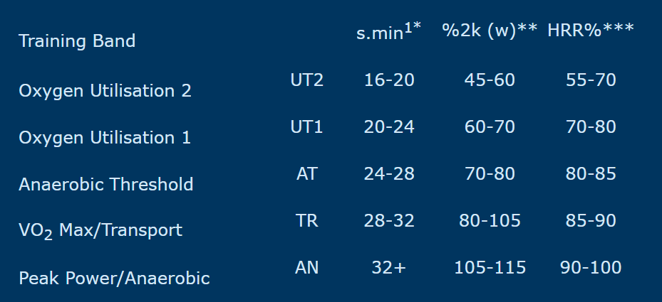

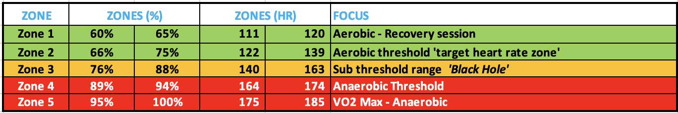

I am struggling a bit to find proper training zones for rowing. I found these:
From training zones | thestumpyrower
However, these zones are based on % of 2k time trial.
Basing the zones out of those for rowing would probably skew the load calculation for the rowing activities.

I’m not a fan of using HR zones to monitor my OTW rowing training load, given the variables that can impact HR during training….I lean into monitoring my Power (W) developed/maintained. That said, you may find this reference useful ( you may have to signup for his free newsletter to access) to answer your question: How to set up your heart rate training zones. (Premium access) - WH Chambers

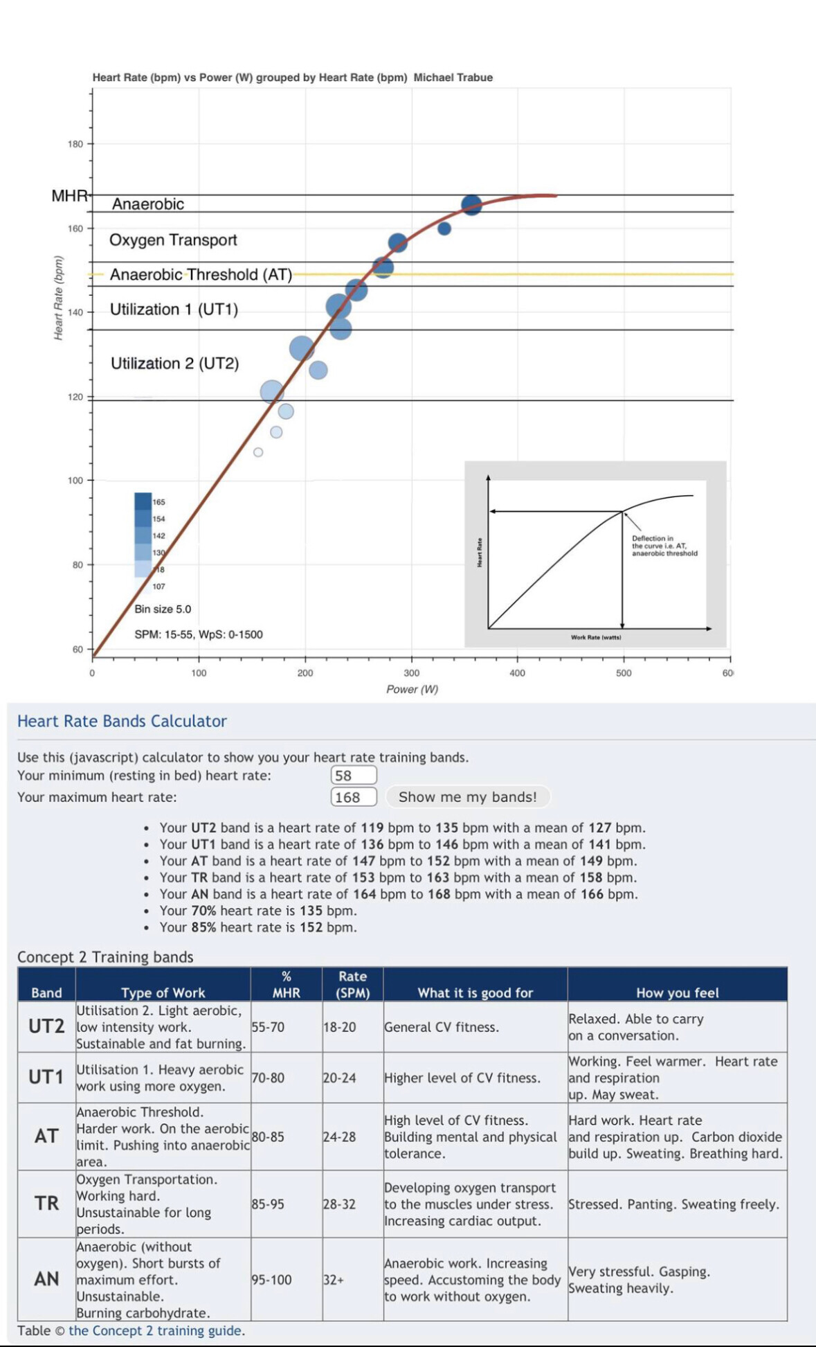

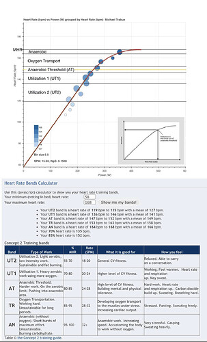

The attached photo (available via an internet search) illustrates the authors adaptation for rowing of the 5 Zone Polarized Model in the literature by Dr. Seiler. The photo illustrates the author’s adaptation to a 185 bpm max HR.

Although I subscribe more to Power (W) to measure/guide my workouts, and being somewhat data nerdish, I too decided to try to determine my Maximum Heart Rate (MHR) more accurately so I have another data point to monitor my training (especially now that I’ve turned 68 :sunglasses:). As of late, I have taken my test data and rolled it into the 5 Zone model.
Prior to last year, I had been using a MHR based on the formula: “[ 207 – 0.7 more precise formula, adjusted for people over the age of 40” (https://theathleteblog.com/calculate-maximum-heart-rate/). This formula recommended my MHR should be 160 BPM which I’d traditionally used for years.

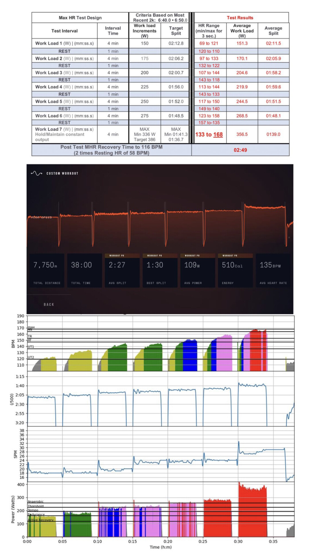

Additional research (https://analytics.rowsandall.com/…/whats-your-maximum…/; https://rowalong.com/calculating-maxhr/) affirmed to me the most accurate method to determine one’s MHR is an erg-based performance test…one designed using an erg rower. I chose Rowing Australia’s 7 step protocol, leaving out the VO2 max and Blood Lactate testing:
https://www.rowingaustralia.com.au/wp-content/uploads/2016/12/RA-7-step-rowing-protocol-2016-2020which -Update-4-Nov-2016.pdf.
Note: The test protocol states to use a C2 rowing machine, but I’ve found most rowing ergs operate on the same Power Curve (math is math)…ergs like the Waterrower just shows more Force and Power generated than the C2 if the two ergs were to be reading the same stroke. A Waterrower 2k completion time used as the basis for selecting the test interval workloads should require close to the same relative effort as you would exert rowing a C2, just the Waterrower Power/Pace targets will read higher….thus, you just can’t mix or directly compare the two……
My impression of taking of the Australian MHR test was its basically a 7x4-minute sub-maximal interval workout with 1-minute rest intervals in between. The only kicker is the last (7th) 4-minute interval is at an all-out maximum effort…basically a constant-applied power 1k race that was preceded by a good sub-minimal 30-min interval warm-up whose targets were based on my most recent 2k race time. At the end, I wasn’t on the floor (close to it), but I was definitely gassed………
The attached results at the time recommend to me a new MHR of 168 BPM. Of interest, my HR recovered to 2x my Resting Rate (116/58) in 2 min, 49 sec after the test. This “test” was a fun warmup workout for the 60 min recovery row that I did following the test. I didn’t “earn” anything with the 8 BPM MHR increase, just a little more knowledge….and, data to play with…….

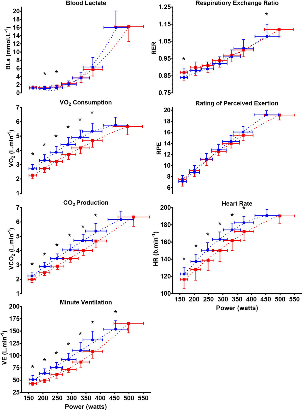

I did find one bike/rower erg power direct comparison study online (“Oxygen consumption and metabolic strain in rowing ergometer exercise” - published in the European Journal of Applied Physiology and Occupational Physiology · February 1986 -https://www.researchgate.net/publication/19430187_Oxygen_consumption_and_metabolic_strain_in_rowing_ergometer_exercise) that spoke of the efficiency of power production between the two. The following is quoted from the last paragraph of the summary of that paper (RE - Rowing Ergometer; BE - Bike Ergometer):
“VO2 of rowing was about 600 ml X min-1 higher than for bicycling in the submaximal stages for both groups. The VO2max of RE exercise was 2.6% higher than for oarsmen on BE, and the cyclists reached a greater VO2 on BE than the oarsmen. No differences were found between RE and BE exercise heart rate. The net work efficiency when rowing was 19% for both groups, experienced and inexperienced: when cycling it was 25% for cyclists and 23% for oarsmen.” I’m no scientist or exercise physiologist, but my interpretation of this study’s findings is their appears to be a 4-6% difference in Power production efficiency between erg rowing and biking with this test group.
What to do with those findings? ….I’m not sure…maybe adjust the well-used cycling power zone watts down by 5%? …I don’t know. I’m not that smart or knowledgeable to advise, but my guess is you would be ok to use the same Power zones as for cycling (Coggan is what I found on the Rowsandall.com site) as you continue your research ……my research also continues….

I use the zones on this rowing erg calculator on the CrewLAB website as a nice simple starting point. Concept2 Erg Calculator - CrewLAB

Two papers which I haven’t seen anyone link to yet:
https://www.researchgate.net/publication/345429652_Physiological_responses_on_the_Concept_II_BikeErg_and_Concept_II_RowErg_in_well-trained_male_rowers
As a rule of thumb I’ve seen people use +20-40w on the bike. There is also a great post on slowtwitch discussing Cam Wurf, where the Princeton lightweight coach (though I can’t find it now) gives the average % difference for his squad.
