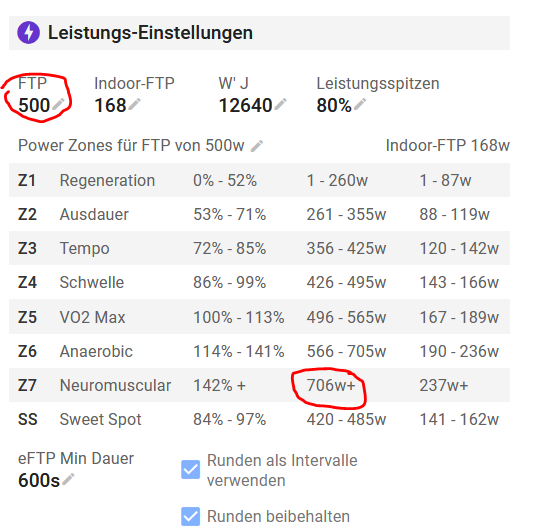

Zone7 makes workouts load too high
The zone7 being up to 2000w+ makes the load of the workout really high which then skews fitness and makes it hard to track things like ramp rate etc
I had to add a further (unused) zone to get round this. Interested to know if there’s a better way…
Why do you have 2000+ in Zone 7? Even if I enter a utopian 500 watts as FTP, I don’t get 2000+

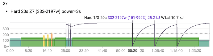

It’s the “up to 2000+”, not a set value of 2000+.

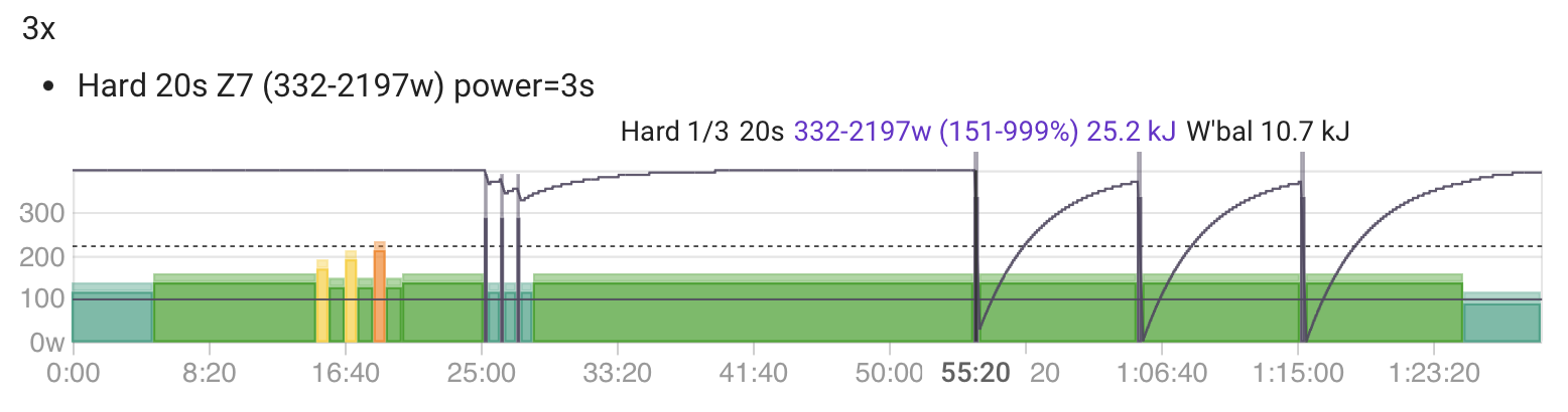

The top zone is defined as the percent given, up to 999%. 999% is over 2000 with any FTP over 200. The load is defined by the midpoint of this range. Which makes it difficult to plan with load when using it.

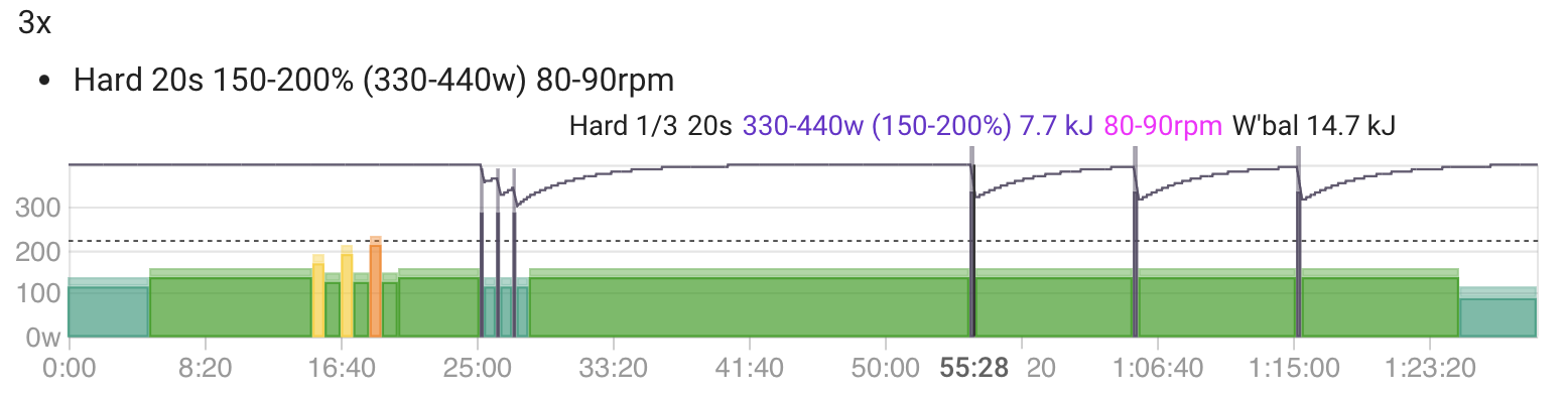

This screenshot from the workout builder is the example:
I think it’s probably a bit larger of a range than is needed. But there are always the possibility of outliers who have low FTP but very high sprint power.
I just use a specific percent when putting together my workouts that are going into sprint range. I set 200-500% for mine.

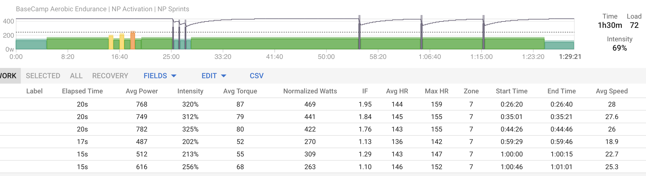

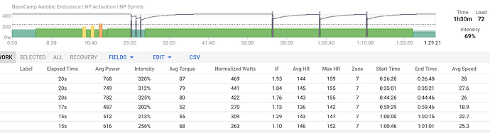

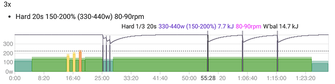

My actual 15-20 second sprints at 80-90% effort are in 600-800W. For example this workout
had a planned load of 72 TSS, using planned 3x15-sec at 135-175% and 3x20-sec at 150-200%.
Actual sprint values were much higher, while endurance was mostly in z1, and that resulted in 91 TSS vs 72 TSS planned.

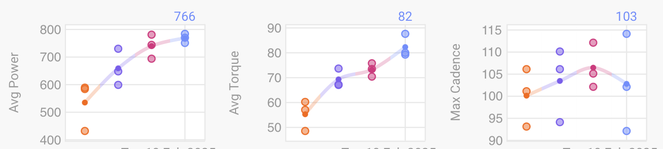

For what its worth, I simply go out and after a good warmup with some high cadence work, do some shorter controlled 15-sec jobbers as openers, and then later do a set of 90% efforts on the 20-second sprints. These benefit from some practice - a handful of controlled 70-80% 20sec efforts at the end of one or two endurance rides a week. And then I do 90% efforts about once or twice a month. The Intervals Compare Activities chart makes it easy to track progress, these 90% efforts were a month apart:
During base I’ll usually set new 90-day bests on each of the monthly scheduled efforts.

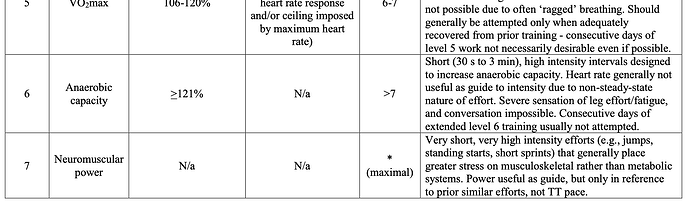

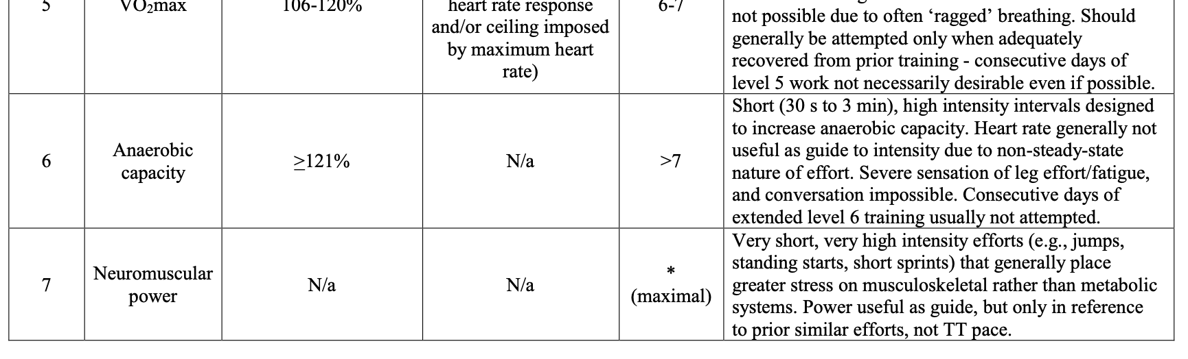

Background:

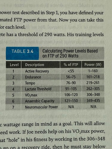

Andy Coggan created power levels / zones. Here is what he originally said in 2003 for Z7:
and in the latest Training and Racing with a Power Meter:
NOTICE THAT LEVEL 7, or ZONE 7, has NO % FTP and NO POWER RANGE.

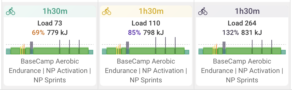

Problem:

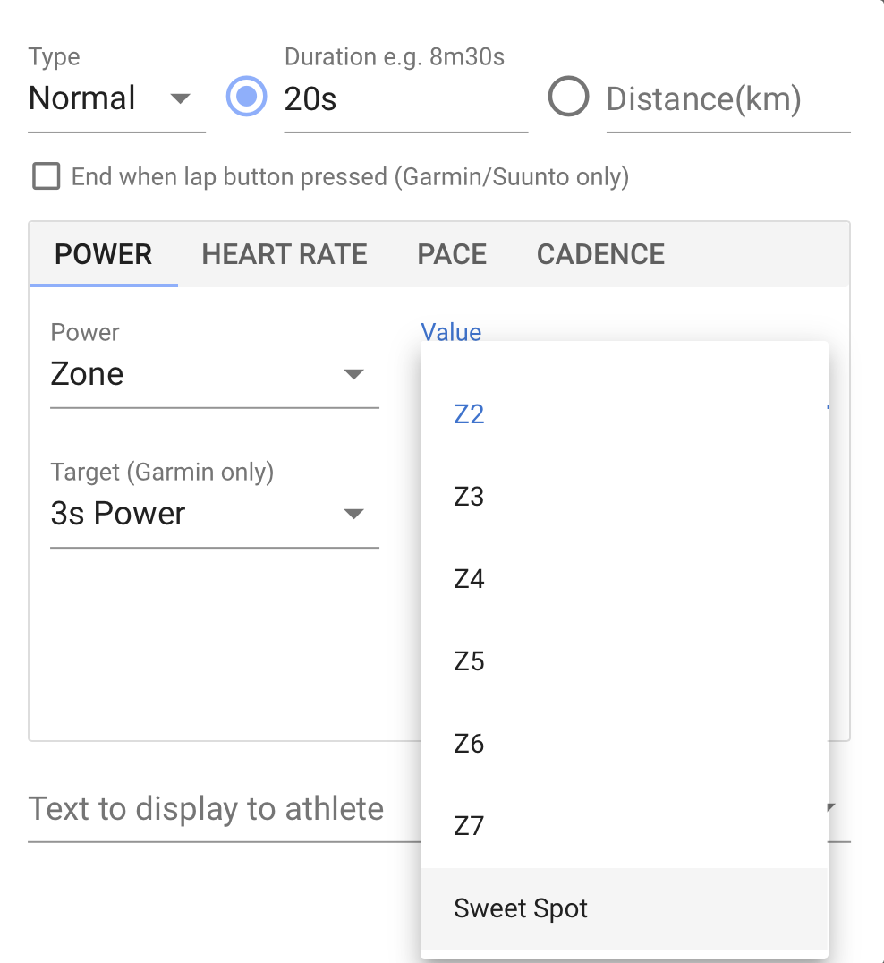

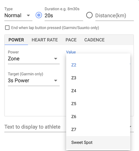

Intervals Workout Builder allows you to select Z7 to prescribe an interval. Which then creates this problem:
Load of 264 using 20s Z7 in Workout Builder
vs
Load of 110 using 20s at 285-350% FTP (my actual) in Workout Builder
vs
Load of 73 using 20s at 150-200% FTP (group coaching assigned) in Workout Builder
Good for planning (covers majority of users)
Bad for planning (unless you have a 1200+ watt 20-sec sprint):
