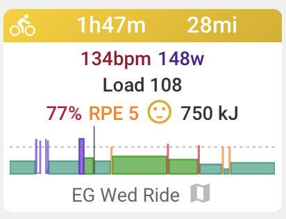

Last night was a ~2 hour group ride and
first warm ride, elevated HR from the heat and fitness drop, lighter winds, took a lot of headwind pulls for the slower riders
and by the end
“I was training too hard”
LOL
Back on the easy train and give it two or three months to push ftp back up from 190-200 to 250-ish. Finally starting to feel the recovery challenge of being in my early sixties…

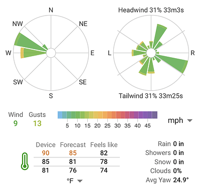

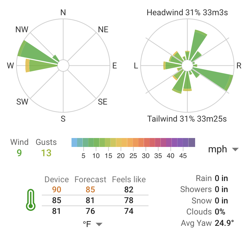

Is your device actually measuring windspeed and tail / headwind, or just based on local weather data ? That wheel / web plot is really cool.
its on Intervals, might be a supporter / paid feature.
here is data from a vineyard’s weather station about midway on the course:
temperature, dew point, humidity, wind direction, sustained wind, and gusts.
The Intervals data is close but not the same
I’m guessing its from another weather station, maybe from one of 4 airports in the metro area.
You can get that if you have the Weather info set (Options - Weather) and then click on the Weather info in the summary
