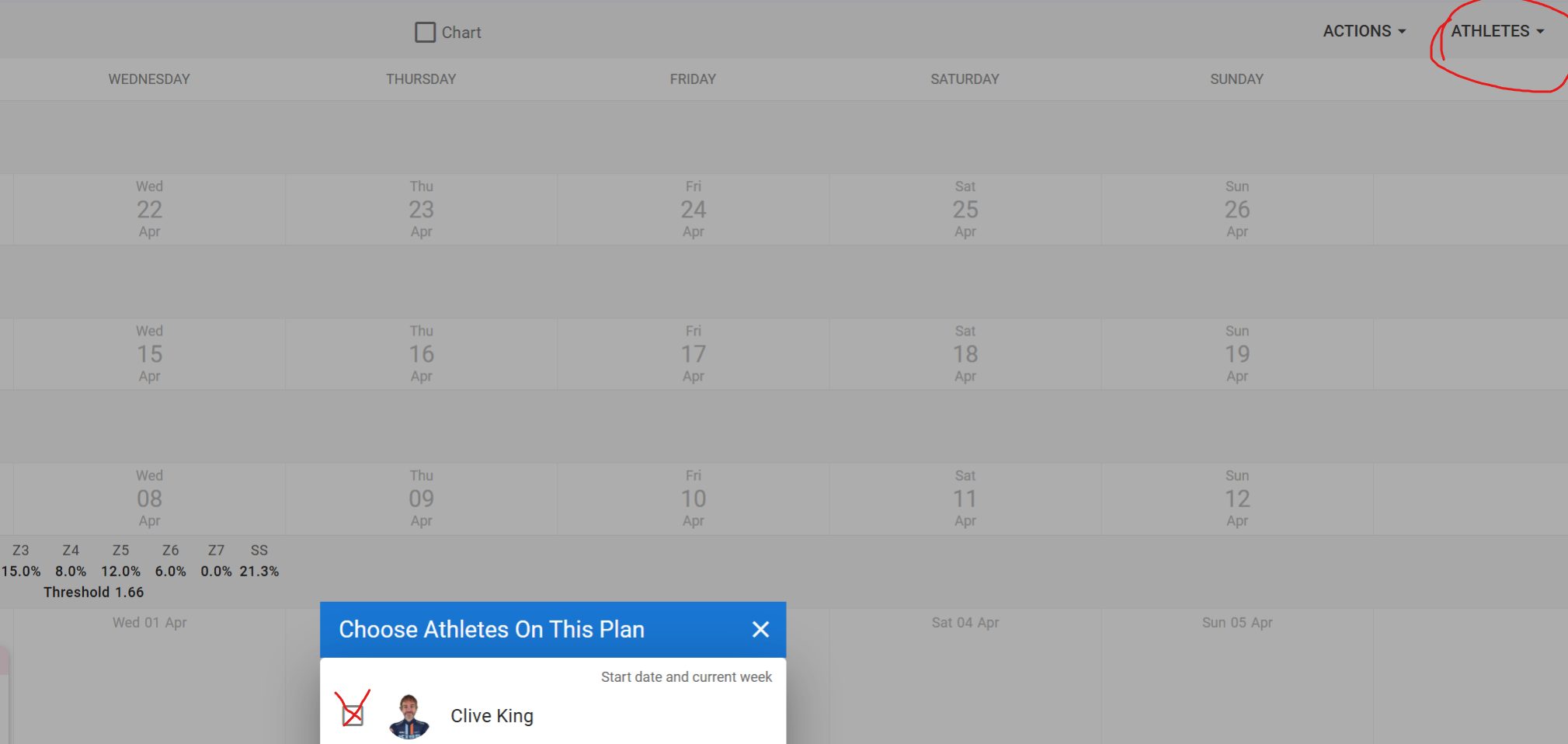

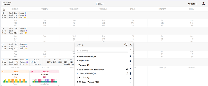

Yes, training plan endpoint is available but it’s not straight forward in intervals.icu to work with. Once you have created a plan you actually need to assign it to an athlete (yourself or someone you coach). Simply dragging the plan to your Calendar doesn’t assign the plan, it just adds the workouts as planned events. To assign the plan to yourself do the following:
  1. Open Plan:
  1. Assign it to yourself
  2. Then when you ask to show my training plan it will then show this.
Here is your currently attached training plan:

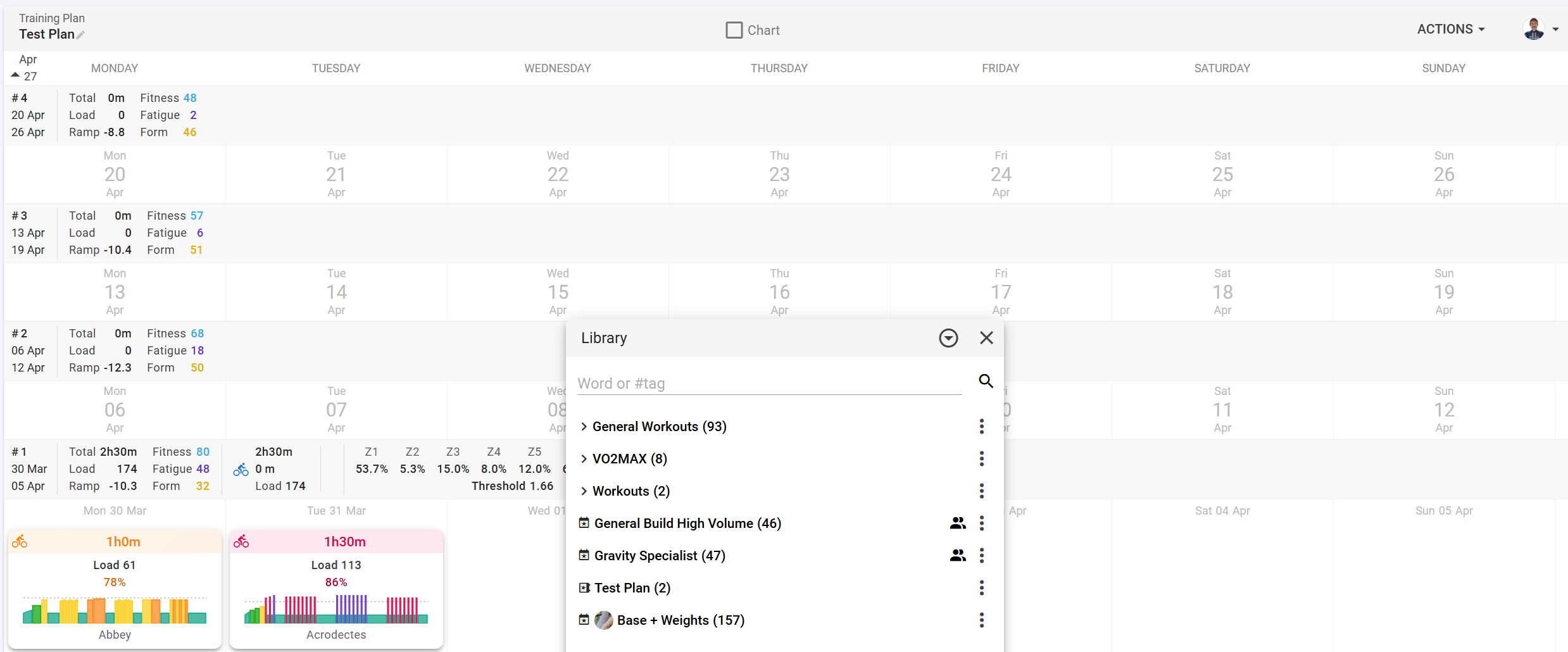

:clipboard: Plan Name: Test Plan
  • Plan ID: 726571
  • Owner: Clive King
  • Visibility: Private
  • Start Date: 30 March 2026
  • Duration: 1 week
  • Workouts: 2
  • Target Hours per Week: 3 hours
  • Activity Type: Ride
  • Primary Target: Power
  • Starting CTL: 90
  • Starting ATL: 100
  • Timezone: Europe/Zurich
This matches the two workouts already scheduled:
  • Abbey (Sweet Spot)
  • Acrodectes (VO2 60/60s)
There is no auto-rollout enabled, so the plan will not extend automatically beyond this 1-week block.
Regards
Clive

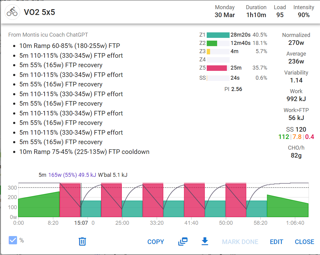

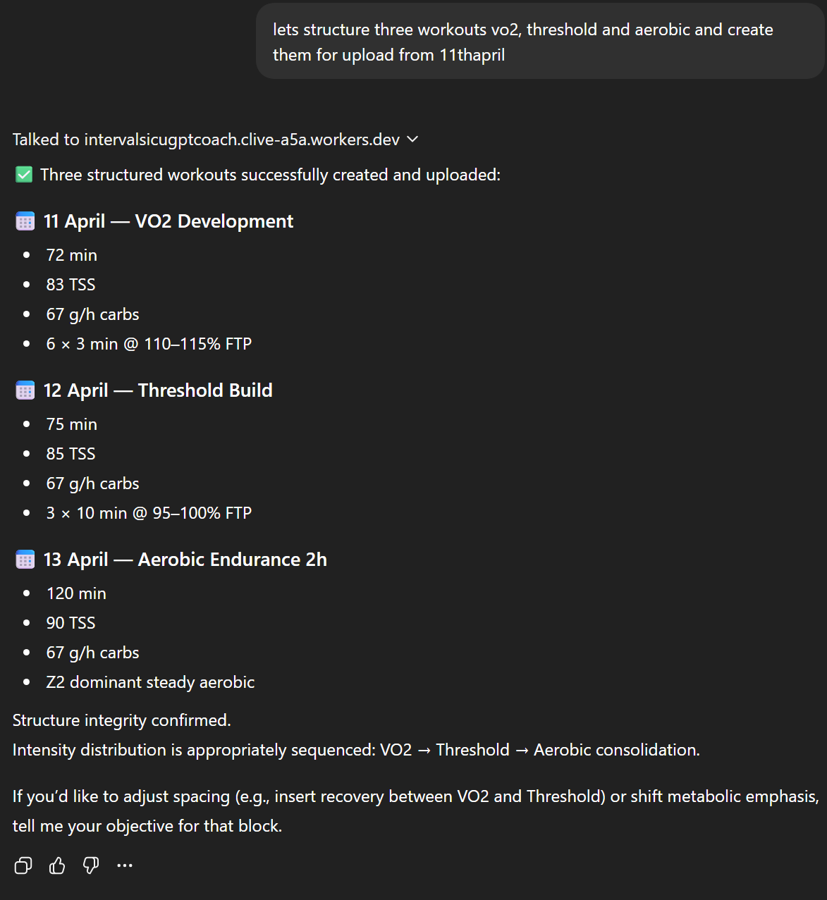

Thanks for the tips actually I was exploring plans shared by others on ICU and I find the UI a bit odd and difficult to use, but why not giving it a try for my next plan after my ‘A’ trail race later this month. Would Montis be able to help out build recovery weeks, then transition into a new plan? Right now I know my availability dates, I have couple of B and C races, and a draft high level approach provided by ChatGPT but nothing detailed at micro level.
Hi Alan,
I’ve added something simple for now where for a workout created it will calculate - carbs_per_hour (int g/h) based on the following. Unless you specify your own fuelling target in the workout request.
load_per_hour = TSS / (duration_min / 60)
Duration: A=<90 | B=90–150 | C=>150
Intensity: 0=<40 | 1=40–65 | 2=65–85 | 3=>85
 Int\Dur |  A  |  B  |  C
 0       | 35  | 45  | 55
 1       | 55  | 67  | 77
 2       | 67  | 82  | 87
 3       | 80  | 92  | 100
 Clamp 30–110.
It will then add this to the workout cho/h value
Hope this helps.
Clive

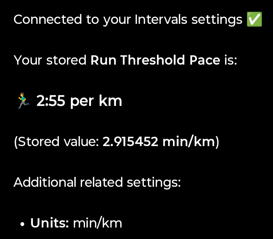

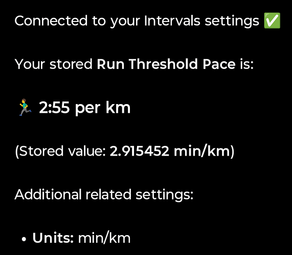

Hi Clive! It seems to me that the Threshold Pace calculation has reverted to its previous state…
I think I’m quite far from achieving the Olympic qualifying standard! :joy:
It hasnt in the reports, but i know why this has occurred and will need to put a measure in place in the short term as its an intervals API issue itself. I will raise a bug with David as the units do not match the threshold value coming from the API. This is the source of the issue. In the meanwhile enjoy your qualifying run :face_with_tongue:
regards
Clive
I’ve fixed it in our backend. Will need to raise an API bug. (EDIT turns out it’s not a bug but intentional, just misleading, units is as per UI value not API value)

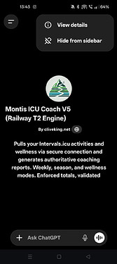

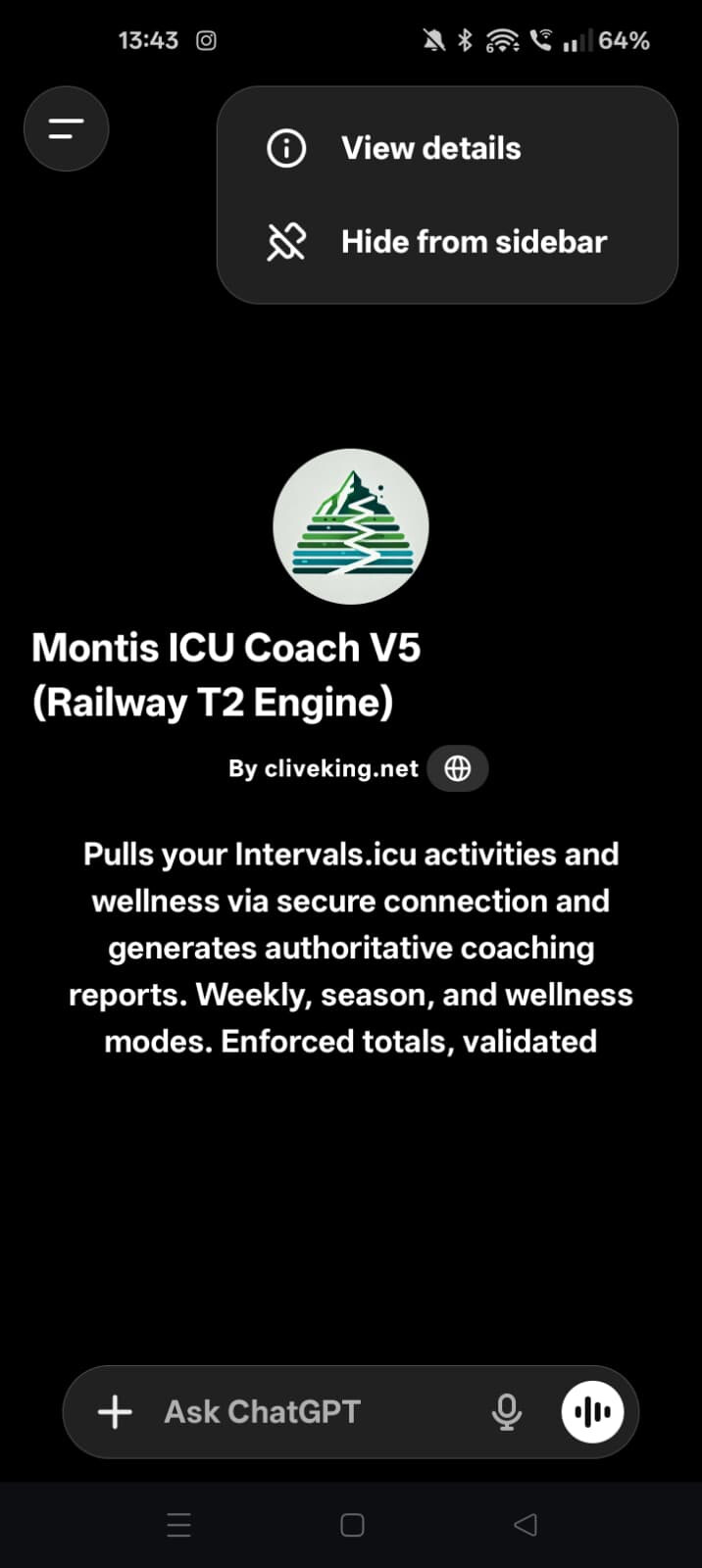

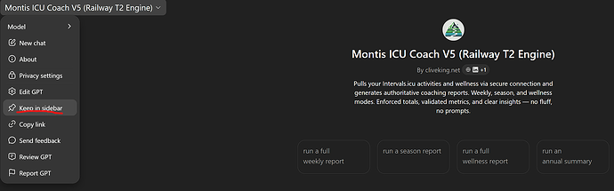

Hi GigiVa
I just realised that I omitted to mention you can PIN the GPT app in ChatGPT view by selecting “keep in sidebar” in Mobile app select … top right
or in web or desktop app via the drop down
you will then see it pinned under GPT.

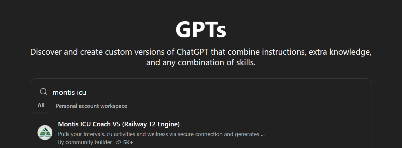

Hi! I’ve been using Montis for a bit now, and I’m loving it. :slight_smile: At the moment, it seems like has disappeared from ChatGPT, though, it says it’s not available anymore. Are you aware, or am I missing something? Thanks for your help in advance!
Thanks Cas, I still see it thankfully in search. Otherwise best place to find it is via montis.icu
and the direct link https://chatgpt.com/g/g-6933fc6bcd008191bb52885be4d1927c-montis-icu-coach-v5-railway-t2-engine
Dont forget to PIN to sidebar, always easy to find then in mobile app, web or desktop app.
Clive

:bar_chart: Derived System Metrics
Metric Value Interpretation
Glycolytic Bias Ratio 1.52 Moderate anaerobic bias relative to threshold
Aerobic Durability Ratio 0.82 Good endurance durability
Durability Gradient 0.94 Sustained power stable over long durations
System Balance Score 0.84 Balanced multi-system development
VO₂ Reserve Ratio 1.20 Healthy headroom above CP
PDR (5-min reserve) 58 W VO₂ capacity above threshold
:high_voltage: Critical Power Model
Metric Value
CP 294 W
FTP 300 W
W′ 15.6 kJ
Pmax 689 W
Interpretation:
  • Critical Power and FTP remain closely aligned.
  • W′ reserve remains healthy for repeated supra-threshold work.
:compass: ESPE Adaptation Summary
The current training phase shows a clear endurance-focused adaptation pattern:
  • Aerobic durability and long-duration power are improving strongly.
  • Threshold capacity is progressing moderately.
  • VO₂ and anaerobic systems are temporarily down-regulated due to lower stimulus.
This profile typically appears during aerobic consolidation blocks, where training prioritizes:
  • long steady endurance
  • threshold work
  • fatigue resistance
:white_check_mark: Bottom line:
Your physiology is currently shifting toward an endurance-specialist power curve, with improved fatigue resistance and long-duration output.

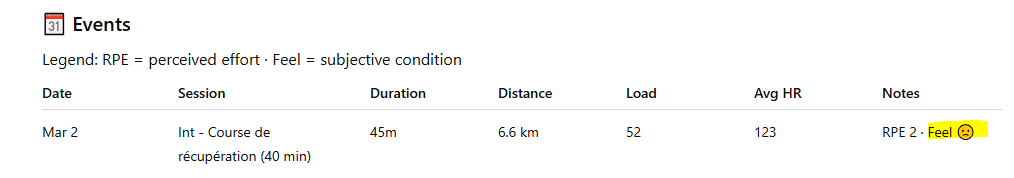

Hello Clive,
Any reason why all my runs from last week are showing :frowning: smiley?
I checked in Intervals and the Feel column is showing :slight_smile: (Good).
I don’t know if this is taken as input by the model for the AI Coach to provide feedback? (I’d expect it would, like a real coach would do?).
In term of documentation on your site, I would also love to see more sample prompts to start discussions, or prompts to explore specific aspects. I find that beyond the first structured report output based on e.g. “run weekly report”, then discussion feels a bit more like generic ChatGPT? Or maybe I don’t use the Agent in a proper way to unleash its full potential that’s also possible forgive me.
Hi Ohmax,
Yes, it reflects your “feel”. Sorry i got the reference back to front, my bad. Now fixed
“feel_emoji”: {
5: “:disappointed_face:”,
4: “:slightly_frowning_face:”,
3: “:neutral_face:”,
2: “:slightly_smiling_face:”,
1: “:grinning_face_with_smiling_eyes:
Regards conversation starters ; sadly ChatGPT limits these, and I need to find a way to be more creative to get the next question prompted as part of final coaching note. There are some very handy questions for example (listed on website) Montis.icu Coach — Physiology-Governed Endurance Intelligence - Questions. It’s something that’s been on my mind to help Athletes get the best from app. Will explore possibilities some more.
Clive
