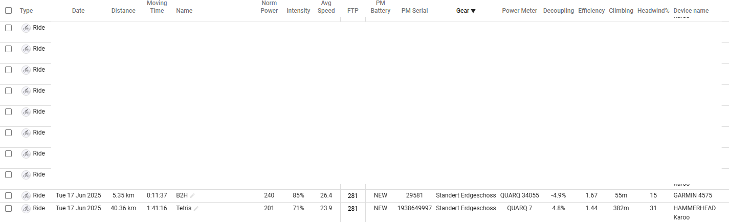

I recently got a Karoo 3 in addition to my Garmin devices. Everytime I ride with the Karoo 3 my ride files only report that I have power meter “QUARQ 7” instead of the correct ANT ID (I have different bikes with different QUARQ powermeters). I have set up my bikes in the gear panel to also recognize the PM Serial but this does not seem to work either. I need ODO alerts every 300km to wax my chains - this has worked beautifully so far with my Garmin devices but doesn’t ever since getting the Karoo 3.
Could you fix either intervals to read the correct ANT ID from the Karoo files or fix the PM Serial input in intervals.icu?
edit: I have to add here that using the PM serial alone to recognize the bike does work. It just doesn’t work in conjuction with another parameter to recognize the bike. So the feature request just revolves around having XOR choice for parameters to recognize the bike within intervals.
Thanks in advance for your support

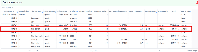

You can check your files from Karoo on
https://www.fitfileviewer.com/
Take a look, if the ANT ID is written to it. Maybe you have to filter for serial number in future.

ANT+ID != Serial Number
It looks like Garmin encodes the ANT+ID and the serial number, but karoo only encodes the serial number.
This seems to be a karoo thing rather than an intervals thing.
since both reports the serial number, you can switch to using SN to differentiate

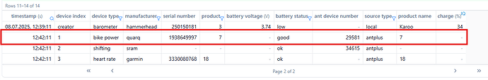

I don’t think that’s what is happening. Take a look at these two files:

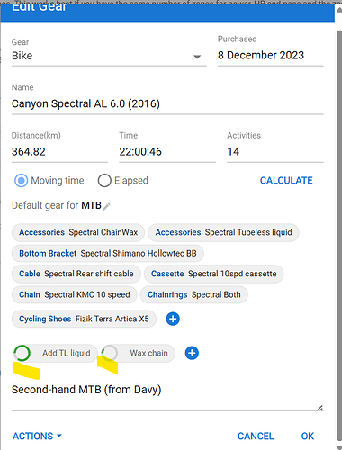

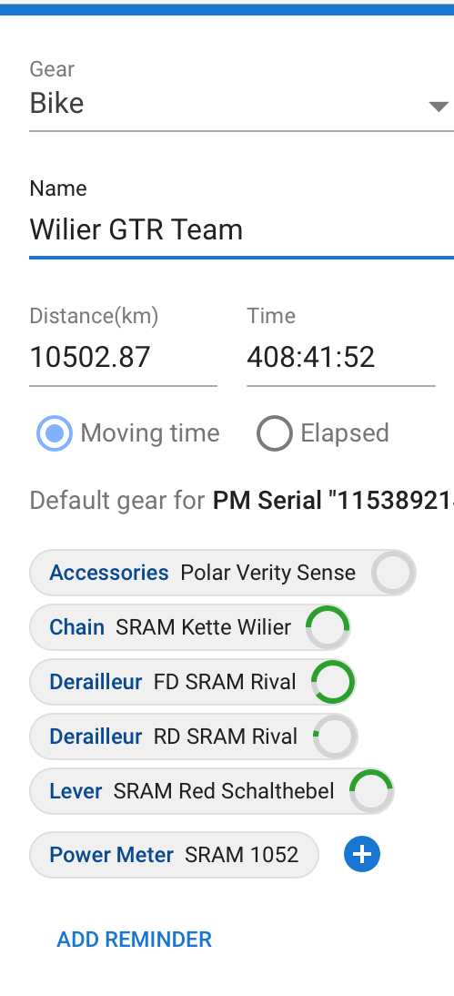

setting the PM to serial does not work. I have set it up like so:
does not get recognized from my Karoo files this way in intervals unfortunately.

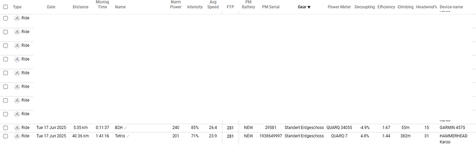

completely ignored that statement. The SN in the files from the Karoo 3 and Garmin don’t match! That’s one of the reason why my approach is not working.
But it is not the same. Karoo reports 29851 as “ANT device number”, but Garmin as “serial number”. Garmin reports “ANT id” as 84636557, which is not found in Karoos file.
I think the problem is, that they report different serial numbers …
Im seriously getting confused.
The 2 files you provided, are they actually the same or different power meters? (I tot they are different, hence the diff serial numbers and such)
It would be great to have the same PM paired to the Karoo and Garmin so you know what is what and what’s happening.
yes I agree. that’s exactly the problem. I can’t get files from the Karoo 3 to automatically set the right default gear using the serial number showing up in the activities feed.
It seems to be different how Garmin and Hammerhead report the ANT IDs, serials or device names but it seems to be a bug in intervals.icu, that you can’t set the default gear to be either X or Y or Z. Maybe this doesn’t apply to the majority of people who don’t use several different GPS devices?
I edited the post above to hopefully make it more clear. Yes, it’s the same sensor connected to different devices, Karoo 3 and Garmin Enduro 3. The devices serial get reported differently from Karoo to Garmin - hence why it shows up differently in intervals.
But in my mind intervals should be able to set default gear with different identifiers. This would be an easy fix without having to touch how the fit files get interpreted. But that does not work for me or maybe I’m doing it wrong?

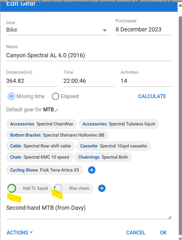

Add components to your gear and setup reminders for the components. I’m doing this for chain waxing and TLE liquid verification.

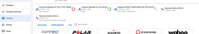

I’d like to track also the gear of my bike (tyres, chain, cassette, tubes, …) separately to know when is appropriate to change components, but I’d like to only mark the bike I used during a ride (it’s easier and faster).

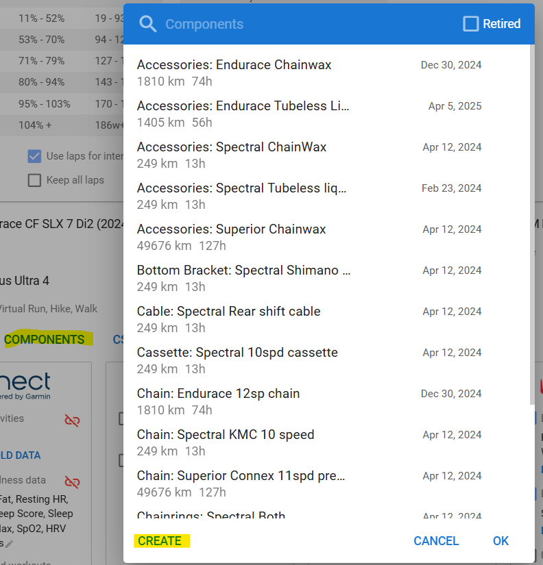

Is it possible to “create” a bike as sum of components and add mileage to each of them and change them separately in the future (when, for example, I change the tubes)
That’s how it works.

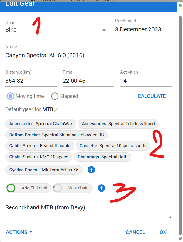

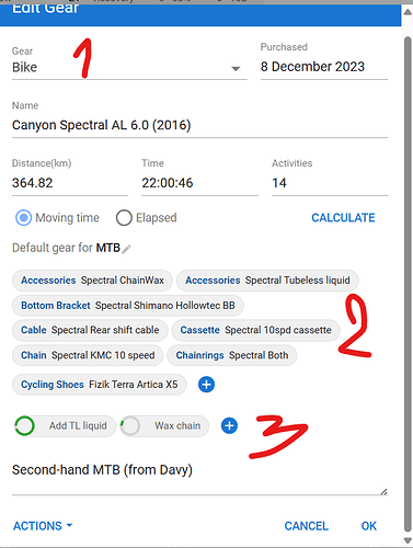

You create a gear (bike), number 1, and you create components (chain, wax, tubes,…), number 2, which you add to your gear. Then you set reminders for the components, number 3, that need regular maintenance or replacement. When you replace one of the components, you ‘retire’ it and create a new one.
When you do maintenance, you reset the reminder.
3 is a bike reminder. If you click the component, you can add a reminder for the component itself. :slight_smile:
