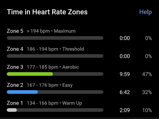

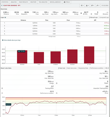

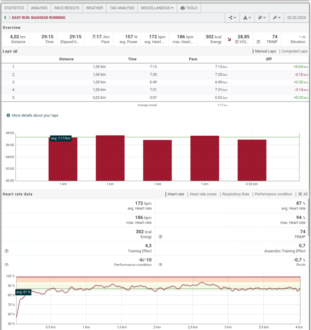

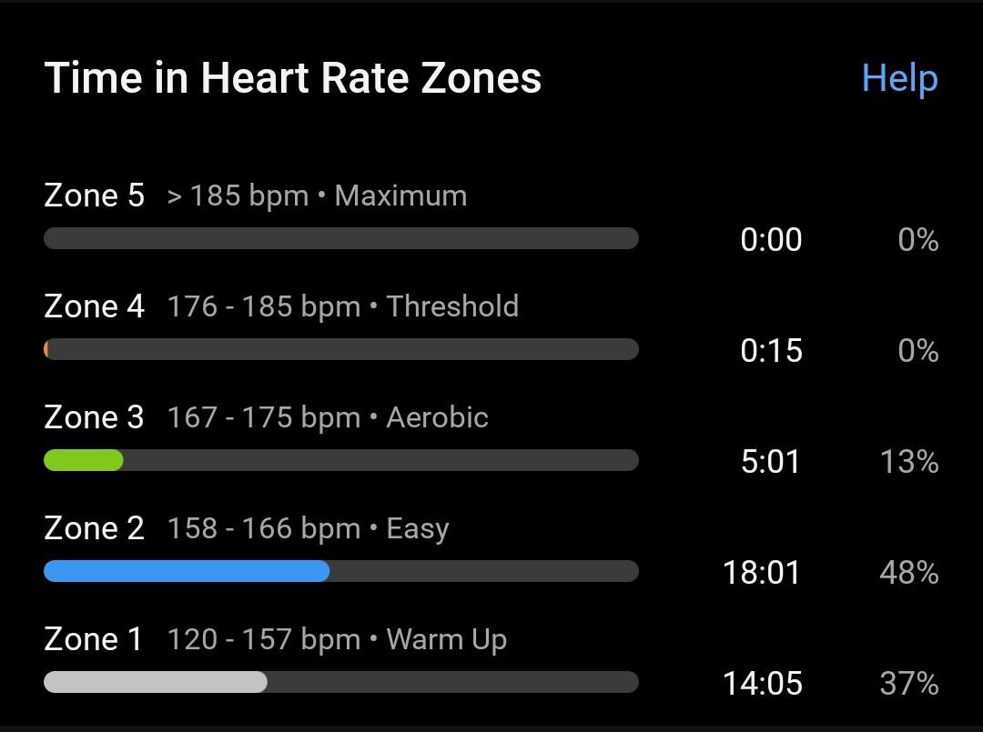

I ran for 20 minutes with a Forerunner 255 and a heart rate monitor (HRM-Pro). After finishing my run, I went to the charts and saw that the zones on Garmin were as follows:
Zone 3 (9:59 minutes, or 47%)
Zone 2 (6:42 minutes, or 32%)
Zone 1 (2:09 minutes, or 10%)

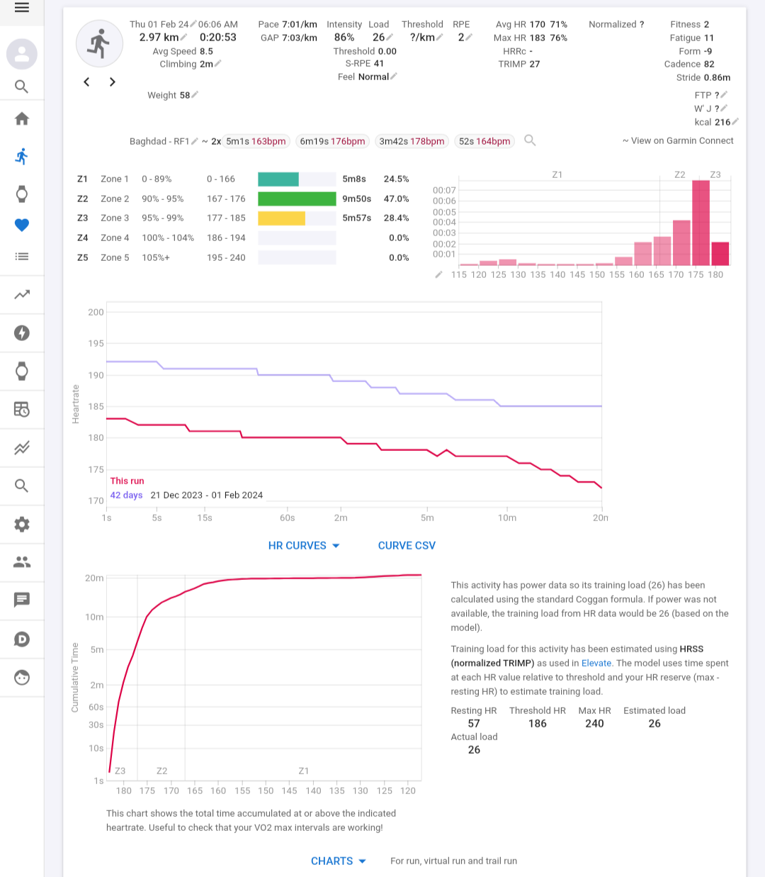

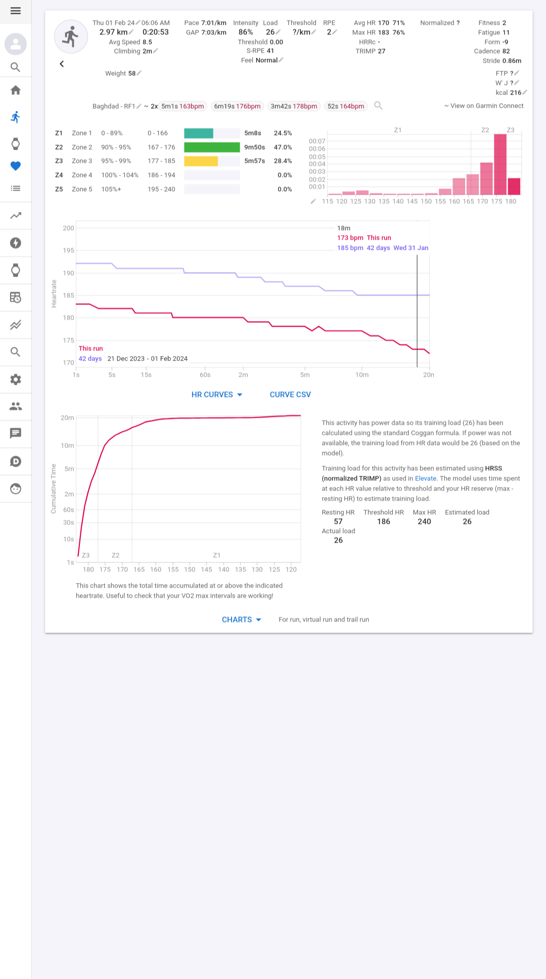

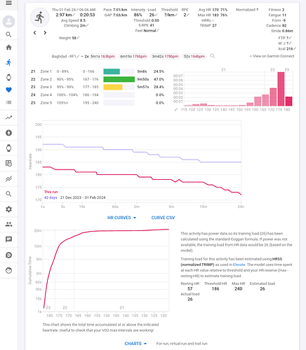

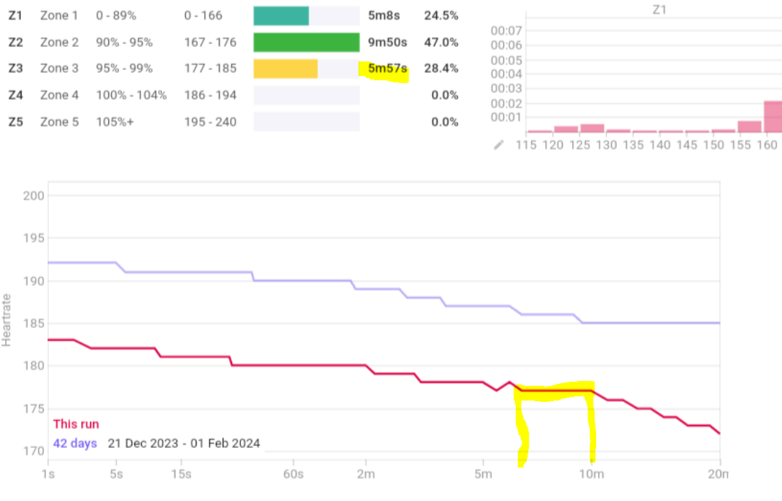

But for some reason, Intervals ICU seems to differ, even though I have the same ranges/exact BPMs for each zone. Here are the zones that Intervals ICU thinks I ran in:
Zone 3 (5:57 minutes, or 28.4%)
Zone 2 (9:50 minutes, or 47.0%)
Zone 1 (5:08 minutes, or 24.5%)
As you can see, it’s pretty different and quite inaccurate. Can somebody please tell me why it’s like this and how I can fix it?
Here are the photos for the zones on both Garmin Connect app and the intervals.icu
There“s a 2 min difference in total time in between both. That almost surely means that you have “Auto pause“ enabled on your Garmin.
Garmin and Intervals handle paused time differently.
So, does that mean I should just turn off auto-pause altogether to get accurate zones on both platforms? Sorry, I’m a new Garmin user; I just got the watch two days ago, so I’m still figuring things out.
I actually just checked it. It wasn’t even on when I ran :-/
I“ll have to correct myself. The 2 min difference probably lies in the fact that Garmin counts the lowest zone from 134 and intervals from 0.

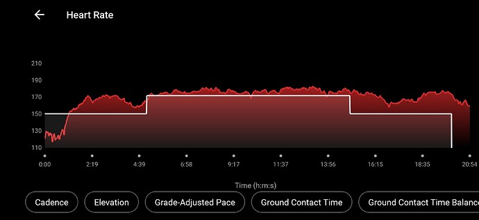

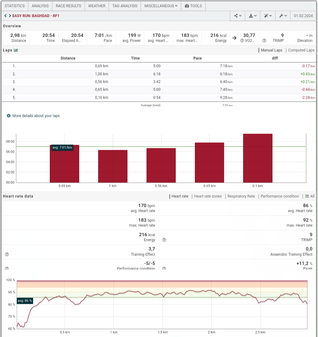

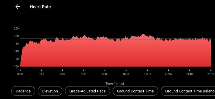

Can you show screenshot from the HR trace on both platforms?
And can you check if your watch has “Smart Recording“ turned off?
Intervals works best with second by second data.
The first thing I did when I got the watch was switch from data recording from ā€˜Smart’ recording to ā€˜Every Second.’ So, I guess that’s not it. I even ran now for half an hour, half asleep while double-checking every setting, and to be honest, nothing changed; it’s still different, and I didn’t even pause or anything.

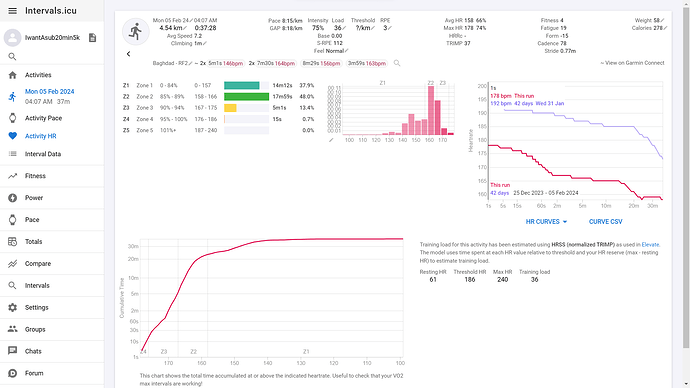

I’ll list the HR from the runs on all three platforms. I’ll also list the run from 5 minutes ago.

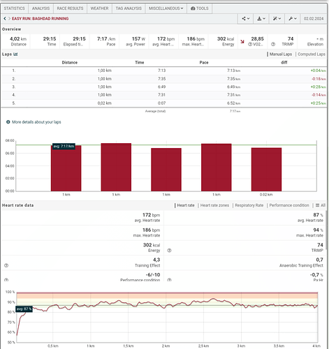

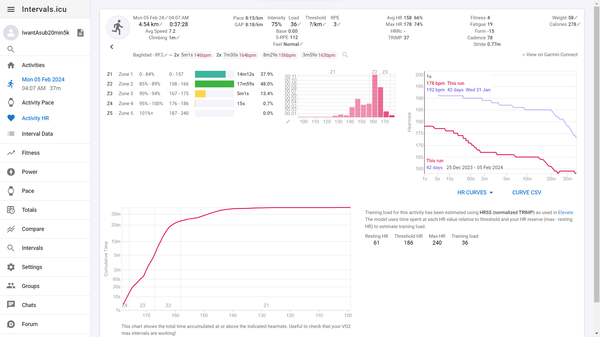

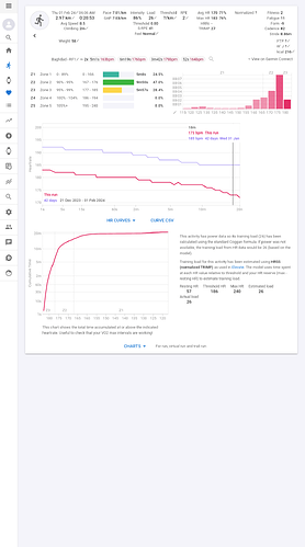

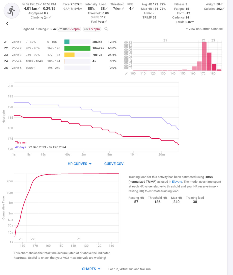

Here are the photos from the second run:

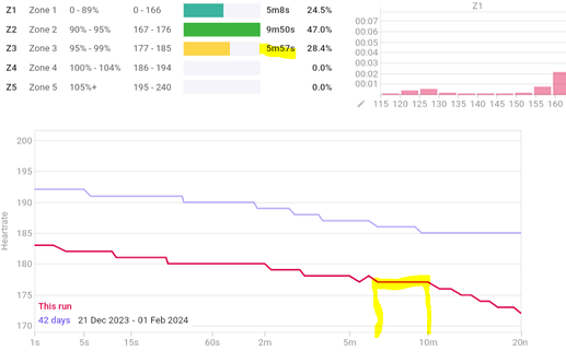

Pretty sure it’s a rounding issue in the Intervals zone settings.
From both runs, you can see that you spend quite a bit of time exactly at 176 - 177 bpm.
This one shows 5m57s above 177 while it actually is around 10m.

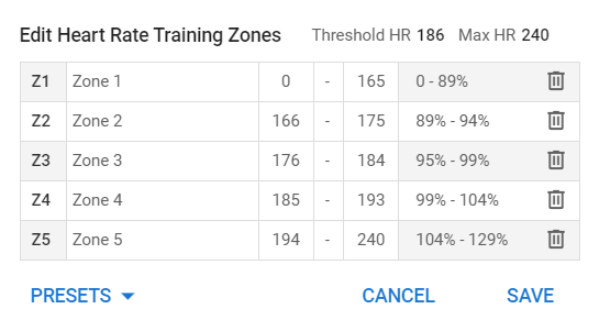

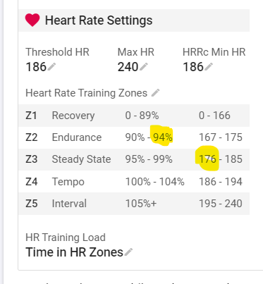

Did you use presets based on % for HR settings?
I’m not sure if it will make the difference but you could try to set the HR values themselves iso letting the % be calculated. The fact that the percentage could in the background be 177.5, might explain this peculiar situation. Once you changed the zones by typing in the actual numbers, go to the bottom of the activity chart and choose Actions - Update zones.
If that remains unchanged, set your lower zone limit 1 bpm lower, just to confirm my suspicion.

Garmin rounds the result of the percentages to a whole number, both for display and for calculations. While Intervals rounds only for display but uses the exact number with decimals for calculations. So a HR of 177 goes to Z3 in Garmin because the lower limit is exactly 177, but in Intervals the lower limit may be 177.2, meaning that it goes to Z2.

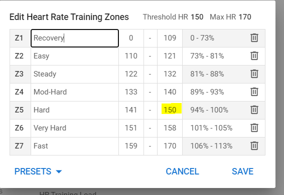

If you set them like this: (it’s just 1 bpm lower)
and end up with very similar result as Garmin, that would confirm that it’s just a rounding issue.
I tried updating the activities as you have suggested, but so far, nothing seems to work. I’ll try to go for two runs tomorrow: one where I’ll use Garmin for synchronizing, and the second run I’ll disconnect Garmin from this website, link it to Strava, and sync from Garmin to Strava and finally to here. Hopefully, that’ll work. I’ll let you know how it goes. Thanks for sticking around; you’re giving me hope in my new piece of junk watch :smiling_face_with_tear:

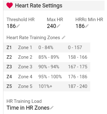

I also edited the zones exactly how you have mentioned. Still nothing
Sorry for taking too long to update; I had a busy couple of days. Anyways, after some fine-tuning and realizing that I could manually set my zones using BPMs instead of %LTHR, %HRR, or %HR Max, I can confidently agree with your conclusion about it being a rounding-up issue. Even though some of the zones are not pinpoint accurate (with minor variances of around 10 seconds or so), I’m still satisfied with it.
I’m glad I found this forum; it helped me realize how wrong I had configured my zones. They were so off to the point where my ā€˜zone 2’ was actually my zone 3, and my ā€˜zone 3’ was my zone 4. I’m very glad I have everything set up correctly now!
I just have one last question: Is it normal to have some zones be pinpoint accurate, as shown in the pictures below, while other zones (zone 2 and 1) are off by a few seconds? If there’s no way around it, then I’m fine with it, but if it’s possible to achieve 100% accuracy, please let me know. Thank you.
