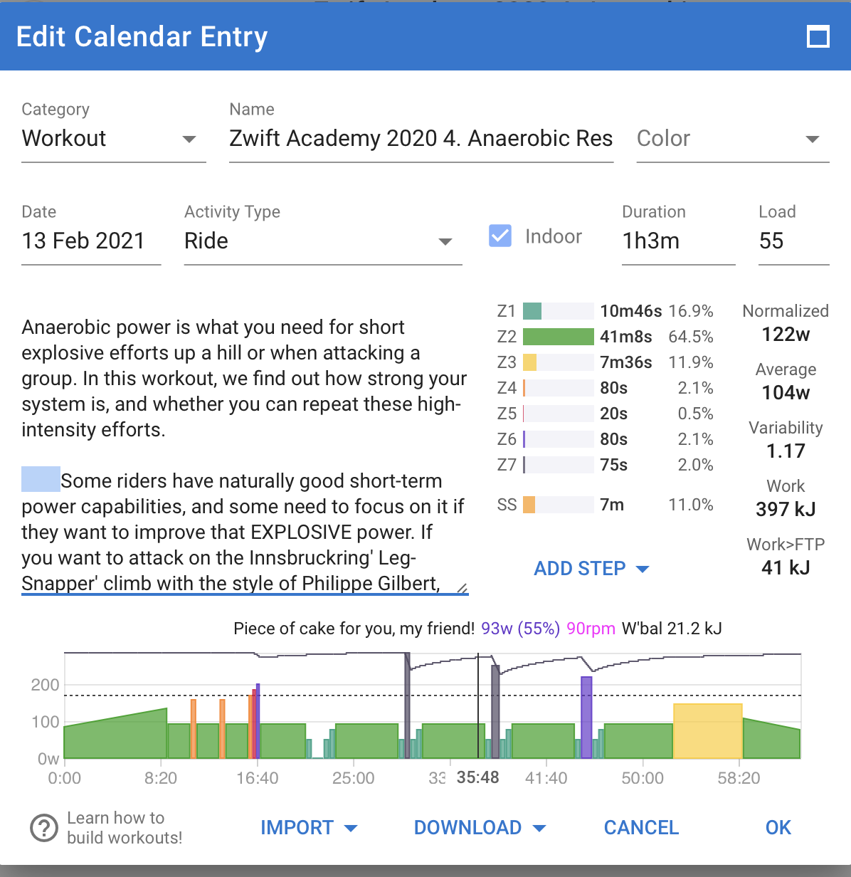

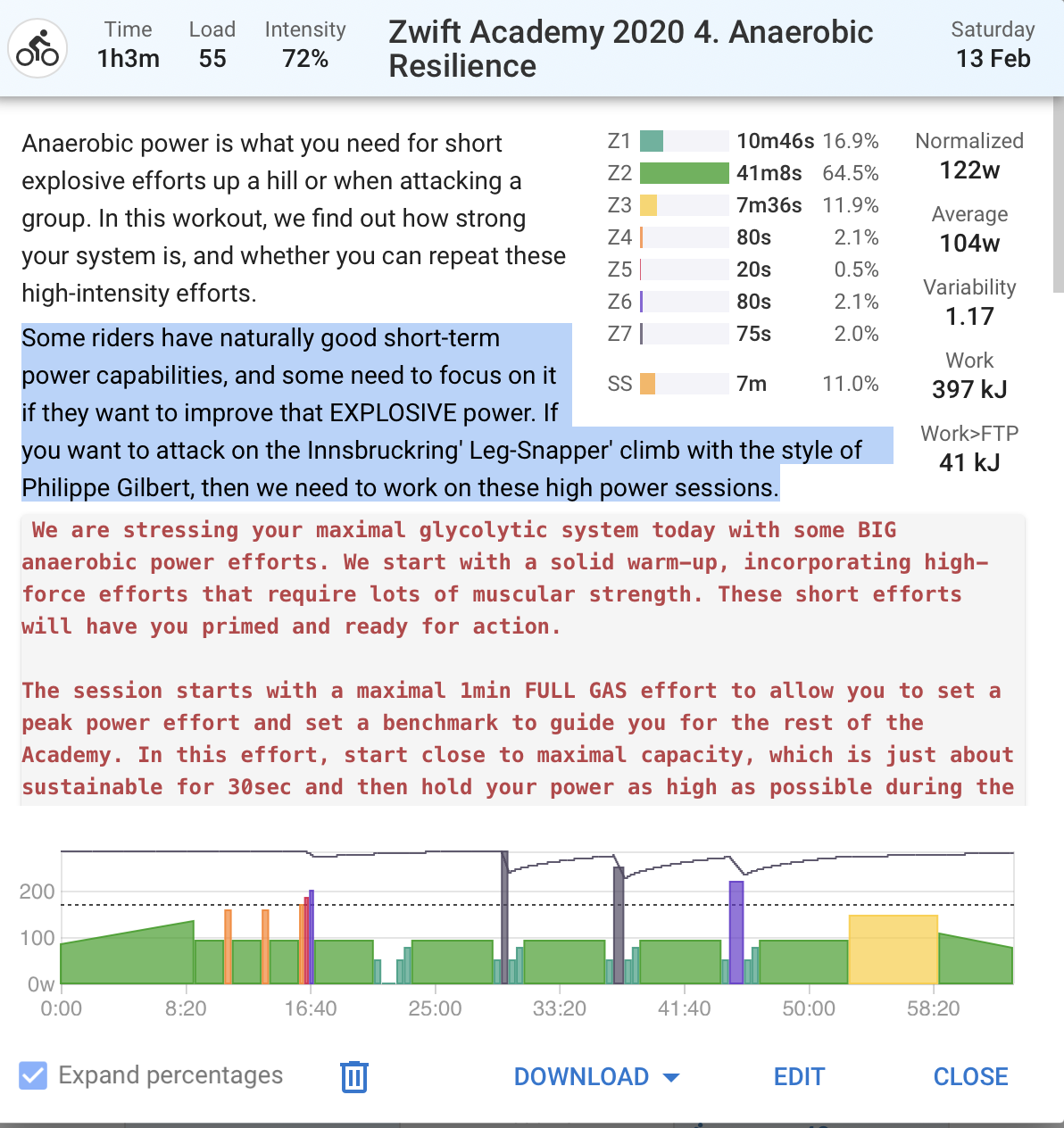

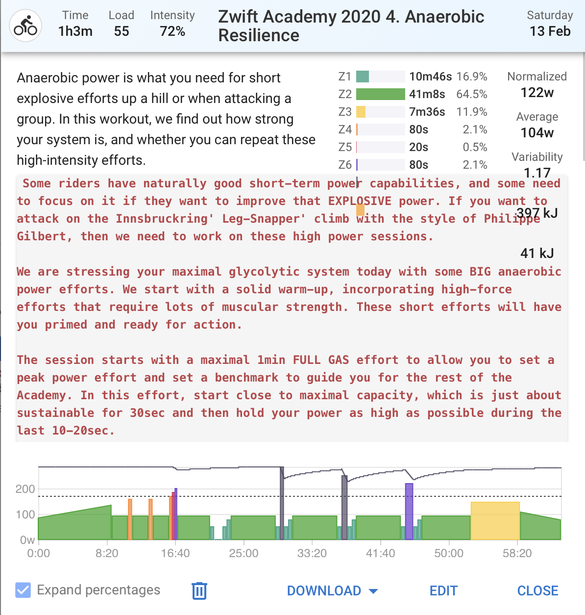

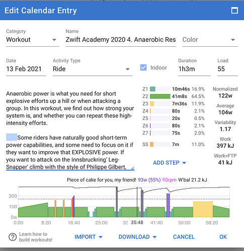

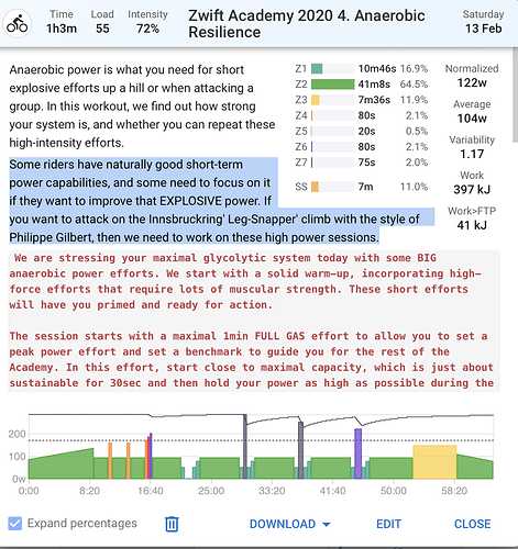

I’m importing some Zwift workouts in my calendar and when importing the Zwift Academy 2020 workouts the text in the workout is partly in red courier format. See pictures.
When I remove a 'tab" in the text marked blue then this part of the text is OK but the rest below still isn’t. When removing the other “tabs” in the text at the end it’s fine.

Tx for that. I have sorted this out and will deploy Monday AM (GMT+2). The description is actually markdown text and the tabs were making that stuff look like ‘code’, hence the red colour and font.
