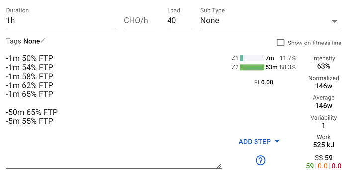

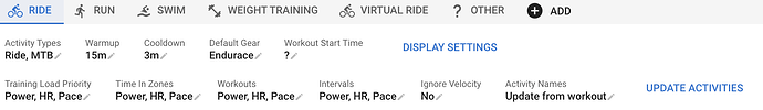

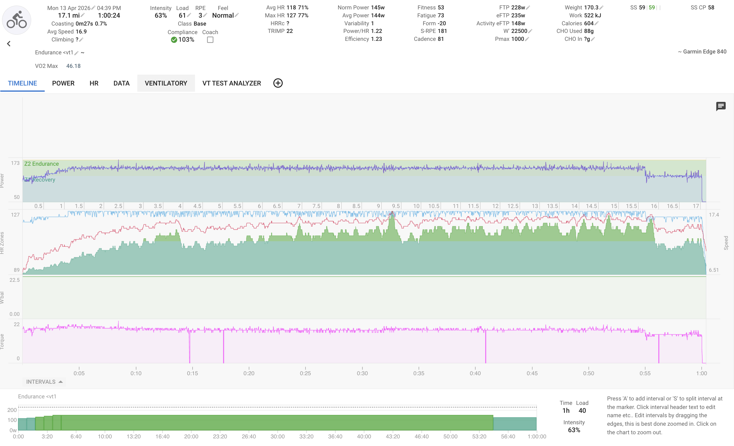

I must have messed something up in my settings because the load calc in my planned workouts is constantly meaningfully under the load calculated from an activity. Power, time and intensity all match and workouts are built around %FTP steps. This low Z2 workout reads as a load of 40 but when i execute it on the trainer on erg mode power and intensity match but it comes out as Load 60.
workout
settings
Can’t figure out what setting i’ve changed to cause this

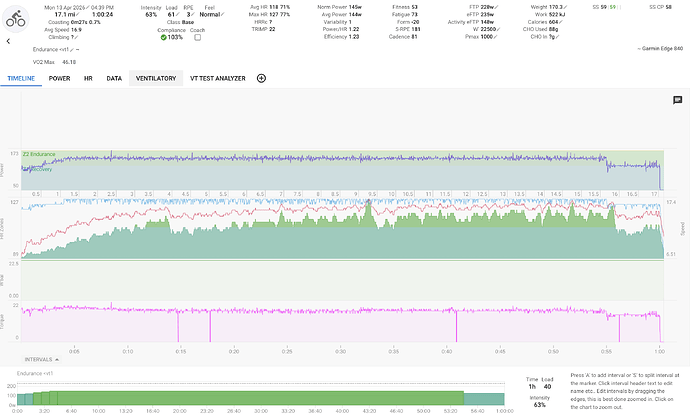

Show the activity.
An hour endurance pace is about 40 load, so that looks goods from my perspective
It seems your load is overwritten, maybe with a custom script?

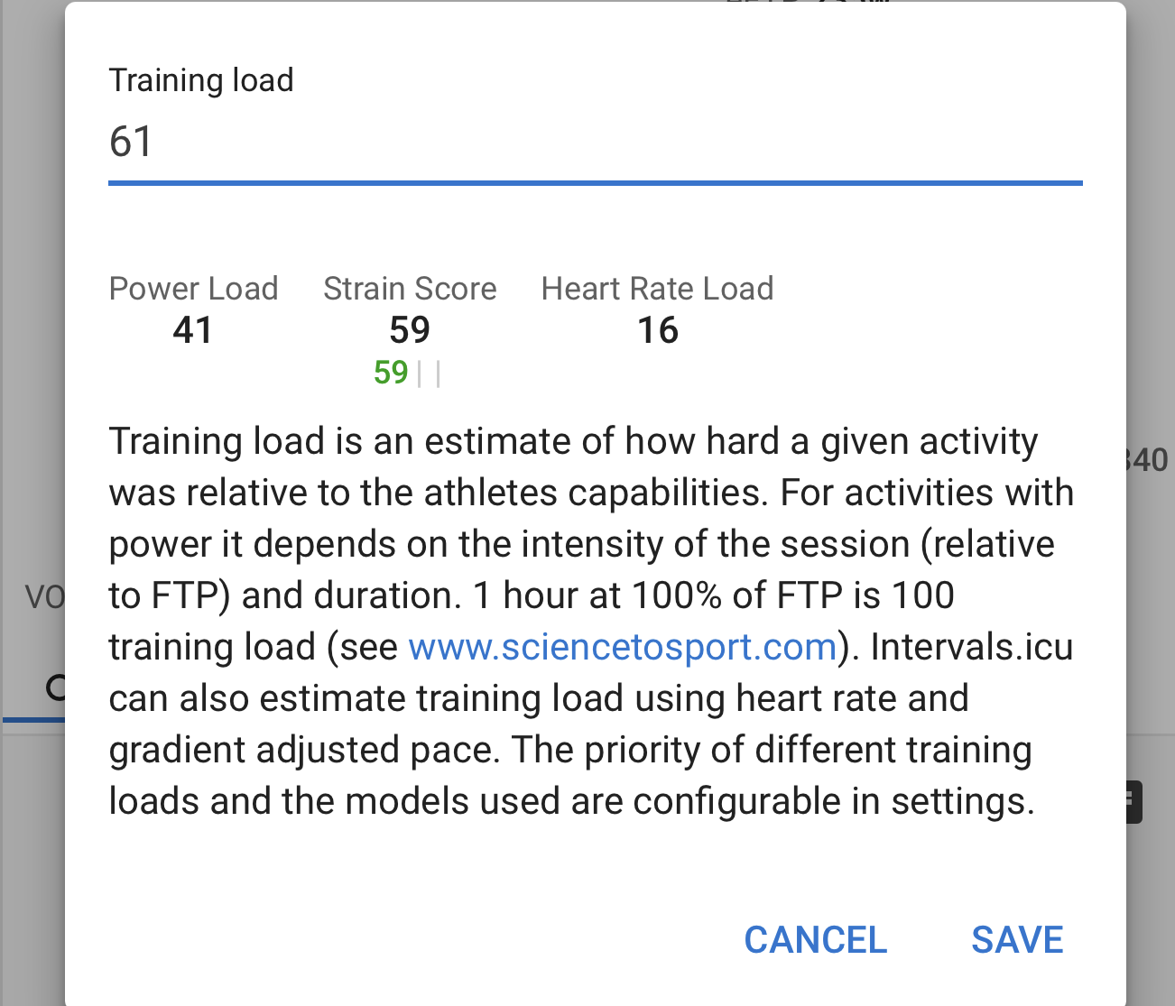

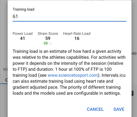

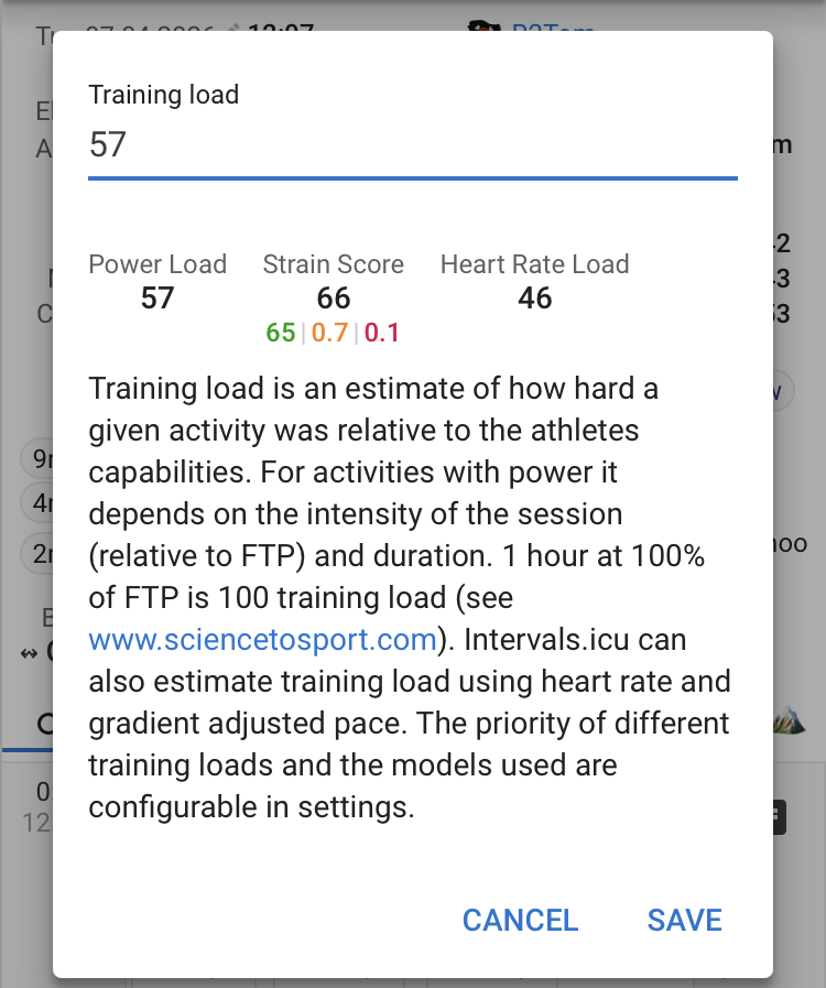

If you click on the load field, the following modal opens
There you see the original calculated value for power or hr
Yeah. Power based calc is as expected. Strain is close in this case not in others though.
Is there any setting that enables strain for load calculation?
