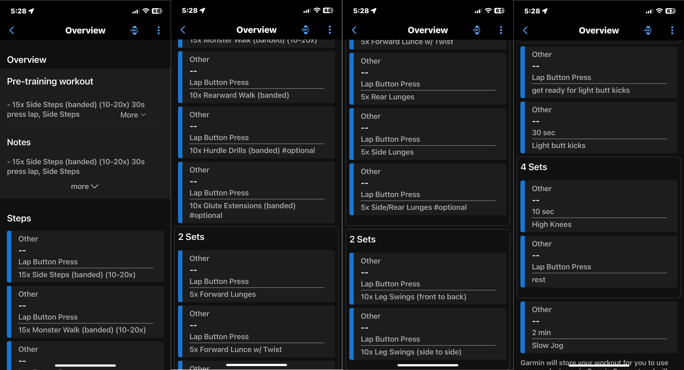

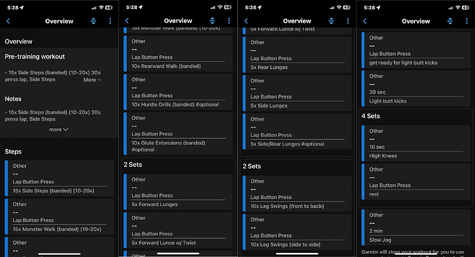

TSS / projected load aside, I spent a bit of time today (more than I’d like to be honest) figuring out how to write a rep-focused workout here so it’s interpreted by garmin in a useful way.
This is what I was able to come up with so some meaningful info is displayed in the Garmin Connect app, and on my watch itself as I do the activity. I think there may be a way to streamline things a bit when it comes to the process of writing non time/hr/power focused workouts, but for now, I’ll just share the fudging that got something working that didn’t drop info and wasn’t gibberish. This example pre-run activation “workout” includes a few different types of exercises for example-providing reasons.

This is how I translated it in Intervals.icu
- 15x Side Steps (banded) (10-20x) 30s press lap, Side Steps
- 15x Monster Walk (banded) (10-20x) 30s press lap, Monster Walk
- 10x Rearward Walk (banded) 30s press lap, Rearward Walk
- 10x Hurdle Drills (banded) #optional 30s press lap, Hurdle Drills
- 10x Glute Extensions (banded) #optional 30s press lap, Glute Extensions
Lunge matrix 2x
- 5x Forward Lunges 30s press lap
- 5x Forward Lunce w/ Twist 30s press lap
- 5x Rear Lunges 30s press lap
- 5x Side Lunges 30s press lap
- 5x Side/Rear Lunges #optional 30s press lap
Leg Swings 2x
- 10x Leg Swings (front to back) 20s press lap
- 10x Leg Swings (side to side) 20s press lap
Partial wake-up legs
- get ready for light butt kicks 1s press lap
- Light butt kicks 30s
High Knees 4x
- High Knees 10s
- rest 20s press lap
- Slow Jog 2m
Note the following
  • “Partial wake-up legs” doesn’t display but its contents/items do.
  • The first five items have a “note” written after comma which aren’t displayed
  • How I wrote “light butt kicks” and “high knees” to work was focused on usability.
The key was to include the reps and exercize description together for readability, specify any amount of time, and then include press lap at the end.
And this is what it looks like in the garmin connect app…
Based on the JSON that currently gets sent over to Garmin there doesn’t currently seem to be a way to specify a type other than “Other”, nor specify a rep count, or add additional text that gets displayed to the user.
After looking at the JSON Garmin sends to its own site and mobile app, there may not be much tweaking needed to support this workout type.
I hope this is useful to someone.
