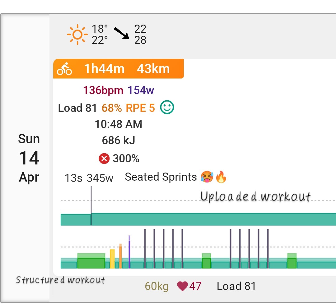

Workout problem
Intervals reads my data always as shown in the screen shot with no intervals as the structured workout
Even though on my computer i work as the intervals
Any solution?
Did you perform your workout on the same device that’s the source for Intervals?
I suspect this has something to do with laps being absent (or not used) in the uploaded workout.
If you for example perform the workout on your Garmin headunit but Intervals is showing the Zwift ride that you simultaneously recorded than the laps won’t be present.
You can always try to see if the laps are present by clicking “Actions → Use Laps” at the bottom of your recorded workout.
