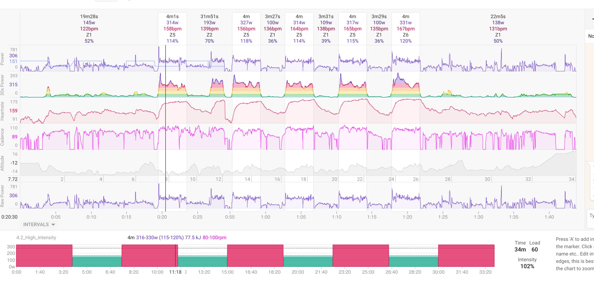

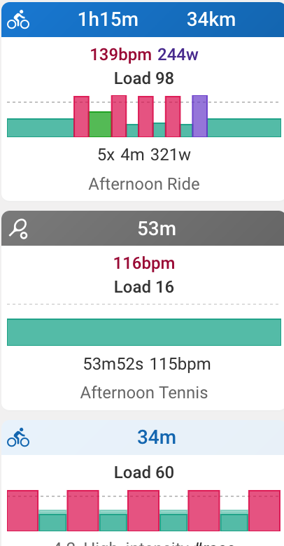

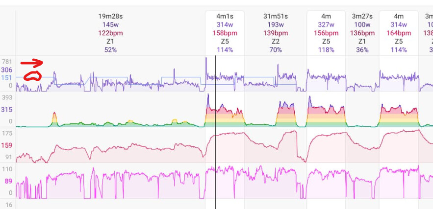

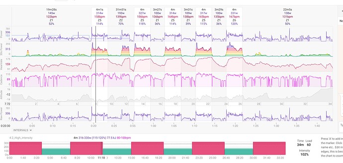

Bumping this thread for a question regarding a matched activity. I have compiled a little library of interval sessions but I usually ride a little before starting the planned workout which only has the intervals. When I drag and drop the planned interval session onto my actual session it looks a bit odd. Is there a way to fix this? Second screenshot hopefully conveys what I mean.
Edit: Got a puncture during my second interval…
Use the Workout slider in Options (bottom of activity page) to align your workout with the activity.
This one will not be completely aligned because of the pause in the second interval.
